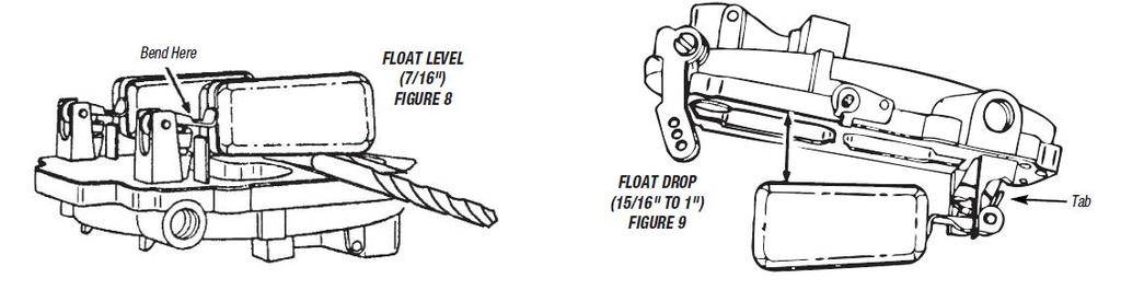

By the 'Tab' in the right image of this picture;
Sorry I didn't see it before but I did so closed 7/16 open 1 inch. I'll see what happened and that's to everyone for taking the time ;)

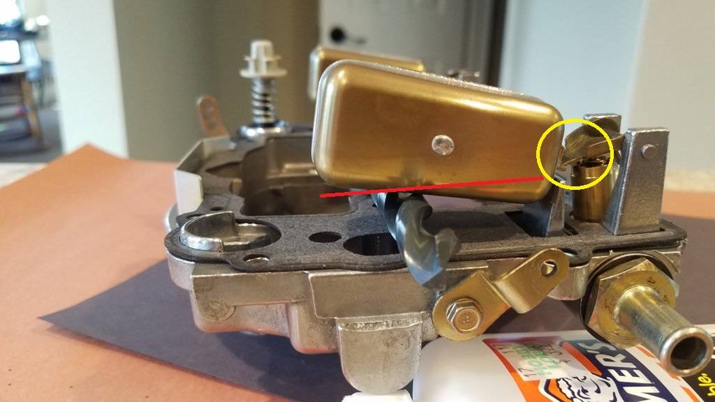

I keep looking at the float and I think it just doesn't look right.
IMHO, the float should be more parallel with the top of the carb. Red line on the drawing.
I also think that the float bracket is bent incorrectly at too sharp an angle. Yellow circle.
Perhaps I'm all wet on this... Maybe someone else can chime in, but I think it should be more like this. I would check the needle and seat to be sure there's no issue there that would allow the needle to go further into the seat.... or if it's the correct needle and seat for that matter.

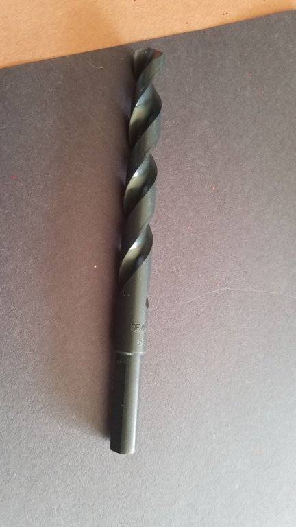

The reason I did it the way in the photo was that the other side of the drill bit was smaller than the drilling side. Either way I put it all back together and it still didn't solve the problem. I even took all the jets primary and secondary out and boilded them and cleaned out the carb as well.
In your photo that you circled and placed a line is this the point you're referring to as where the 7/16 bit should go? You also said needle and seat? When I took it apart all I saw was accelerator pump and in the metering rods with Springs I feel like an idiot but I'm not sure where the needle that you're referring to would be located. I've never got into carburetors and I'm now trying so please educate thank you
