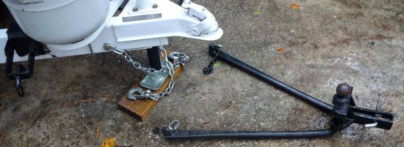

I think the equalizer I'm using is a good one, but is not height adjustable at the hitch. I'm going to focus on the springs I think.

Personally I would upgrade my hitch, to an adjustable weight distributing hitch, With my truck and trailer, soon as I drop the trailer on the truck it goes from having a rake to level, and any weight on the trailer flattens it down further. I had a old weigh distributing hitch and found an article on how to tune it, I followed the article and even with weight on the trailer, the truck sits level now, mind you I'm using the largest spring bars I could find (1,000 lbs each), the set up originally was for a '78 D100 to pull a 24ft prowler tandem axle travel trailer (5,500lbs GTW), so I figure my car trailer (1,000lbs with ramps, plus a car, say 4,000lbs, plus say some tools/etc in the truck, 500 lbs, 5,500lbs is realistic) weighs roughly the same loaded, and my trucks towing capacity and wheelbase are roughly the same as its original intended set up.
Just my 2 cents, I was ready to add leafs to my truck prior to trying the hitch and then learning to "Tune" it.

I've been through the "tune" procedure with the equalizer bars. A adjustable hitch would allow me to raise the ball height but that's like applying a band aid. The trailer will gain height but the car will still suffer tail drag.

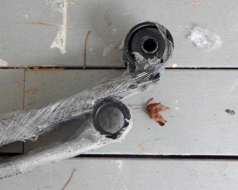

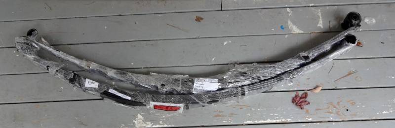

I received my new leaf springs. They look good. No grooved leafs so that will add strength and the 7th leaf is a little longer then OEM so they should do what I need them to do.
I was concerned about the rear bushing "eye" being larger then my original but the guy at St Louis spring said he had bushings that will adapt and is sending them, no extra charge. (He may be covering himself for sending the wrong spring), but if they work, I'm happy.

I asked ESPO for "stock height (sorry, Ross) heavy duty" . They said it would be six leaf.

I received the bushings today. Will install as soon as I get the A/C finished.

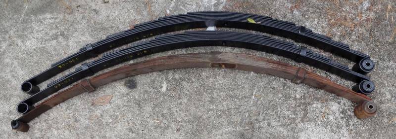

The new springs are really close to the originals. The 7th leaf, (shortest one). Is a little longer then the original. Plus the rear shackle bushing is a larger diameter. That should improve ride quality some.
