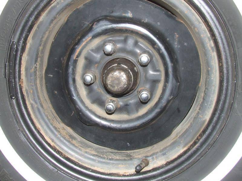

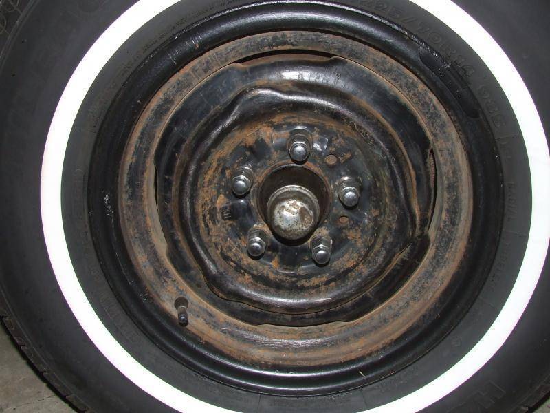

I'm a wheel cover kind of guy. Make sure those charger covers fit right though. Early 66 and older wheels have more positive offset and those covers will not fit. Later wheels have less positive offset and are deeper on the front side.
DSCF5472.jpgThis is a pre 66 wheel. Notice the center disc is nearer the front edge of the wheel.
DSCF5474.jpgThis is a 66 > wheel. Notice the disc is attached to the wheel portion farther back, making the front deeper.

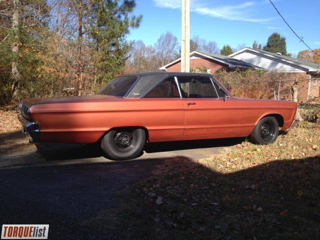

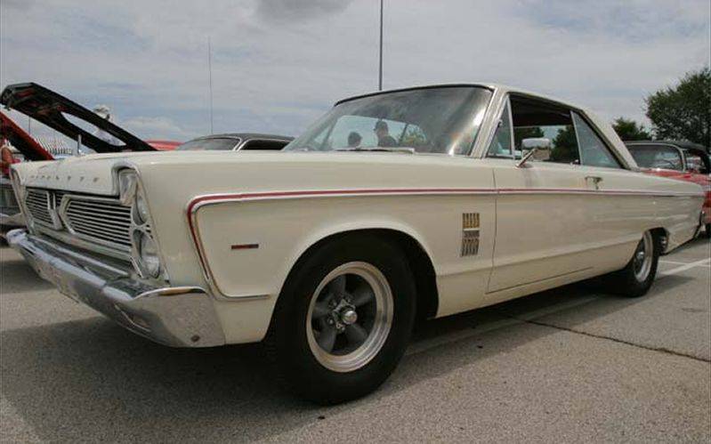

Here are two low cost options that I like. Top being my first choice.
