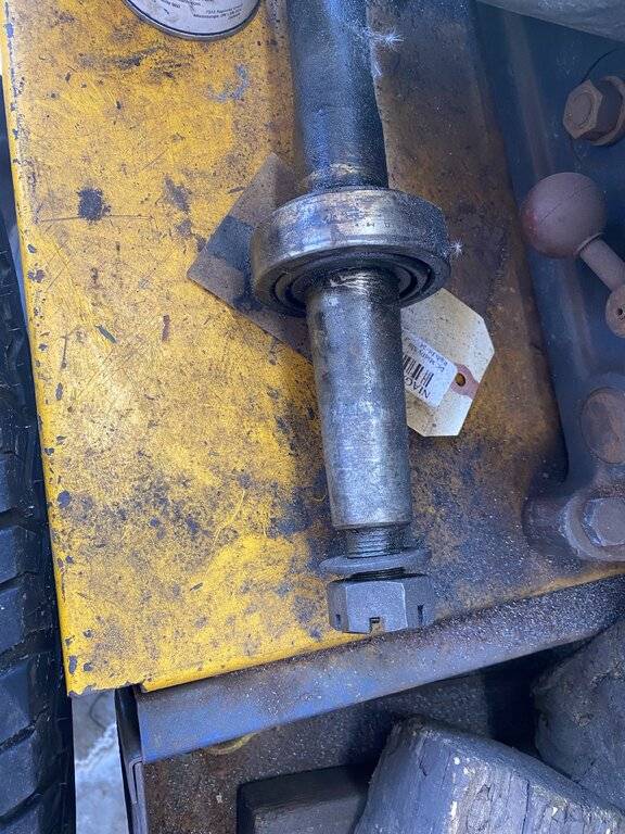

    Right now i am stuck with the car at one shop, pumpkin at another. Trying to manage finding the right parts as the first set ‘didn’t fit’. I believe I ordered parts for a Dana 60 and I am thinking from my reading at forwardlook that I may have a tapered axle and would need a different kit.
    Is this a tapered axle?

    Yes it is. The nut on the end is the giveaway.

    They did not use Dana 60's in Mopars of that vintage. If all else fails, the bearings have Timkin numbers so you can order them from any good bearing supplier. Seals have direct National equivalents. You might have to make the shim sets to take up the bearing slack for the axles, most of the time the bearing tolerances were close enough to reuse the same shim packs. Do not, whatever you do, put Chicom bearings in the rear end or on the axles, those bearings are poor quality and too soft for a heavy car like a 60 Plymouth. Most of the time if there is excessive gear lash on the rear end it is because either the bearings or the ring and pinion are excessively worn. In that case you will need at least new bearings, if not both, as changing the gear lash on a used ring and pinion also changes the wear pattern on the gears. It is also very important to check the torque on the lock nut at the end of each axle. The key way on the tapered axles was famous for breaking out if they were improperly torqued. (145 ft lbs min)
