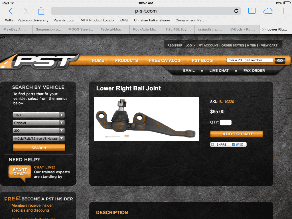

Are the Dodge lower ball joints different from the Chrysler? I picked up mine from PST for $65 each about three years ago, unless they stopped selling them. Every time I look at the Rare Parts site, I shake my head and move on.
No, no difference Dodge/Chrysler/Plymouth C Body 65-73 Drum Brakes & 70-73 Disc Brake cars.
I have no experience with PST or Rare Parts products. All I know is that the old stock MOOG, TRW and other brands were made better than Chrysler's lower ball joints, at least the NOS ones that I have come across and sold because the Moog ones are better. Just my 2 cents.
Crap! There they are again! I'm 99% sure those are the exact same lowers "rare" parts sells for way more. I just looked at my file, paid 290.00$ Canadian last summer for the two. Damnit! Glad you got your part ALLAN.
I to am unsure of the quality of the PST lowers, I do have a set in my 68 T/C wagon with the 73 disc brake conversion I did, probably have about 10-15K miles on them and car has driven well over the years. I do have a set of the old stock Moog K-7003/5 lowers squired away, will most likely swap them in if those PST lowers ever go south. ;)

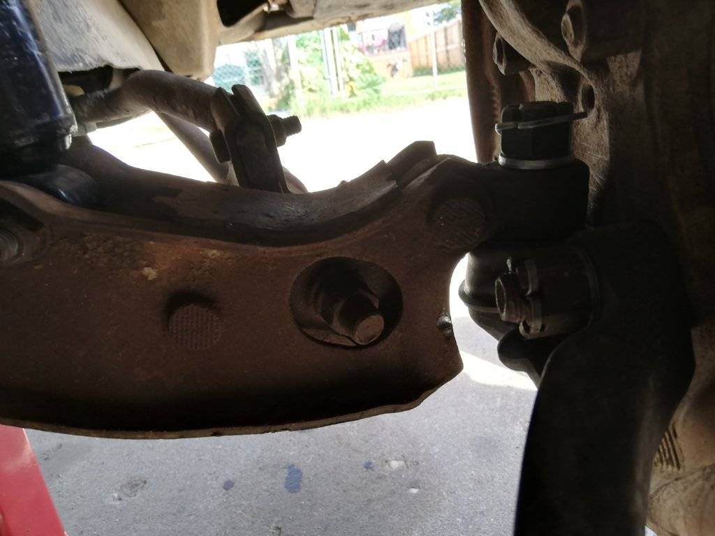

I have my front end pulled apart to blast everything, and was just going to replace my LBJ dust boots.
I didn't notice any play in the joints, until all the grease was cleaned out. Now I'm guessing they can be pulled in and out about .125.
Is there a good way to check LBJ play on the bench?
I was going to put them in a vice, and rig up a dial indicator to check vertical play, or in and out of the socket.
Would the .080 number be the limit to be looking for?
Checking the 2 from my 65, and the 2 on the disc brake swap sitting there, they all seem to have similar clearance in and out.
