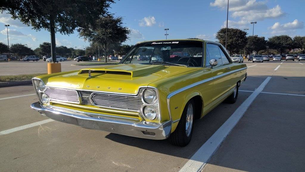

The time has come and building is getting ready to start, I wanted to voice the plans too see if anyone recommends something else other than what im thinking or to give ideas on power, torque, and maybe similar build 1/4 times. The Car: 66 Plymouth Fury 3, 2 door, safe weight guess 4000 ish pounds, The Motor: 440 block bored .40 over, 507 stroker kit, CNC machined heads, Comp Cam XE285HL, Edelbrock Performer Intake, Holley Dominator 950-1150 (unsure on size just yet), TTi Headers down to 3 inch exhaust backed by flow master mufflers. The Trans: Built 727 Torque flight, 3500 RPM Stall, The Rear: will be on fully adjustable coil over shocks, factory leaf spring setup, 3:91's in the 8-3/4 Sure grip, The Tires: 275/XX/15's on the back, BFG Radial T/A's for now until I can find a slick for the track, and the fronts are smaller of course but I dont know the size of the top of my head. Feel free to speak your mind, negative or positive, or any recommended changes I should add to my plans! Thanks

The car will never be sold EVER, it was purchased new by the family, with that being said I have the original numbers matching 383 big block and 727 trans and the original build sheet, I have looked at the cost and im perfectly fine with it, the hood will be paint matched and wont be gawky, the gauges are hidden under dash as are the switches for the fans, water pump, and electric fuel pump. unless you talk to me about the motor the car will retain almost all of its Stock look, the car already had a street bruiser 440 in it until I dropped a valve

Gorgeous car!!!
