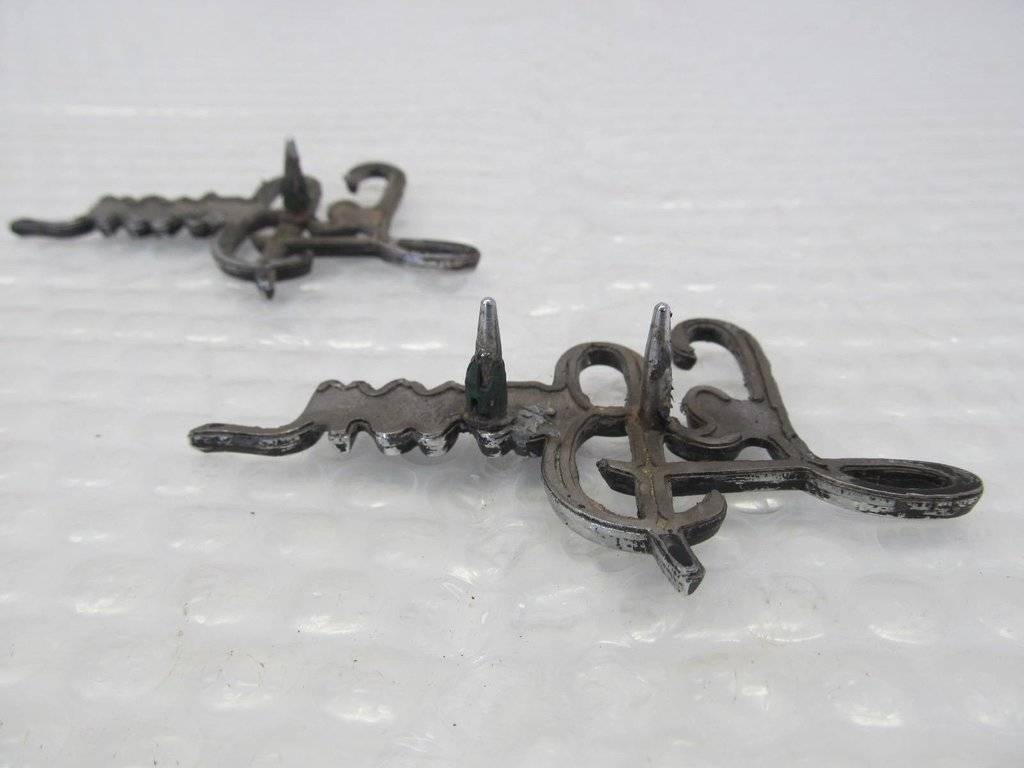

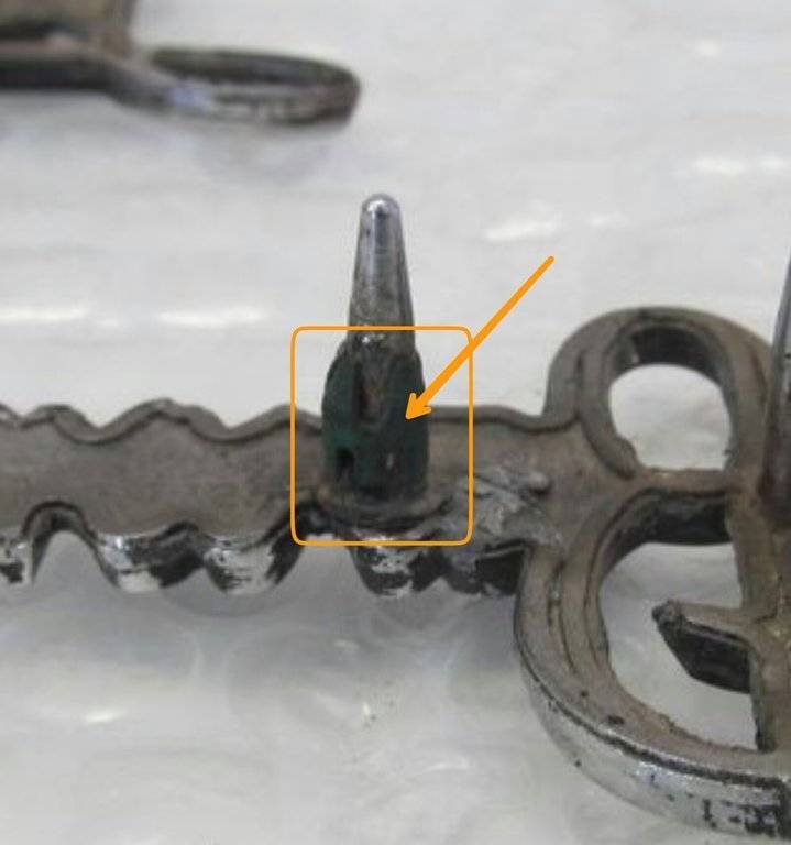

The sleeve shown press fits into the hole and the emblem is pressed into it.
You can remove the emblem by prying it off VERY CAREFULLY.
Replacement sleeves are available.

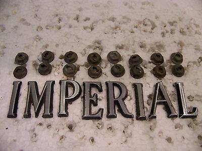

I purchased a set for the "Chrysler" letters for rear finish panel on my Newport. let me see if I can find the site. (IIRC, it was fee-bay)
here ya go, Doc...im assuming the size of the spikes on yours are the same diameter as mine. I also put a link to my thread where I restored my tail panel.
Chrysler Emblem & Trim Retainers 62 & Up A/B/C/E Body (25 Pk) #12 | eBay
Tail Panel and Assorted Trim

Not sure if it is the same, but the C pillar Chrysler emblem on the '70 300 and the '73 New Yorker are fastened by nuts only accessible from under the rear sail panels. I thought they were barrel clips as well until I busted one of the pins trying to pry it off with a flat blade.
