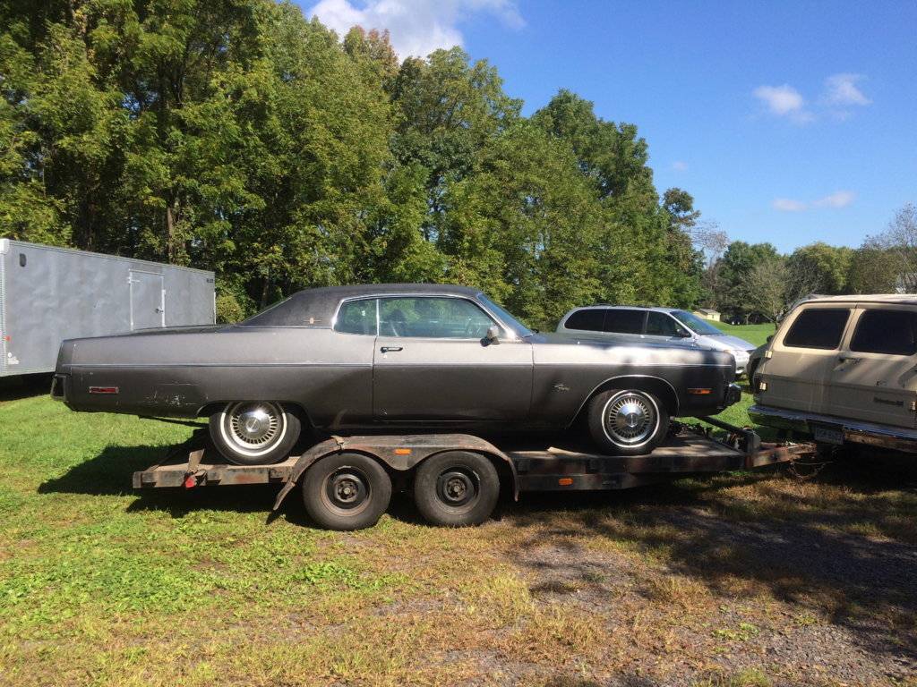

If anyone is wondering where this went to....
Last week it crossed the river to PA.

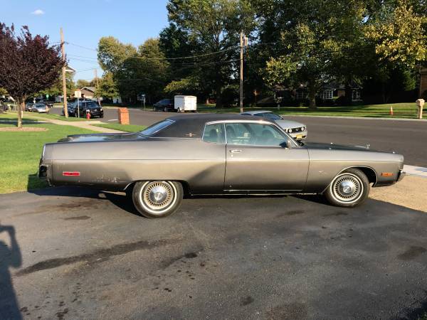

So, How's that silver Gran Coupe from Jersey?
In some ways, much better than I had expected, but there's plenty of ugly too. While viewing the Craigslist add, I noticed that all the lower trim was missing, therefore, I expected everything on the bottom of the car would be totally roached: Quarters, rockers, fenders and subframe. The thought came to mind to pick it up cheap just for the beautiful bucket seat interior. As it turned out, a friend of mine in England was also interested in it and had already talked to the seller. He was informed that the lower trim was missing because it was lost, and chances are that the body shop that worked on the car broke all the clips. Most of the "nails" for the clips were still in place. That info changed my opinion quickly, so a friend and I drove over to check it out. It turned out to be a bit too rough to spend the money exporting it to England, so my UK friend decided to pass. After thinking it over for a few days, I decided that it would be a great car for taking to our local car club events. I had been alternating between my '69 Imperial and '70 Newport, but my once perfect dashes now start melting anytime either of the cars is out in the warm sun. The ever increasing number of A-hole drivers prevents me from enjoying driving some of my better cars, so this beat up Gran Coupe should fit the bill nicely. It looks good from a distance, but there's not a straight panel on it. With the nice interior and full compliment of power options, I'll be cruising in style, oblivious to all the exterior flaws that I can't see from the driver seat.
As had been mentioned earlier, the car was up for sale twice this year on Craigslist. First by a realtor who got it from the estate of the previous owner, and second from a Mopar guy who bought it from the realtor. The guy I got it from was knee-deep into a full resto of a '68 Town & Country, and decided to part with the Gran Coupe to raise some cash for the T&C project. The gent who passed away at least tried to spruce up the car, but chose the wrong people to do it, though that choice was probably dictated by a limited budget. The body work on the car has MAACO written all over it: piss-poor welds, lumpy body work, almost no paint prep, and a desert-dry semi-matte finish on the paint. The car is also completely covered with clear overspray from another paint job done nearby. They actually managed to more-or-less install a used lower quarter on the right side. Thankfully, they didn't try a full quarter. The body was peppered with minor dents prior to it's trip to the body shop, and it didn't take the owner long to add another 3 or 4 scrapes to it after the work was done. The car has some electrical gremlins that will probably turn out to be bad grounds, and as expected, the power windows are due for a clean and lube. There's actually a little spark of life from the power locks, which is unusual. I did a check on safety items, and it needs brake work and lower ball joints.

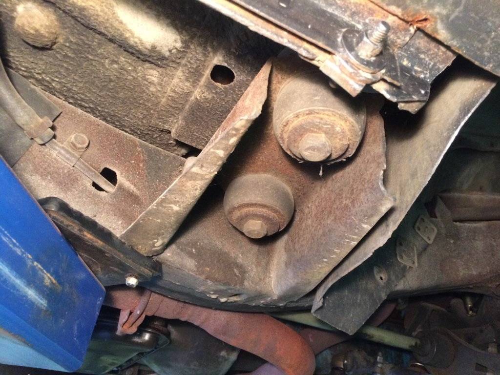

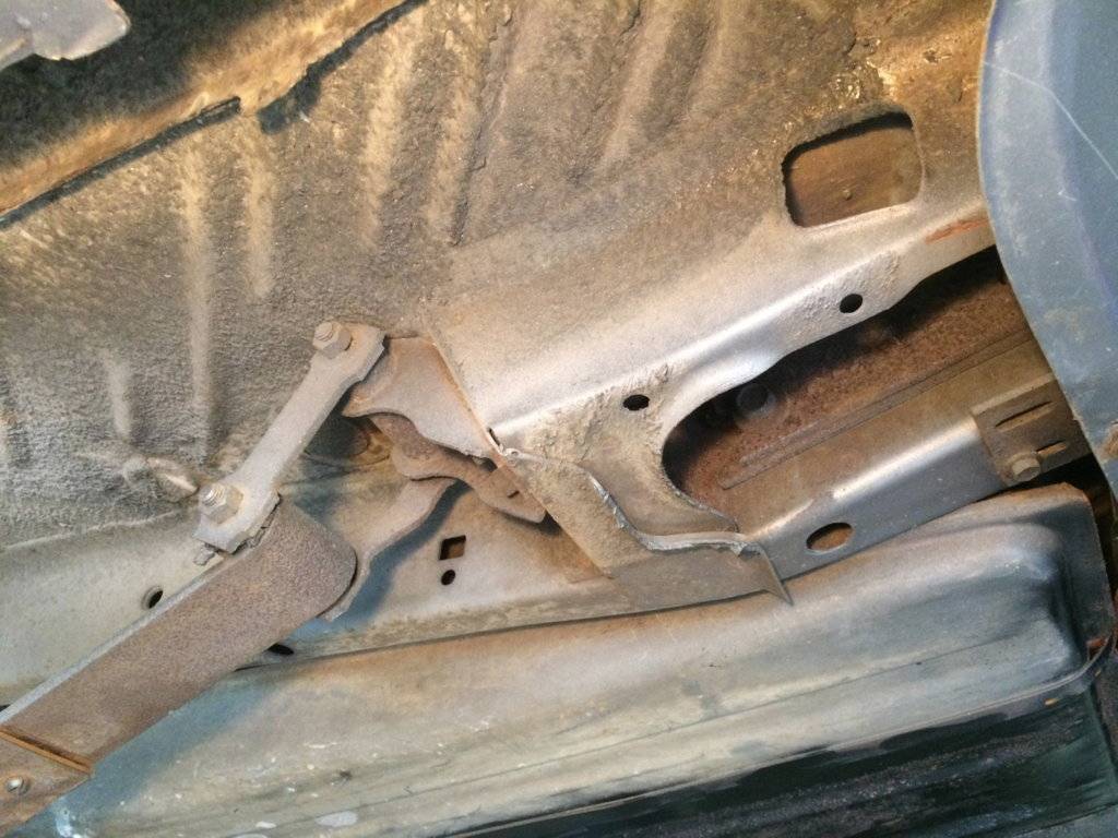

The underside of the car is clean, clean, clean. Check that subframe. ( I know it's STUBframe, but that makes me think of missing limbs for some reason)

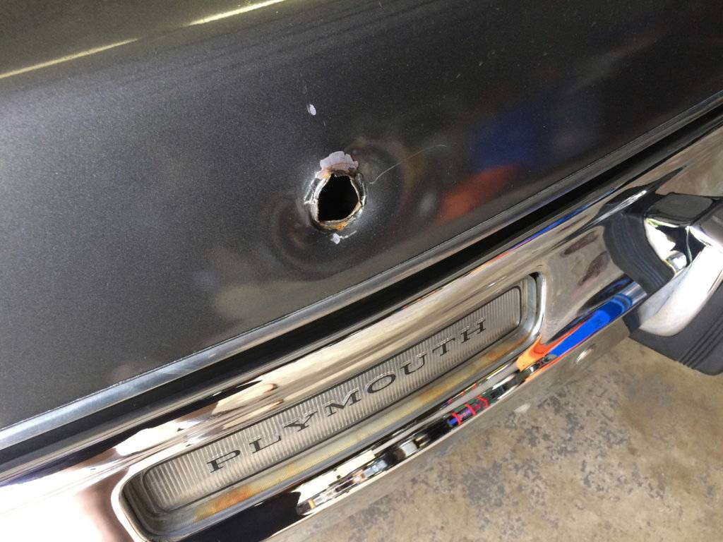

One more bad thing:
This was not necessary. :mad: Told it was done by dumb-*** realtor. Could have checked glove box for trunk release, or could have at least called a locksmith.

So it sounds like on the silver one that the poor body work was mostly the result of an elderly person that didn't drive very well and mangled most of the panels rather than the usual rust. Seeing an underside that clean from New Jersey is surprising - he must have driven it sparingly when there was bad weather.
When I first looked at the car it was dusk, and combined with the paint overspray, I didn't even notice some of the good stuff until after I had the car home.

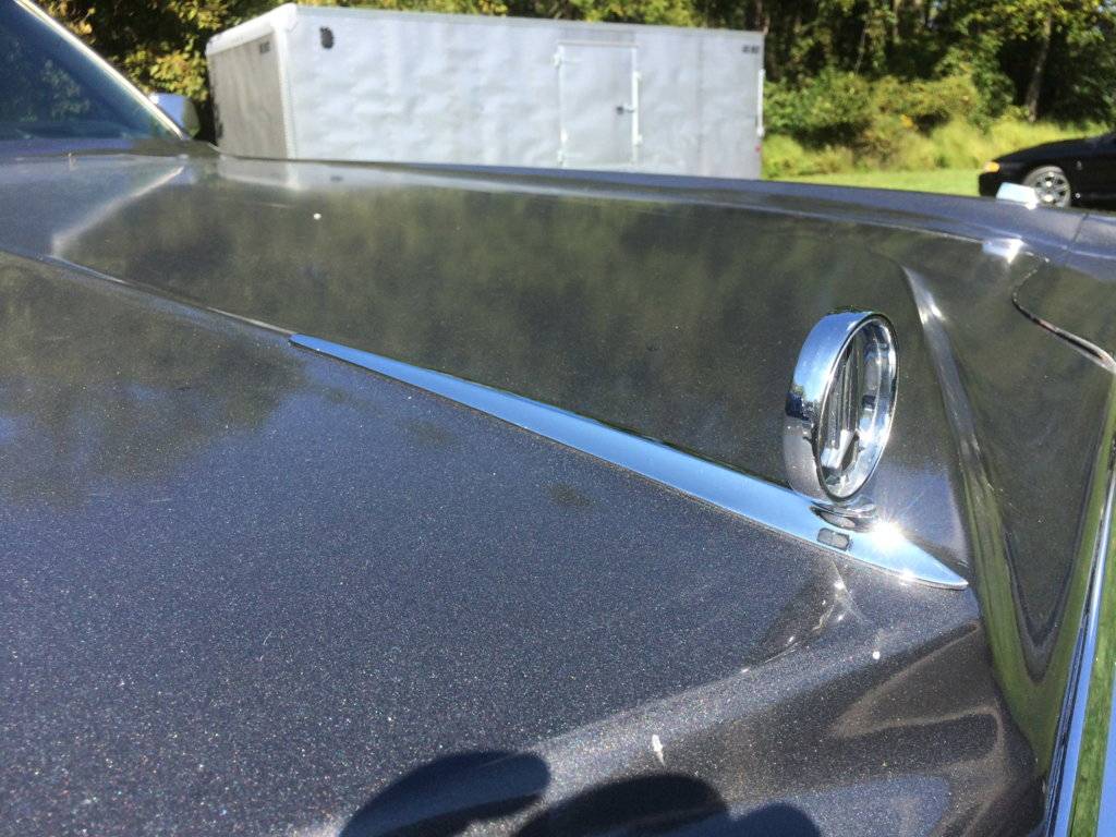

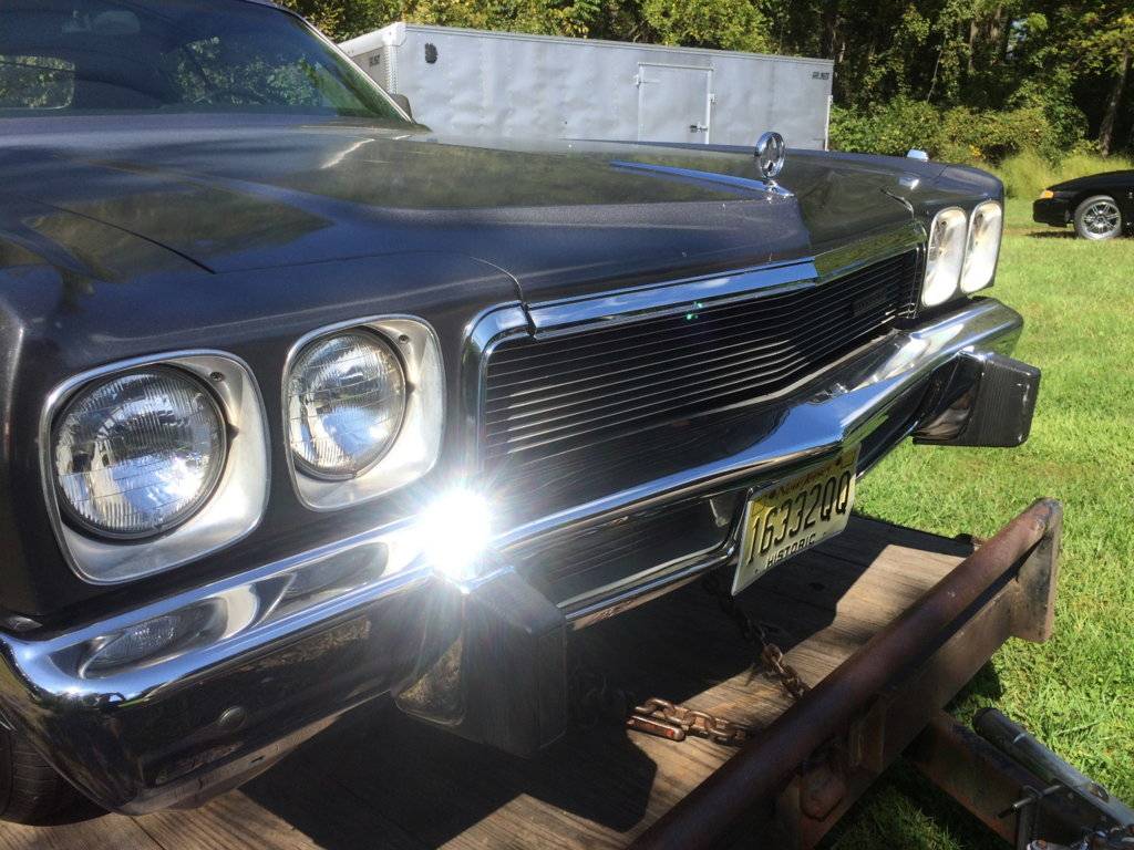

Front bumper, along with the metal part of the guards, grill surround trim, and hood ornament are all NOS items. :D

I have the car stored away in the car barn for the winter and should be able to have it ready for next spring's events. I'll be able to make pretty quick work of the mechanical stuff to make it safe to drive, and I expect the electrical bugs to be fairly minor.

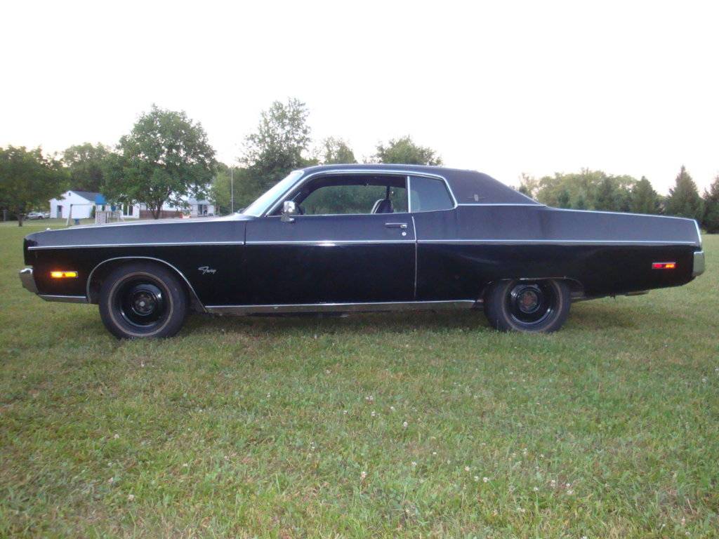

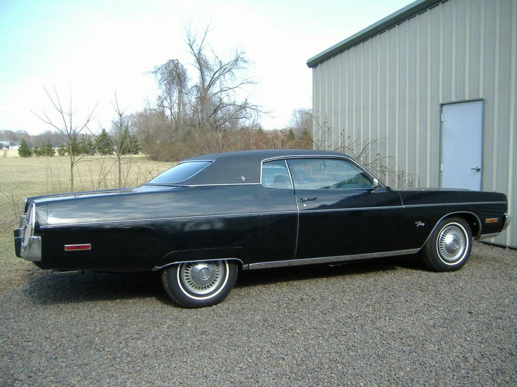

How about that black Gran Coupe?.....It looks pretty Sweeeeet!
No signs of abuse on that one!

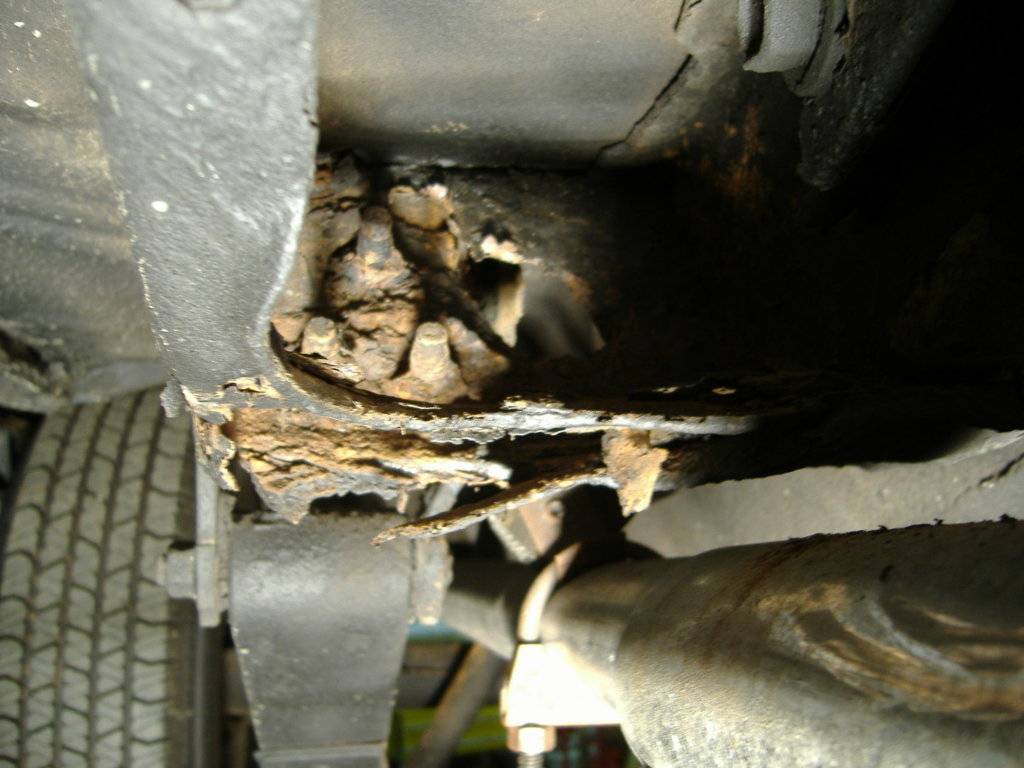

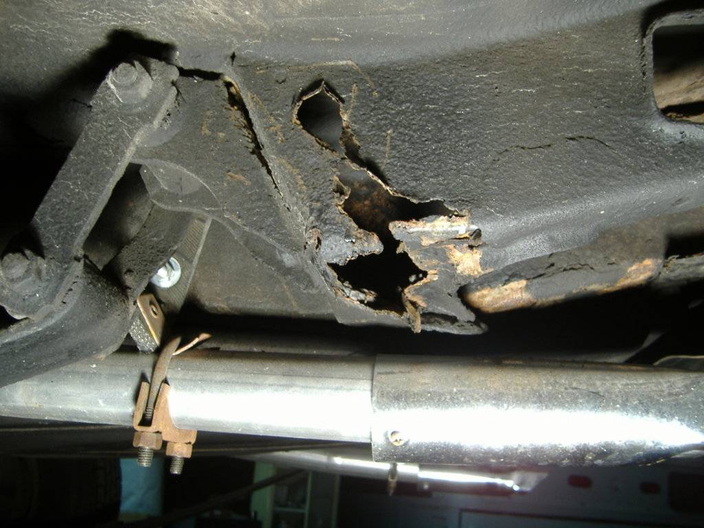

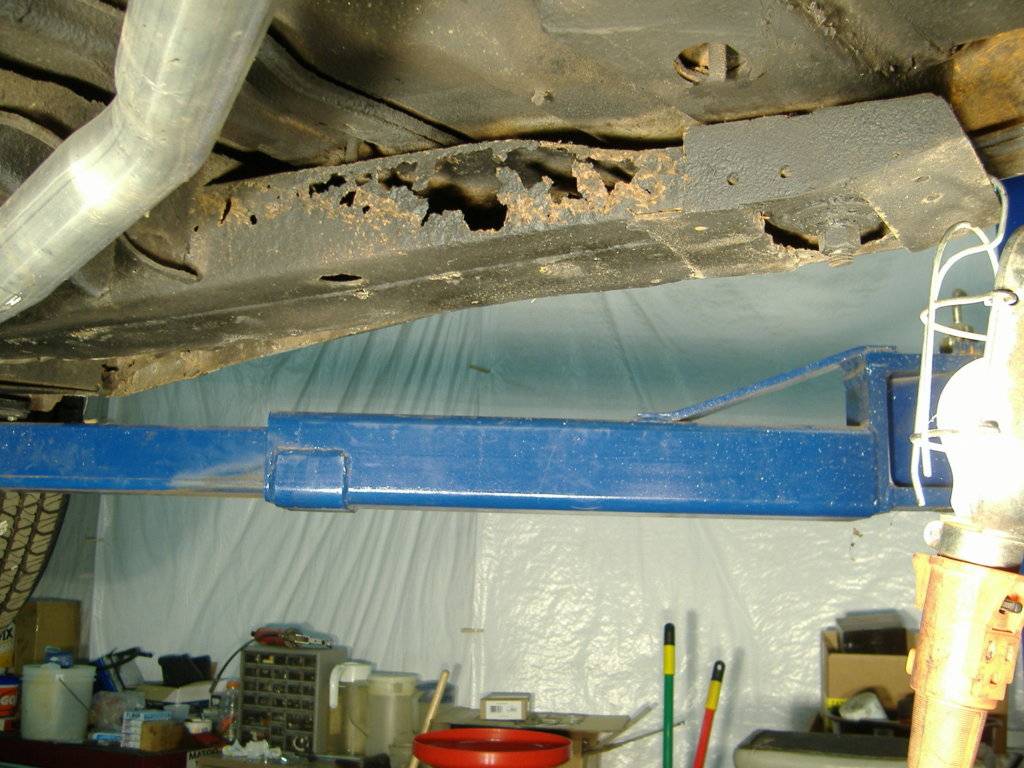

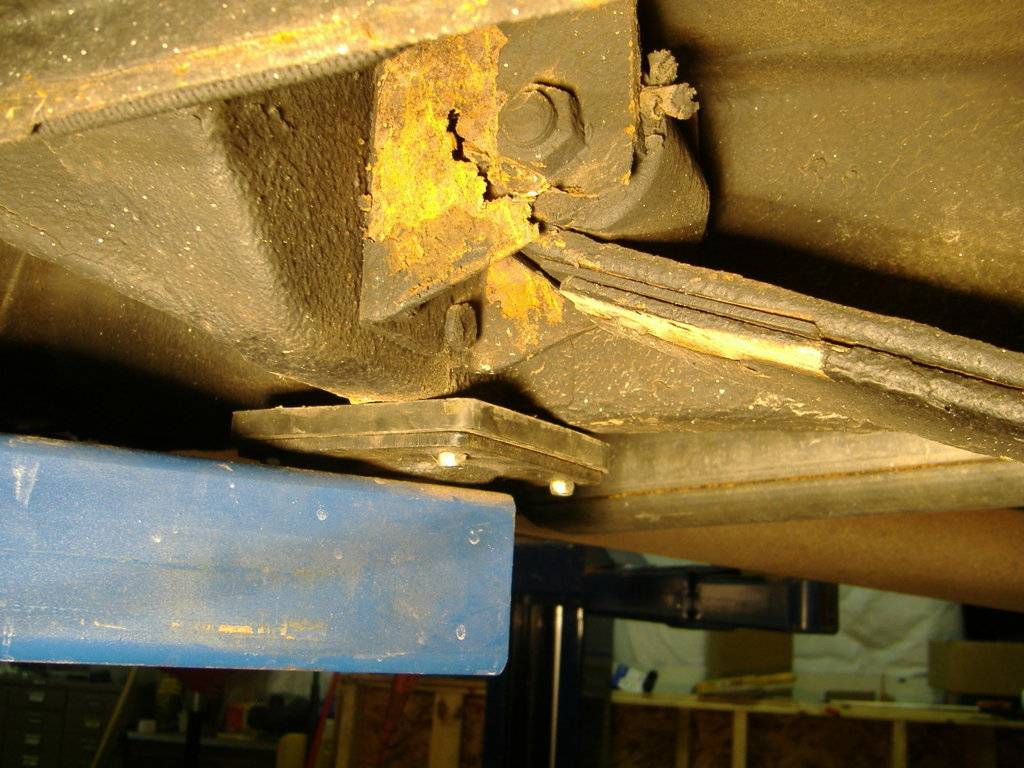

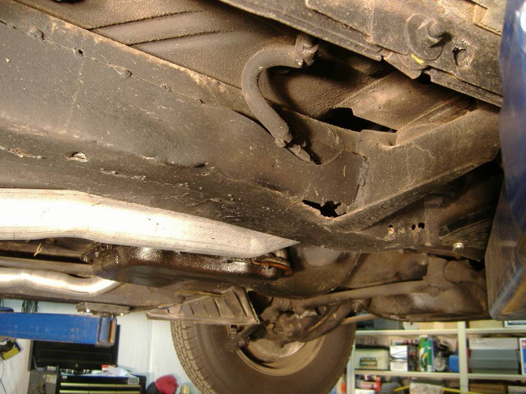

Yeah, it looked pretty sweet on the ebay listing too. As I said earlier. Missing trim=trouble, and this car has it in spades! It's the textbook patched-up rust-bucket.
A 20 gauge sheet metal patch on a sub frame does not constitute a structural repair.
especially when you totally ignore the fact that the inside is gone too
Body is going where mounts attach
Left rear spring hanger just about ready to rip out of body. Just needs one good pothole shot.
Then right after the rear of the spring breaks loose, the rotted front hanger will go too. Then we have a rear-wheel-steer Fury!
In addition to the underbody problems, the quarters are carved out of mud, the inner quarters and wheelhouses were gone and half-assed patched. The trunk floor has a nice, big hole in it too. Also included free of charge were major mechanical problems like a bad radiator and blown head gasket.

You're spot-on with the assessment of the body of the car. It's got the elderly bumps and bruises, but no "crash" damage.

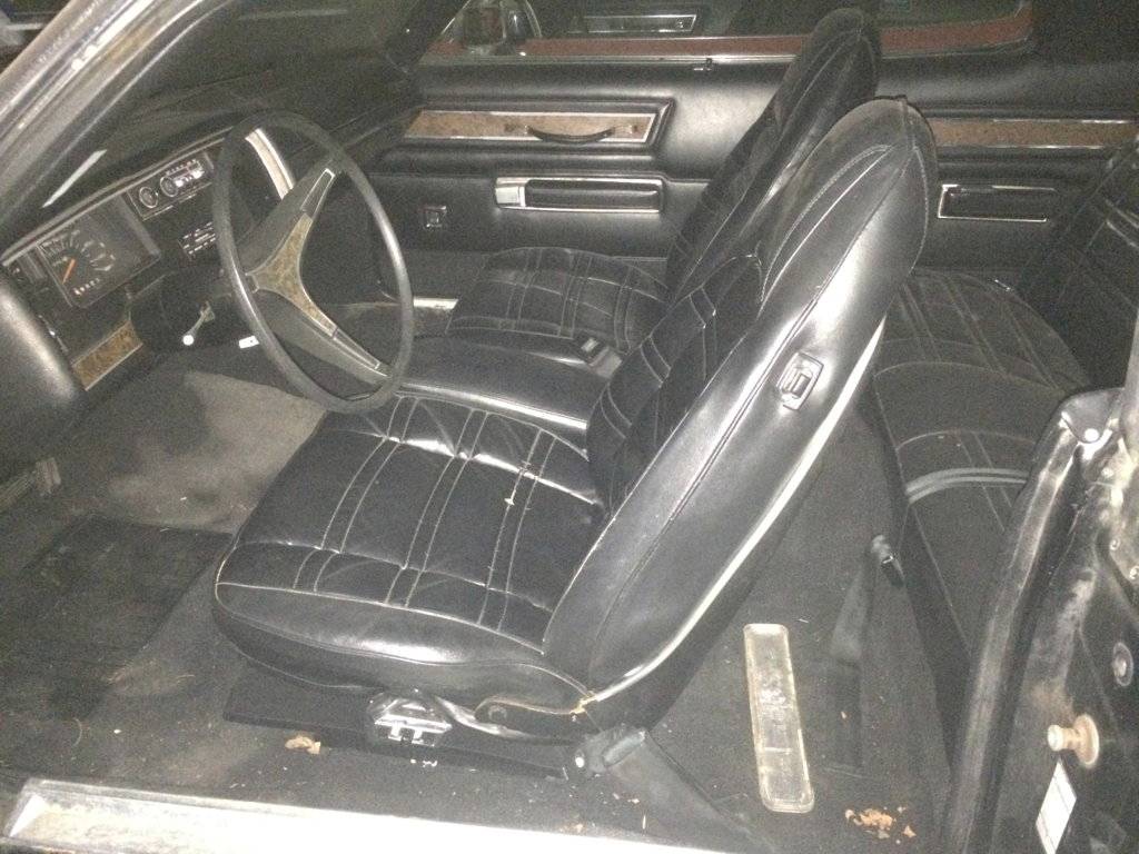

There's a small bright side to the black Gran Coupe, that being it's optioned almost identical to the silver car, with the exceptions of having a 400 instead of a 360, and mono AM/FM instead of stereo. It has the same interior, in about the same shape, other than 2 big cracks in the dash pad. Here's a crummy flash pic:

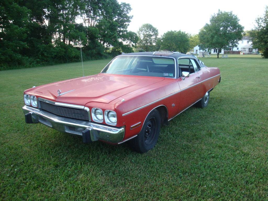

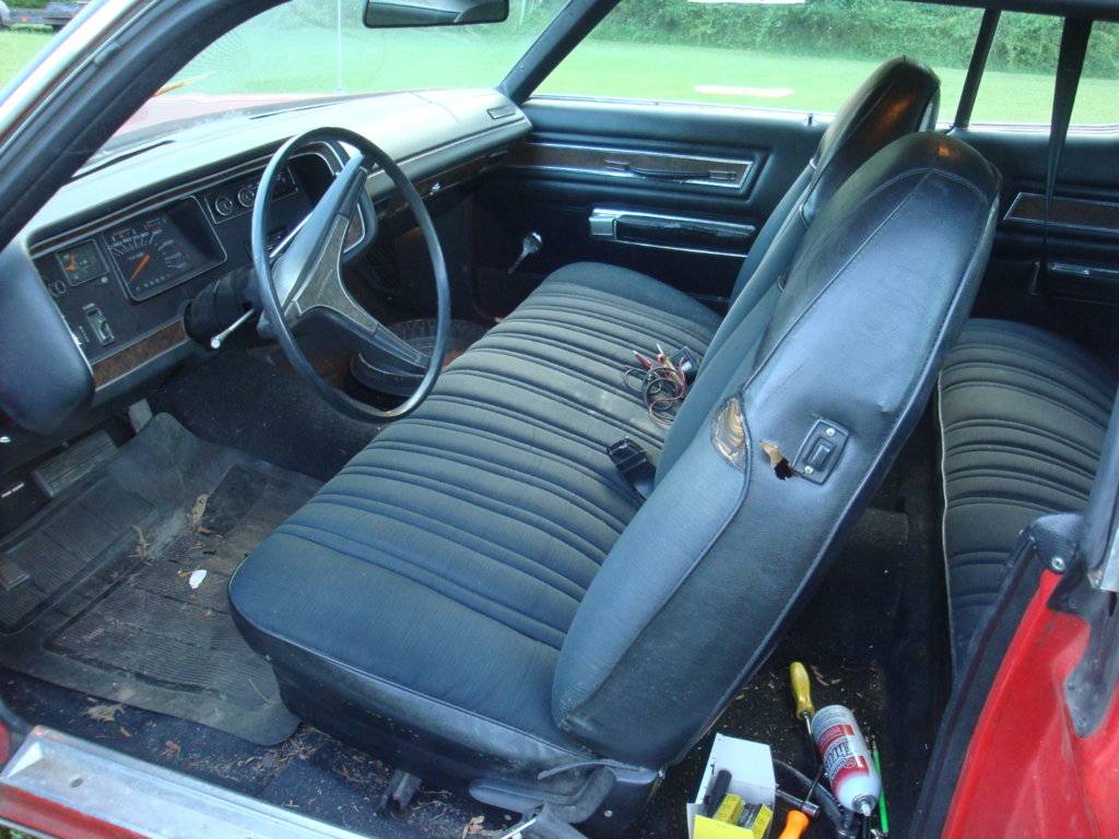

Boy, that black one was a tear jerker. :( Could the red one possibly be worse?

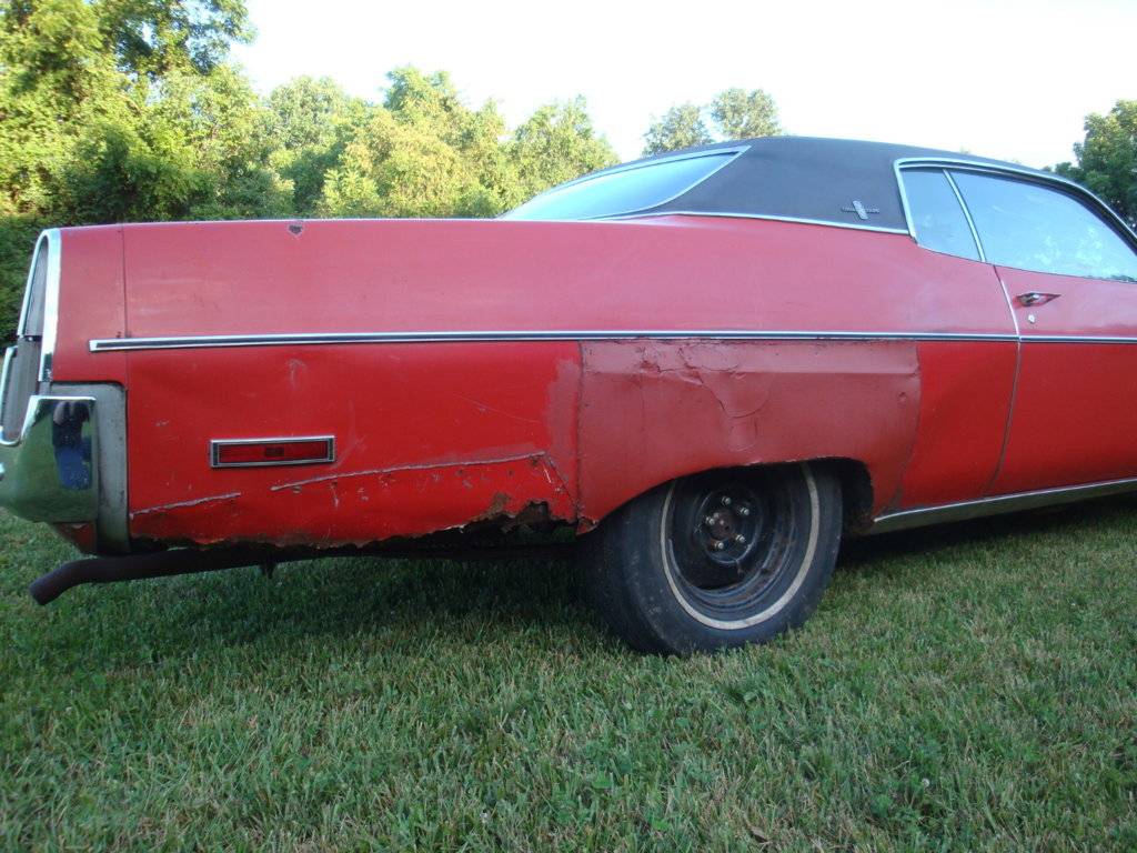

It's not looking too too bad from here. Needs a top, has some minor quarter rust, a shallow dent, and that extra-long tail pipe needs to go.
Ooooh Nooo! :wideyed: ..What?....Where?....Who?..........:wtf: happened here???!!!!
Seriously, I have to wonder if the "abuser" responsible for this atrocity stood back and admired his work, thinking "Man, that looks so much better now"
It probably won't come as much of a shock that I bought this one out of a junkyard for $300. If you ignore the problems with the right quarter, the body on this car is actually the best of the three. The left quarter is fixable, and the rest of the car is still wearing it's original paint. The underside isn't as nice as the silver car, but it's all solid and has beautiful trunk floor. This one's more plain-jane inside. Pretty much just the common stuff: A/C, cloth bench, 360. Dash is cracked and seat is ripped a bit.

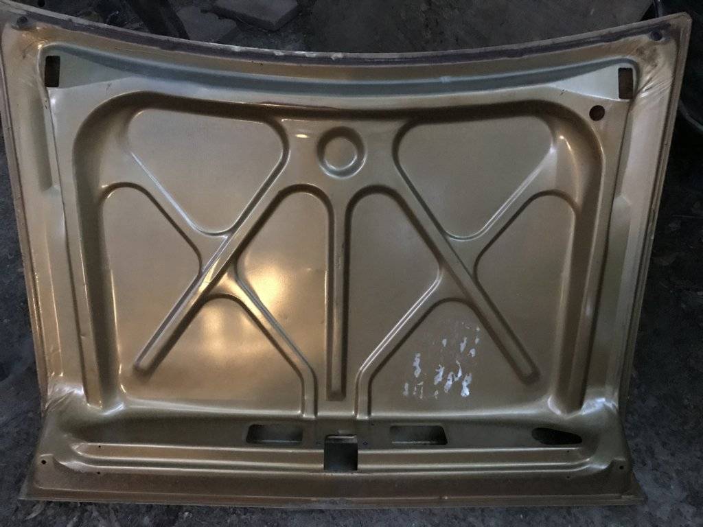

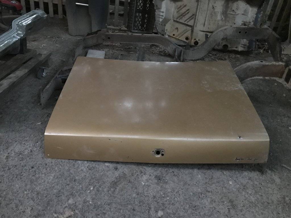

@bigmoparjeff , would the trunk off of a '73 New Yorker fit that? I have a rust free example going to scrap in the next week. It's yours if you come back to Jersey and get it.
Let me know about the floor pan if he doesn't take it. I imagine it shouldn't be too much to ship it through Fastenal? Oh and do you have any of the footwells spare?
Just re read my post, I’m sorry I was referring to the trunk lid to replace the one that has the busted lock opening. I’m hoping to use the floor and trunk metal to resurrect my “parts” car.
That would be great. The trunk floor in the silver car is still there, but it's really thin, and the NY'er floor should be the same. Is it still in the car, or already cut out?
Thanks, Jeff
Your correction popped up on my screen just as my response was being posted, as I hadn't refreshed the page in a while. I hate to see good stuff go to the trash. I don't think it would be worth a separate trip, but if I could grab it while I'm fairly close I'd like to save it. What town are you in? I'll probably be in Cinnaminson on Friday afternoon, October 6th.
Thanks, Jeff
Thanks, Jeff
Yes, sorry for the confusion. Trunk floors are a hot commodity for sure. I live in Cinnaminson! You can PM me when you want to pick it up, I’ll hang on to it till then.
