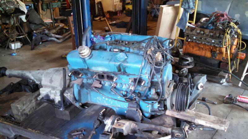

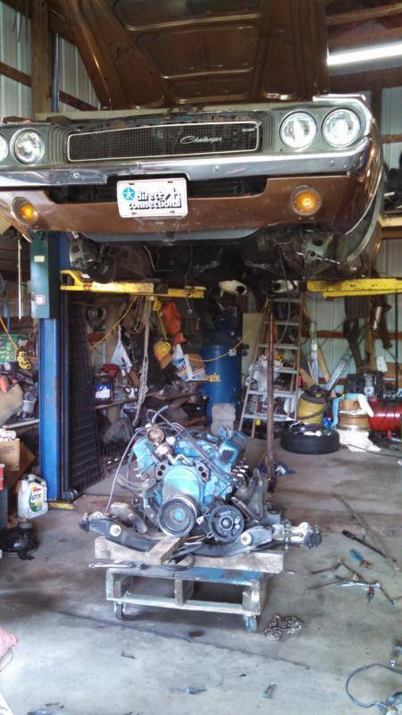

Here is the old one coming out of my Challenger I will close it up and keep the matching numbers safe.

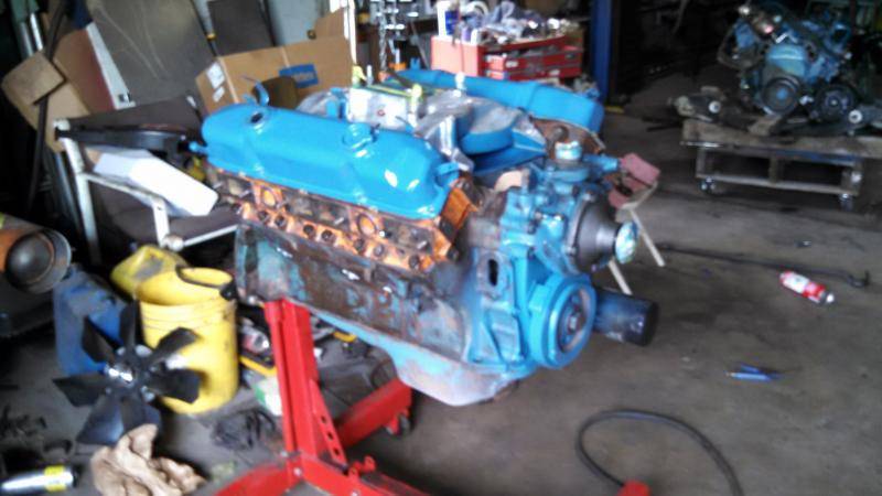

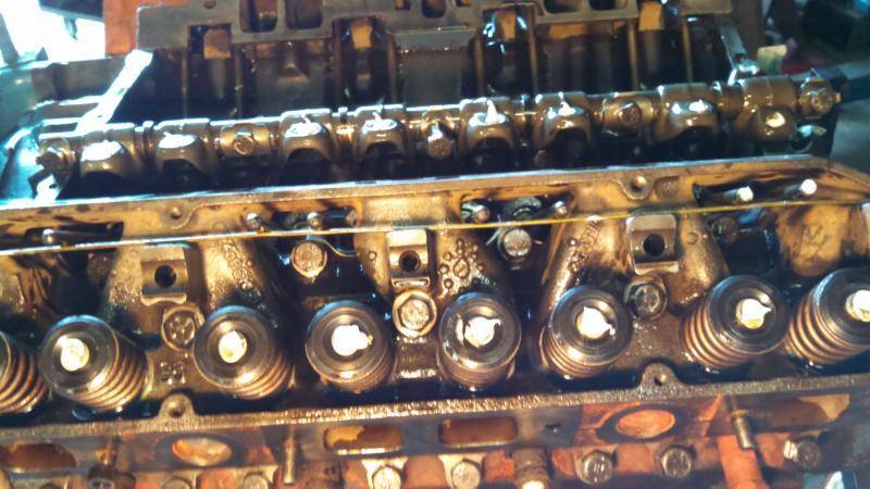

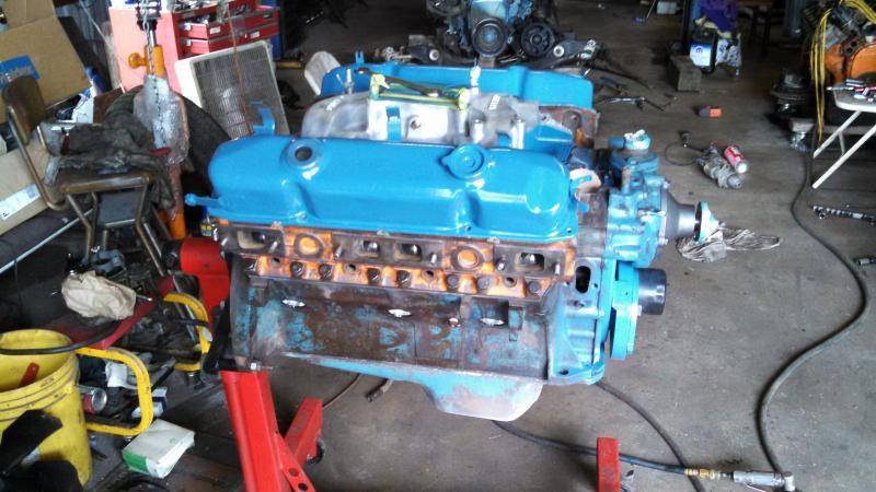

Here is the 400 I saved by hours from the shredder, wearing a set of 516 heads that were redone with bronze guides and a opened exhaust valve,1.74 vs 1.60, that I picked up at a swap meet for $20. With new valves, springs, locks and retainers, here they are on the Smogger 400.IMG_20150905_120017_399.jpgIMG_20150905_120041_378.jpg

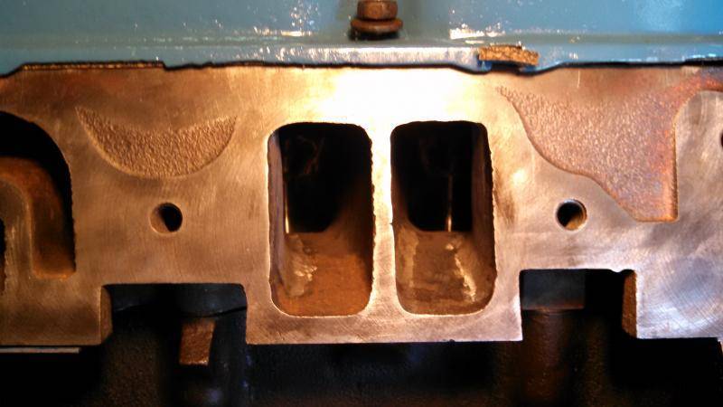

I pushed the porting further than I felt comfortable with because I only had $20 invested at that time. IMG_20150905_120217_895.jpg

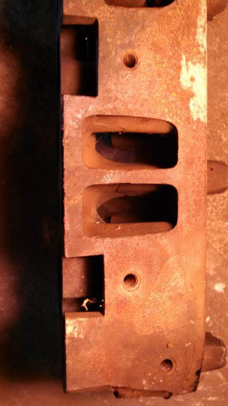

For reference here is a stock head.

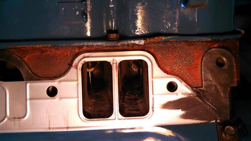

Here is the valley pan going on with nice gasket match also done to the intake for a smooth transition from intake to head.IMG_20150905_143530_595.jpg

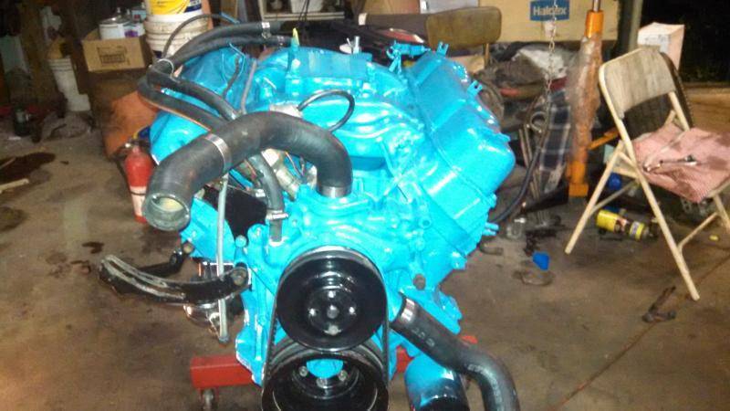

Final valve train assembly after priming and relubing the cam.

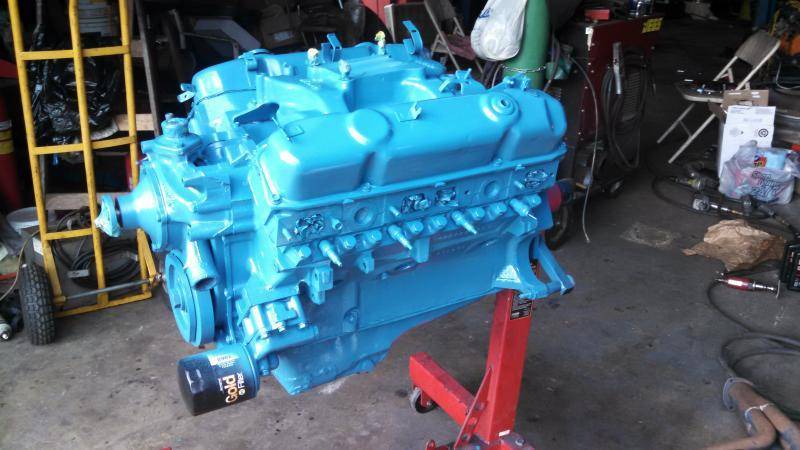

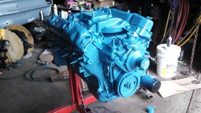

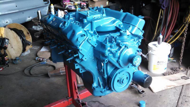

All buttoned up and some paint.
And finally getting dressed for a date with my engine compartment.

What are your intentions with this engine dave? I thought 516 heads were just boat anchors.
Racing at Norwalk next weekend. I used them because I have them and I needed closed chambers to vet any compression at all on smogger short block where pistons are down .120 in the hole with the measured 73cc chamber I'm still only 8.43:1 so I can run it on cheaper gas and still have some fun. We will see if they are boat anchors or if my handy work brought them up a notch.
