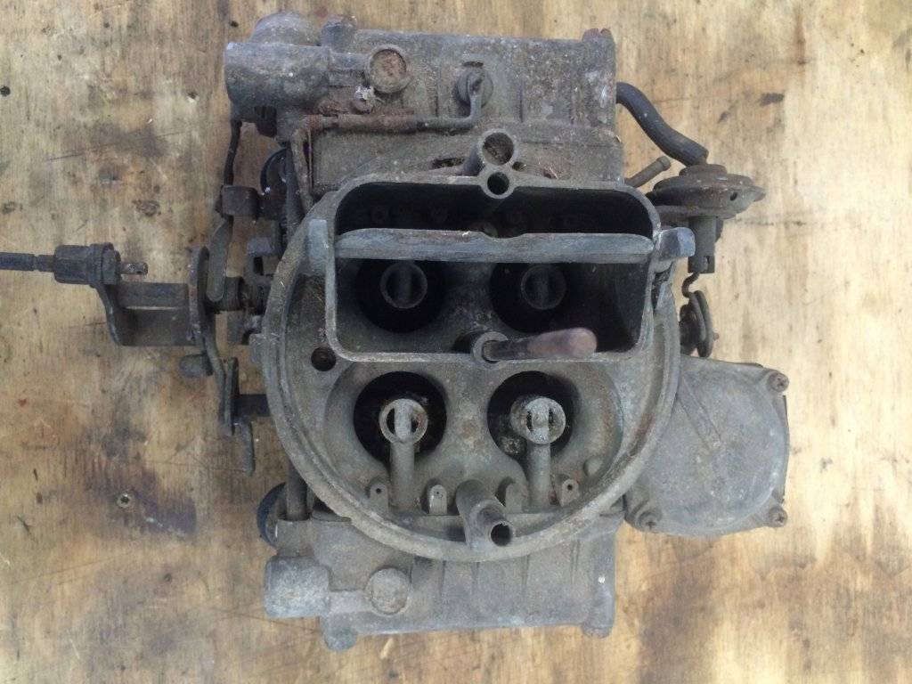

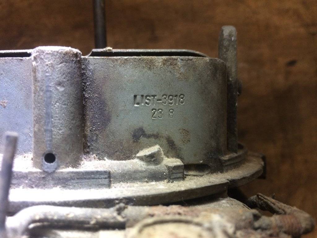

If you're interested, I have a Holley 4160 that needs rebuild. In 75 or 76 I took this from a 69 Fury ex-New York State Police Car w/440. I think in 68-69 the Holley's were only on the police cars.
I'm sending you a PM.
