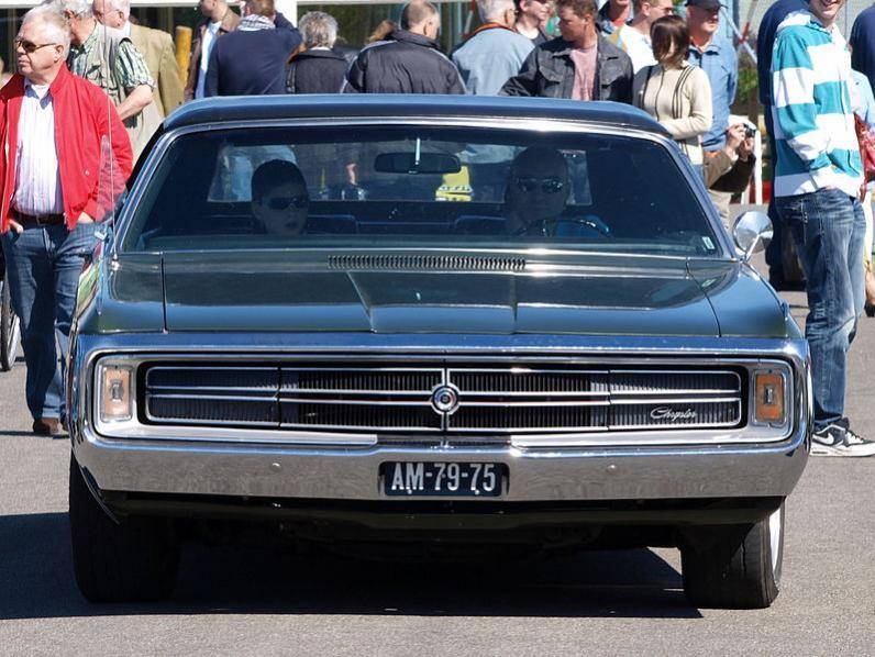

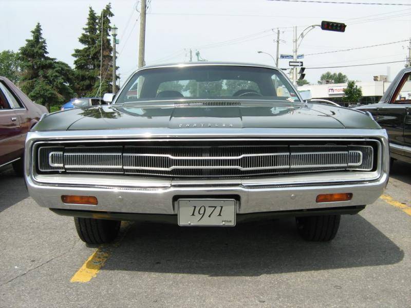

I have a grill assembly from a 71 300 that I would like to swap out, but I think I need some sort of grill surround from a 71 to complete the swap... The 69 has turn signals integrated into what I am calling the "Grill Surround" where the 71 appears to have the turn signals in the bumper and the surround is a different shape.
I am including a couple pics of 69 and 71 front ends for reference.
Any ideas where I could get my hands on such a surround or possibly an entire front bumper grill assembly?

Appreciate the reply to the post...
Must admit these are NOT pics of MY car.. just ones from internet to use as reference for my grill dilemma...
I will post pics of my beauty as soon as I can!

Personally I perfer the 69 front appearance over the 71, plus it will help maintain your cars value.

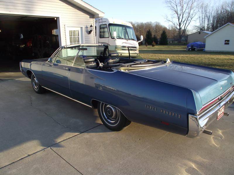

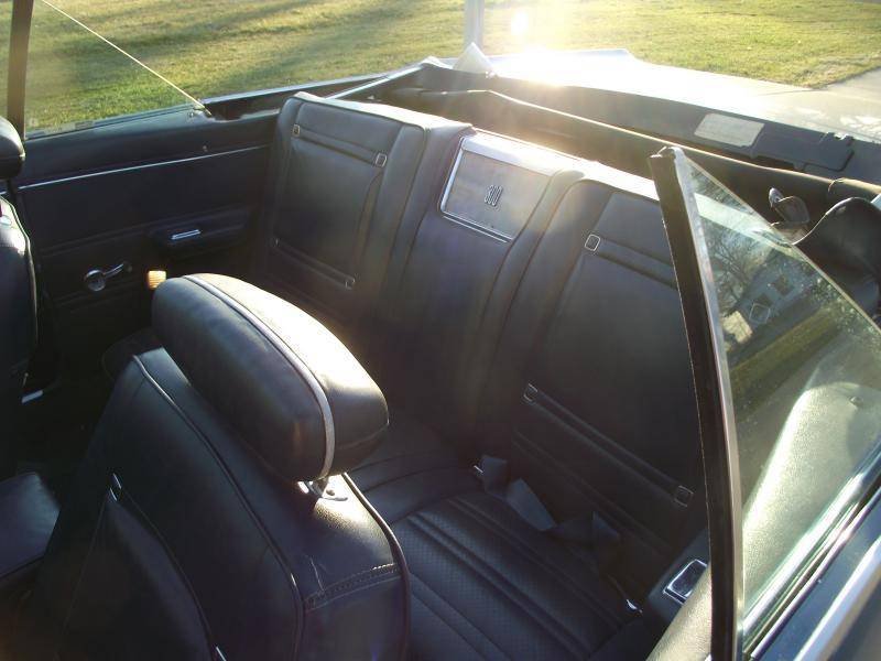

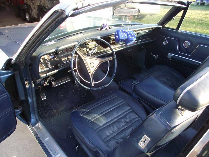

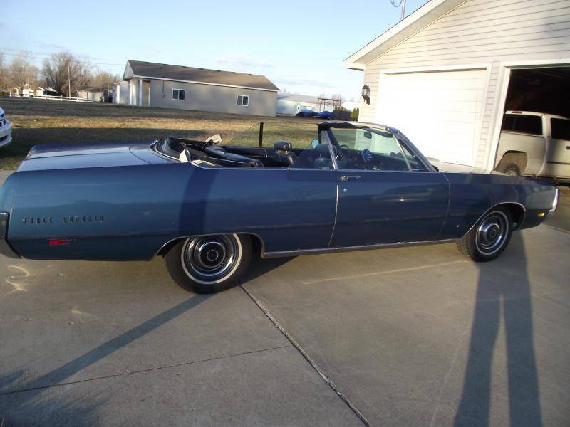

A Few Pics... Finally...
Here are a few pics of my 69 300 Vert as of the day of purchase...
Not much has changed yet... but I have some ideas...
Beautiful 300 ...... Why would you even think of swapping grilles .....?
Just my opinion ..... but lose the dice, (another chevy thing).
I agree, ImO u should keep the stock grill.... It looks good the way it is. Why mess with a good thing?
Welcome! Why change anything on that car? She's a beauty as is.
Great color, convt. top, all you need are a set of factory road wheels or chrome magnums and your good to go.
