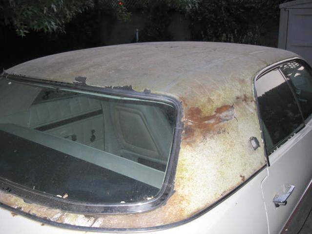

Here is what it looked like under a 73

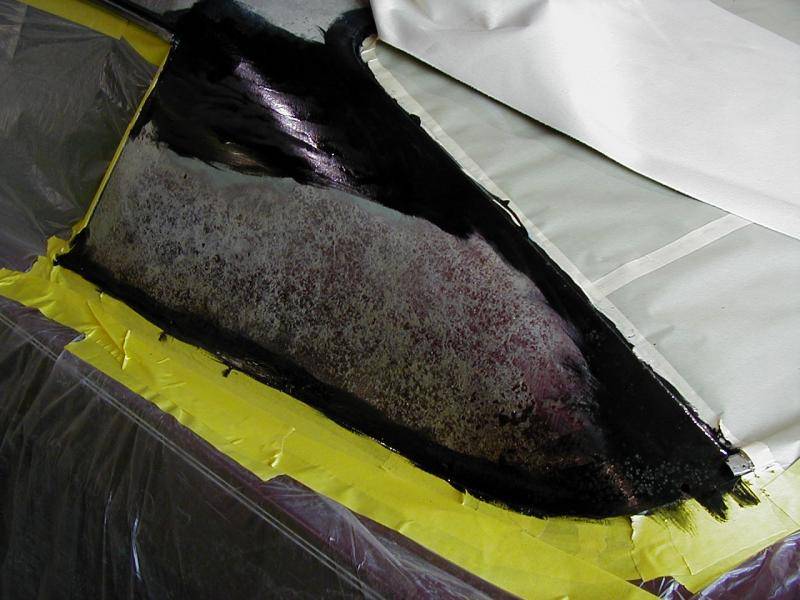

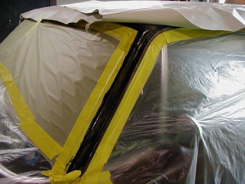

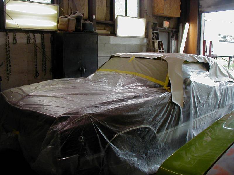

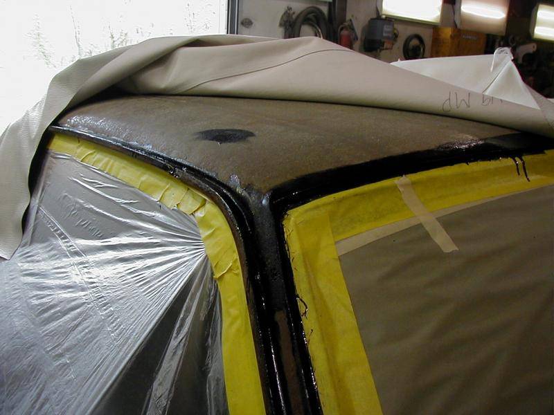

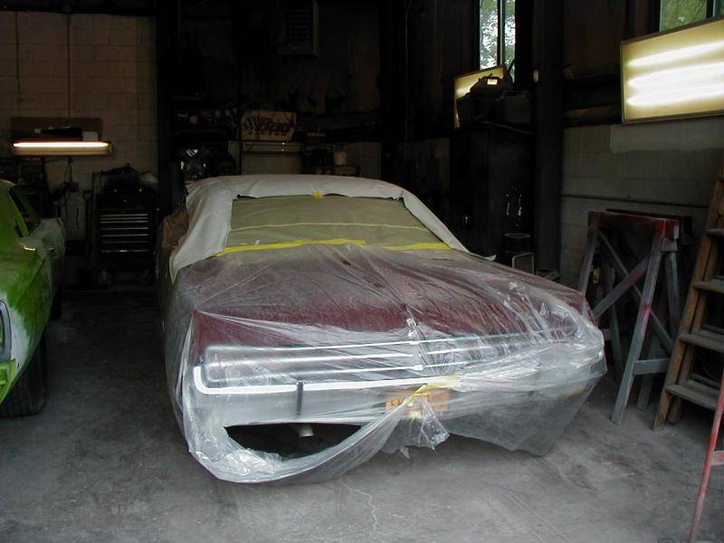

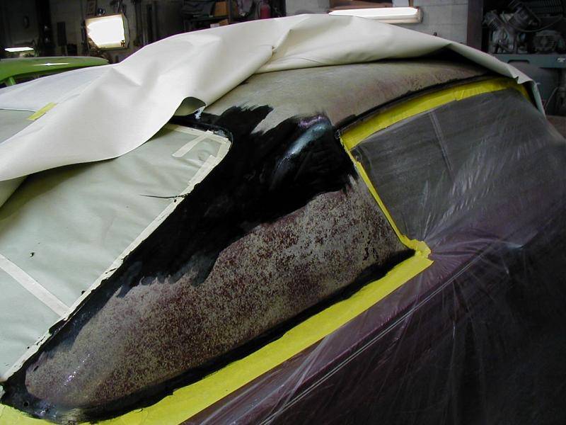

Ok, took a drive this morning and got some photos....the roof looks amazing. The only places he used POR 15 on was the places where he replaced the seam sealer, made repairs or wanted to add more protection.

The way it ws explained to me was that POR15 penetrates into all of the small imperfections that you don't see. By doing this it seals out any air or moisture that can be trapped that can turn into rust later on.
Looks to be solid. Personally, I'd go for a complete paintjob for the roof, I tend to overkill in such issues.
You'll probably be fine that way as well, after all the first top with the factory preparation lasted 45 years as well.
He had the new vinyl laying on the roof to get all of the wrinkles out but its not ready to install as of yet. The factory paint can be seen in several photos as well as the red lead.
