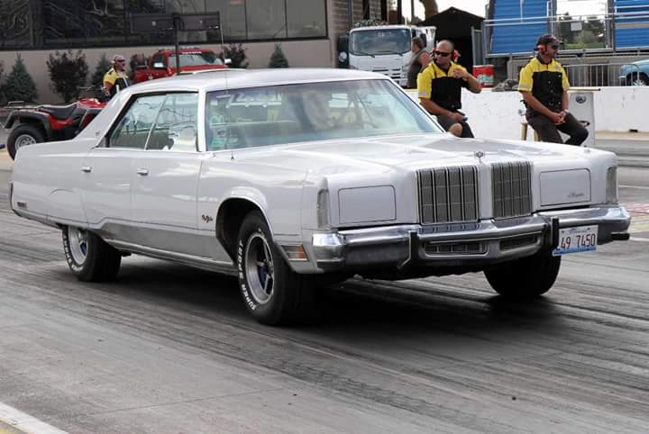

    Who said you cant race a new yorker?
    • Like Like x 4
    • Agree Agree x 1

    MEV races his NewYorker with exhaust manifolds and hit mid to low 12 second 1/4 miles.
    • Like Like x 1
