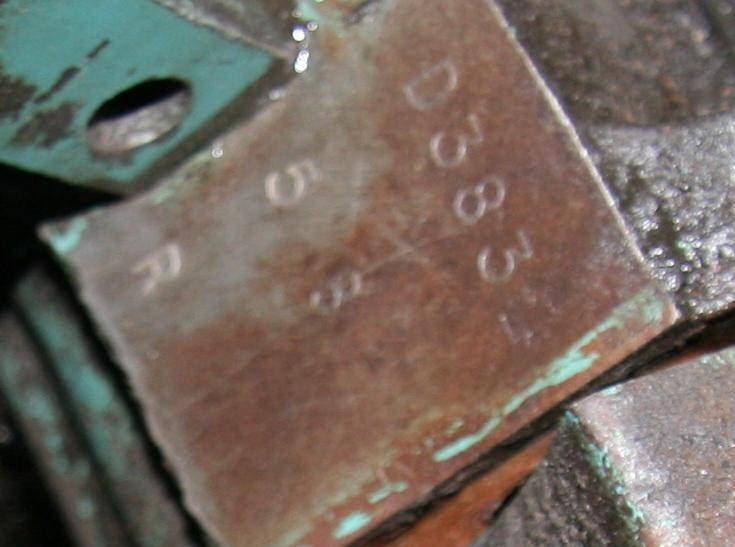

    You can't, but you can see verify it's a '67 engine. Top of the block, in front of the head on the passenger side. Should be C383 (D383 in pic is a '68 block)

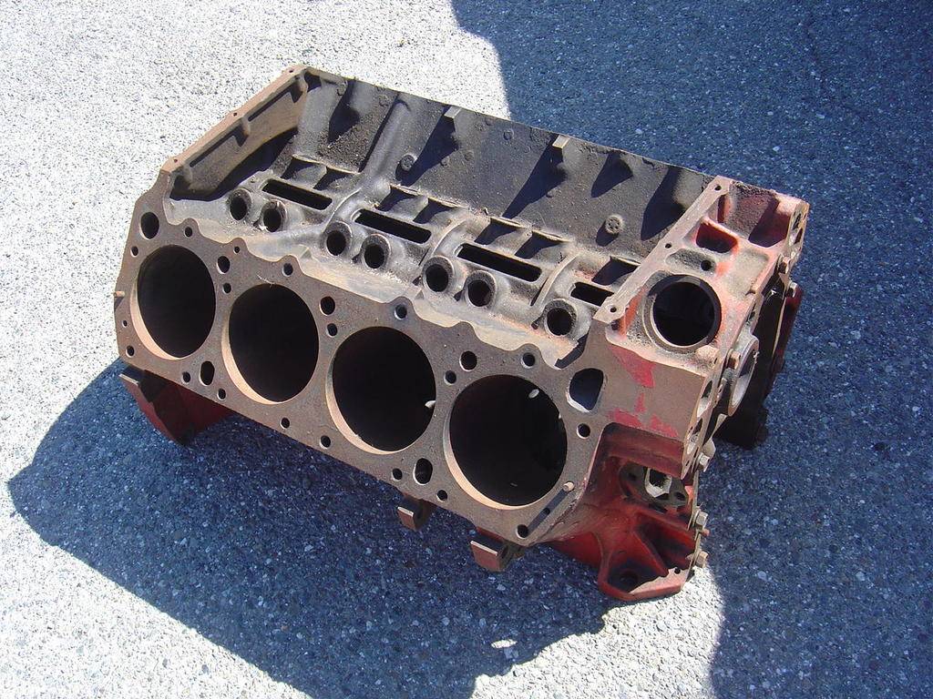

    Engine block to show location... Under the distributor hole on the block deck.

    it is a 67...with 915 heads. doesnt look to ever have been apart. isnt the cam different between 4 and 2 bbl engines? can i measure the valve lift or something to determine what cam is installed without removing it since i just buttoned that part all up yesterday.

    Before you get all excited, you can also check the casting date on the side of the block. It should be before the build date for the car. Usually with a 383 the casting date will be about a month older than the build date for the car, but this varied widely from plant to plant and during different times of the year. For '67 the G code on the VIN was for the 383 2BBL engine, The H code was for the 383 HP engine. The '66 models used the G code for both 2BBL and 4BBL. Casting number is on the left side of the block #2468130 and the casting date is usually just above that number. If you have a car that was produced early in the model run, it may still have the '66 coding with the 4BBL engine, stranger things have been known to happen.

    The date on the engine is 8/17/66 and it does sport that casting number. I think the car was produced in Nov. If I read the date right on the tag.
