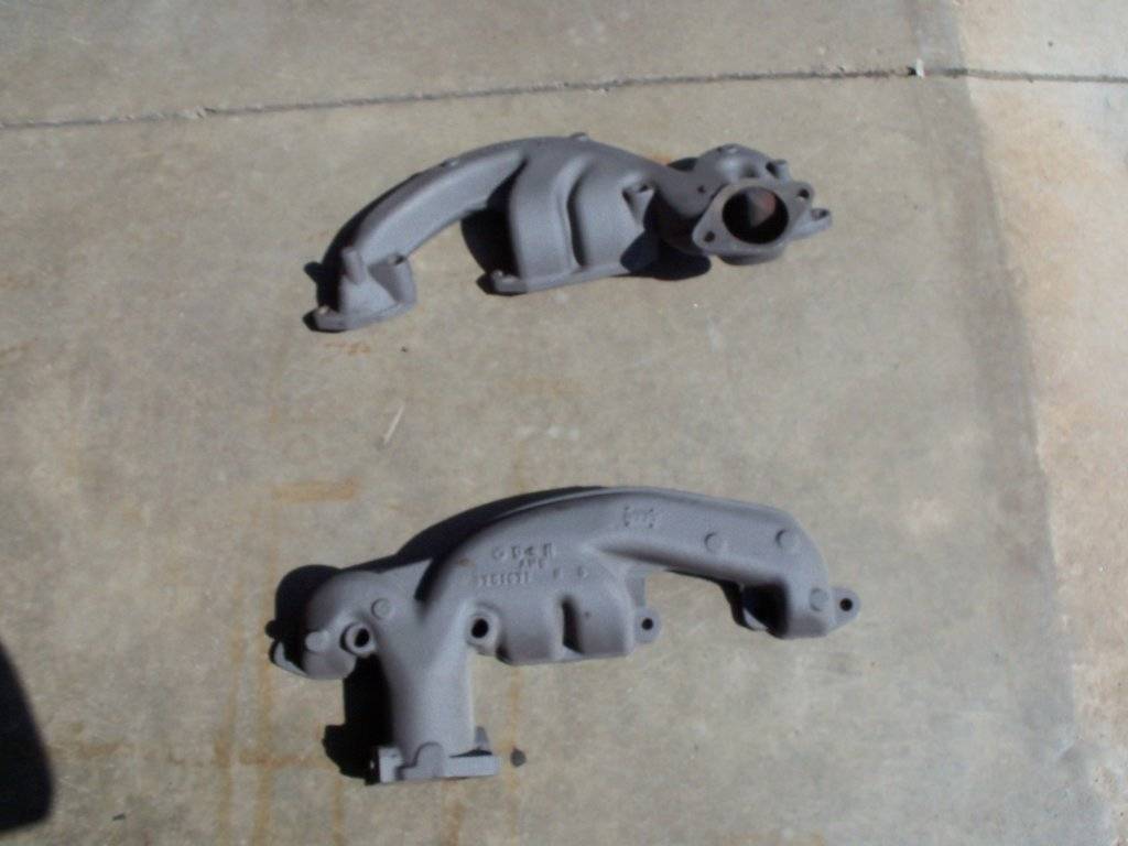

The sand blasting,fine sanding and application of the Eastwood exhaust manifold paint was not done in vain.
I am very well aware that eventually my HP exhaust manifolds will go back to "aux natural".
They had not yet started to turn but I am enjoying my brand new 51 year old car for now as i hit the show circuit this summer.

A pal with a RR had someone do a "cast iron ceramic" finish to his logs, and 3 years later it's fantastic. I like that look you have there. Hard work, good results.
