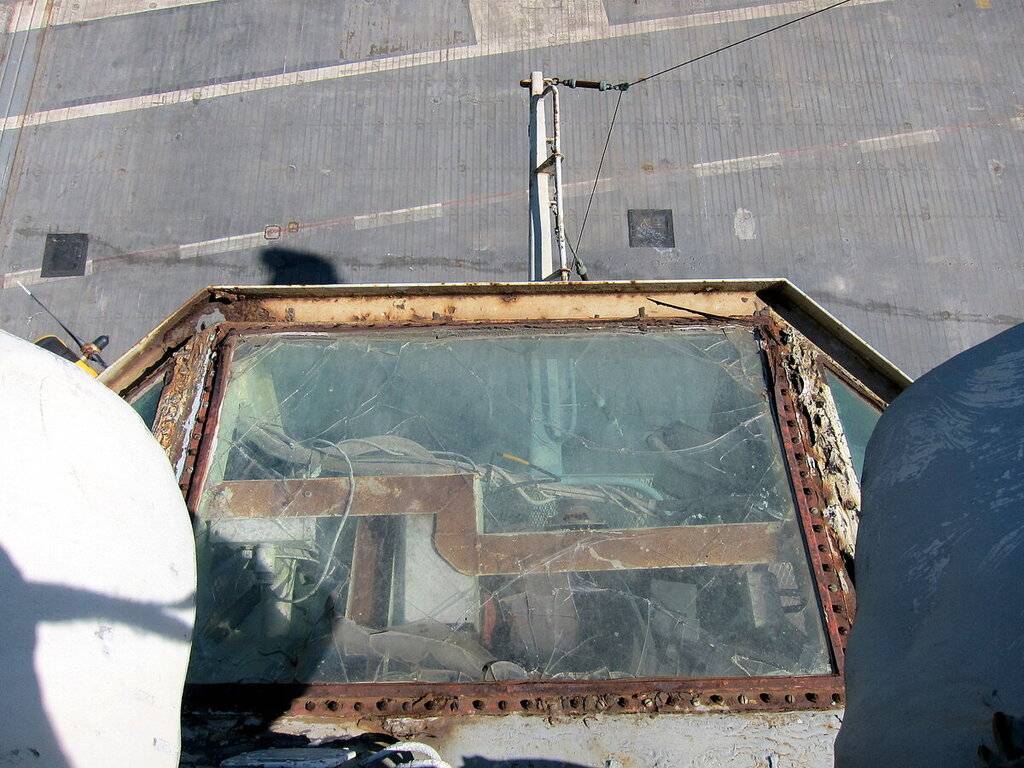

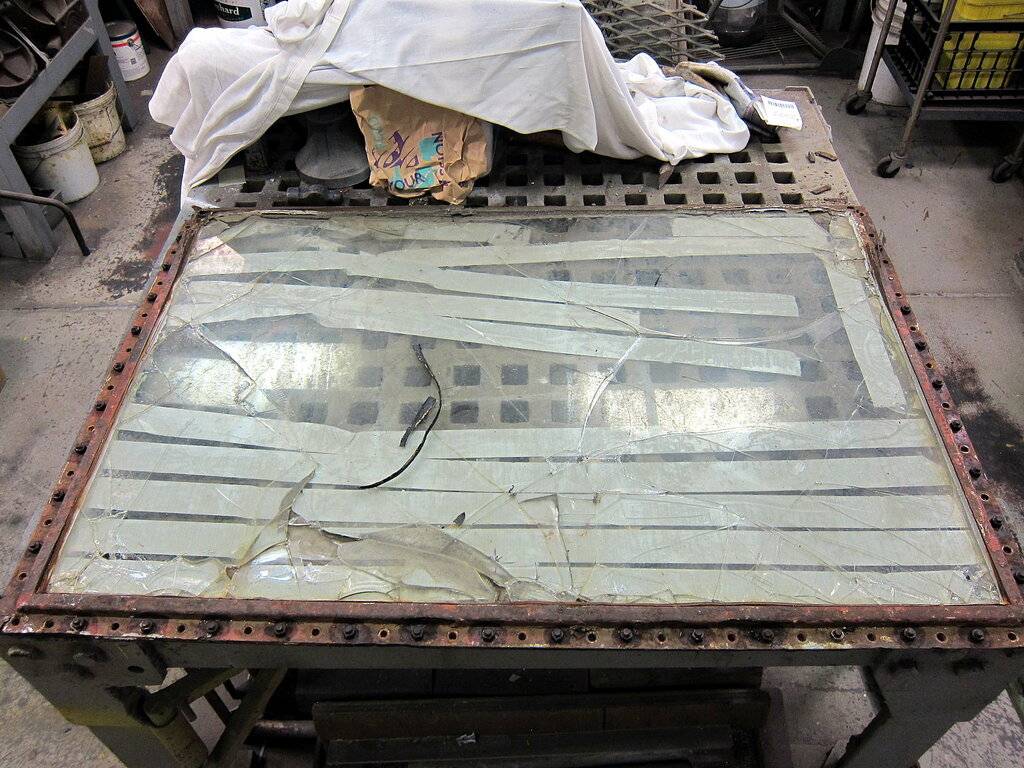

So I heard one month ago that Pri-Fly aboard the Hornet was closed because an overhead glass panel was broken. It would now stay closed till further notice as glass was falling off the laminated panel little piece by little piece. Alan, a docent and former carrier Skyhawk pilot in the 60s and 70s wasn't happy. I said let's take it out ourselves and then I'll replace the glass. Little did I know which panel. Clearly hit by something. Got it out but next weekend Security stops me as I board and tell me there is another broken window. How, nobody can go in. It was the hatch window and being tempered it was hundreds a little cracks. However, four main cracks were visible and where they met that part was lower than the rest of the panel as though punched. So this makes me detour from what I am doing and work on this. Once up there I knew the whole area is going to need work whether broken glass or not so not a total loss in the end since no one else will go up/down there.
The hatch the next week. I do get to take things home from the ship to work on. Back and forth twice.

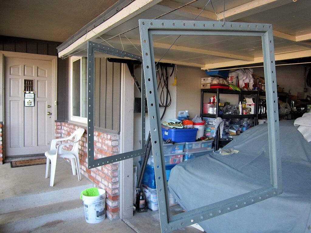

The overhead frame. All those nuts will need to be cut off. The bottom of the frame, where water collected since 1970, is gone. Turns out it is Z bar which our machinist volunteer can get made for us to repair. I asked how many feet and he said 18 feet as his truck can carry that. So we will get them to fab 36 feet to our specs so we can make a whole new frame and them some for other possible replacements I discover up there. The glass will be tricky as it is 1/4" green tinted laminate.
