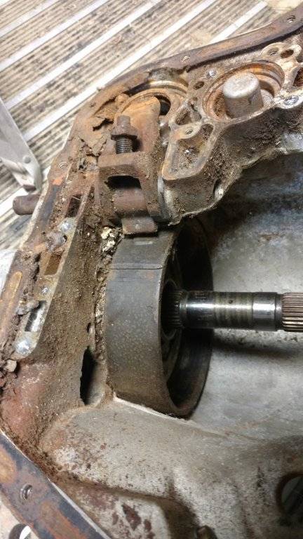

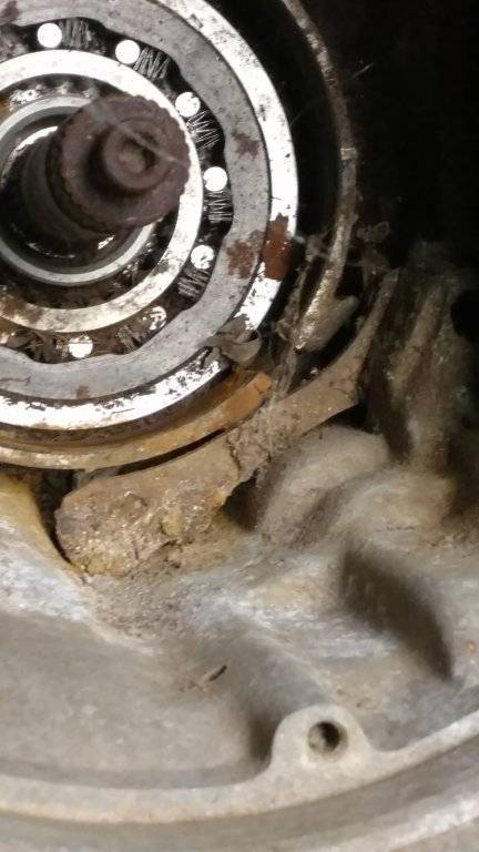

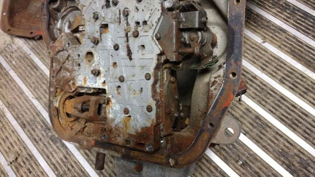

Here are some pictures of you parts in question top is how the anchor extends up into the case. Second is the band and anchor with all the other internals removed (stolen by me) last is with vavle body in place showing what it covers up. The low reverse is the one inside the trans.

The sprag/overrunning clutch is the rollers and springs you can see in top photo, you will not be able to see them if you pull you valve body. The rollers get wedged and stuck effectively locking the clutch. This creates a dangerous situation with the front drum spinning it at 2.2 times (reverse ratio) engine rpm and the stock ones usually come apart (explode) above 9,000 rpm which is about 42-4300 engine rpm. It usually takes some abuse to break one burnouts in water, ice, leaves, then a sudden catch in traction or dry pavement.
