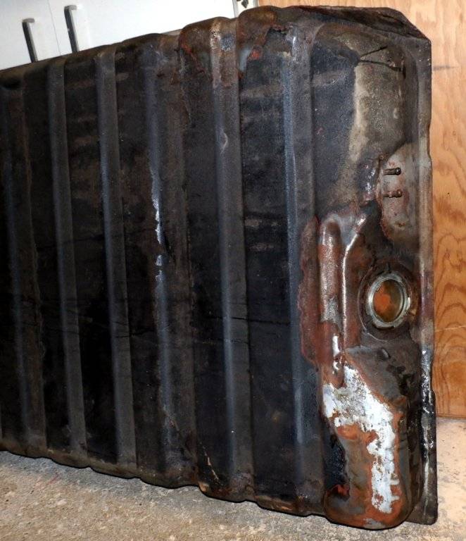

I've had success with three tanks. That tank in my 64 D100 is not made any more... (That I know of and I'm going to put one behind the axle one day) I used the chain, nuts, bolts and even gravel method. I've used Red-Kote without issues on all three. My 2cents. Craig
Last fall I took the tank out of my '67 Monaco. The car had been in storage for 20 years and there was a couple gallons of "turpentine" in the tank, but it obviously had leaked more out over that time, a thick sludge of black tar on the floor under the tank. God knows what they put in gasoline to do this.
I took a small grinder to the J-bolts (they're easy enough to make out of a pair of regular bolts).

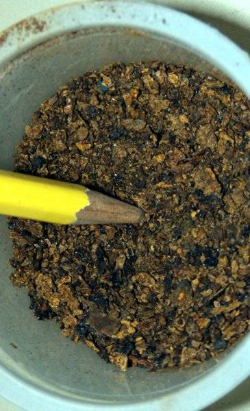

There was some sort of gritty stuff in the tank, like sand or dirt, a lot of it. I drained the tank, but didn't really flush it. I set the tank outside for the winter, protected from direct exposure but still able to air out. Took the sender out, it looked like it came from the titanic. I had a new one, bought 20+ years ago.
At the time I called a rad shop about having them work on the tank, they said bring it around. I didn't. I called back about a month ago, they say they don't really fix these old steel car tanks any more. Great.
So I make a cover plate to seal the sender hole, and then begin to de-rust the inside of the tank with vinegar and electrolysis.
About 2 gallons of 10% cleaning vinegar, rotate the tank to get the sides, ends, top and bottom, about 8 hours each session, leave the vinegar in there the whole time, about 2 weeks I guess. Have to watch for leaks from the holes. Using a lab or bench power supply, set the current sometimes at 1 amp, sometimes at 6 amps, usually to get 60 watts of power flowing through the vinegar. It gets warm.
Then I start flushing it with water. Flush all that sand and grit out. Let it dry. This is what it looks like.
I should check this with a magnet. I can't remember if back in '87 when I worked on this car if I used a tank coating on the inside. This might be what's left of it. Either that, or this precipitated out of the gasoline over the past 20/30 years.
This is what the inside looks like now.
The de-rusting has created more pinholes. I've tried soldering some pin-hole areas but I can't get the solder to flow like I want to cover these areas smoothly. I'm going to use fine copper screening soaked with solder like a patch to cover these areas.

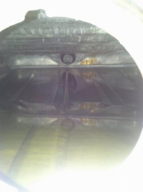

Here's what I would do...
I'd pop the sender out and take my cell phone and hold it up to the hole and snap some pictures. If the tank looks rusty or bad, I'd buy a new tank. If it looks good, but kind of dirty, I'd take the tank out and power wash it, dry it and stick it back in with a new sock on the intake.
A new tank is about $325 and a "kit" to clean and seal is about $100. I've never used a sealer, so I have no real feel for it other than I've heard horror stories about the seal coating coming off, so I would be reluctant to use it. No idea what a radiator shop would charge, but dollars to donuts, they will want to sell you a new tank instead of "boiling" out the old one.
$325 isn't cheap... But neither are tow trucks and repairs. Do it once, do it right and be done with it.
A pic of the inside of my tank. A couple rust stains from where the galvanizing is breaking down, but just fine otherwise. This was probably 8 years ago.
