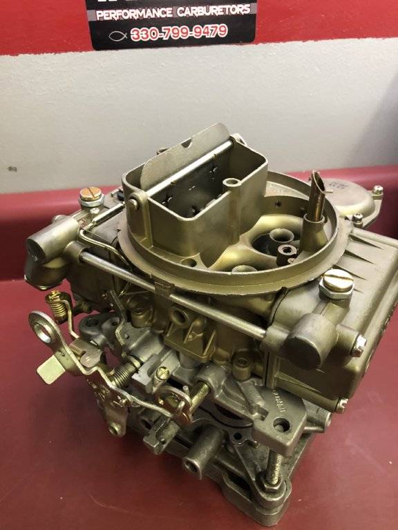

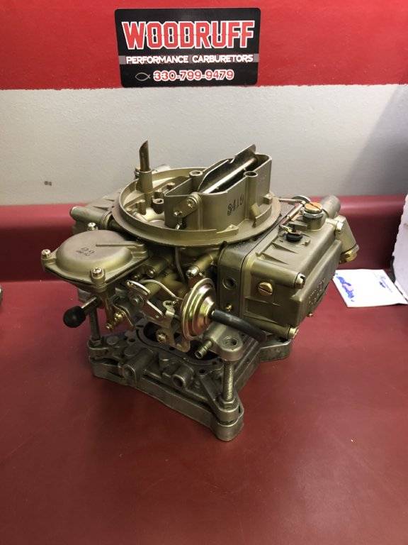

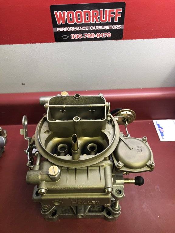

Funny you should ask. I have a customer right now with a 66 Chevelle 396 325hp. He has made several performance upgrades and is pushing the 400 hp Mark, all while keeping stock appearance. So, we snuck a 750 main body in between his side hung float bowls and modified a 750 baseplate to mimick his 3419 with the divorced choke also. I’m just not sure if the transfer tube will flow enough at WOT. I figure Holley didn’t retool and start making duel feed carbs for the heck of it. I will be test running the 3419 clone Monday. I will take a couple pictures before it leaves the shop.

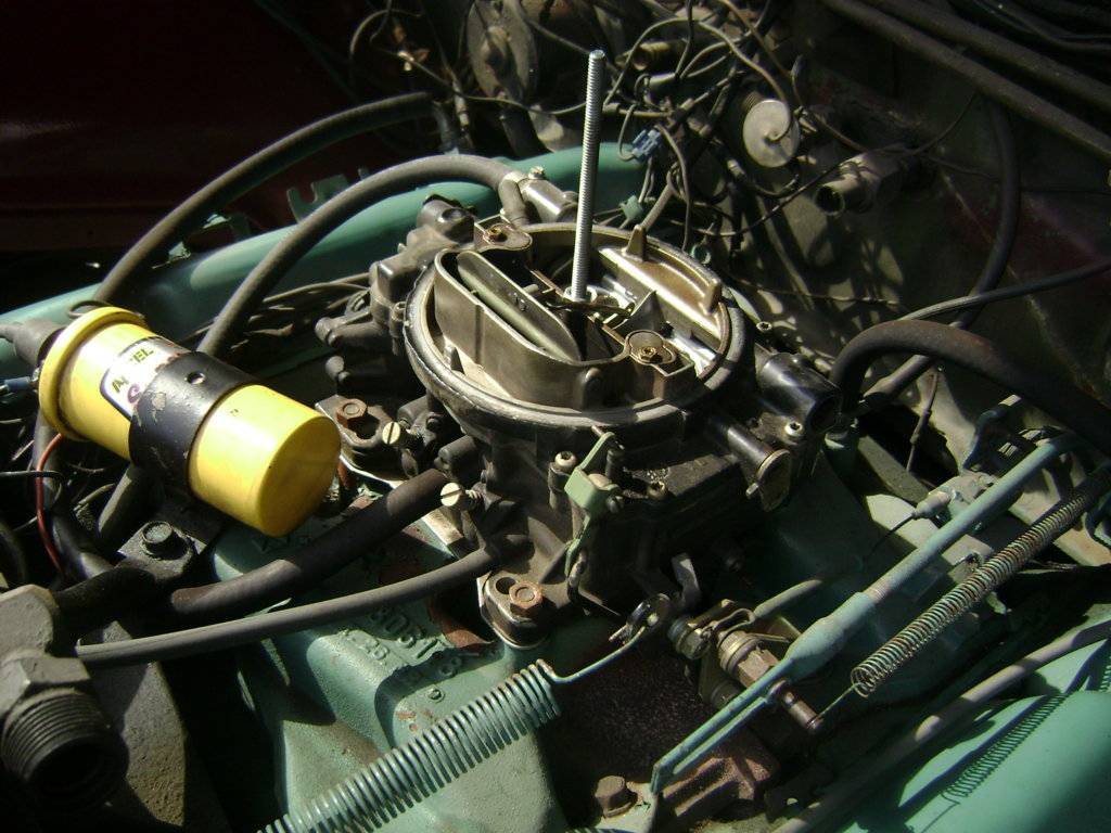

Cruising and tip in the #1 carb is a Carter TQ, totally wrong for your "look"
Just make a dual feed line from copper nickel line and hide it under the air cleaner, cake and eat it to.

My piecemealed TQ outperforms the new 600 Eddy loaner I had on my Charger hands down
Better MPG, throttle response, WOT
