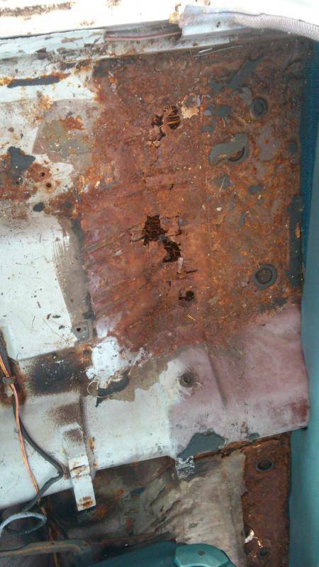

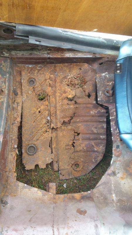

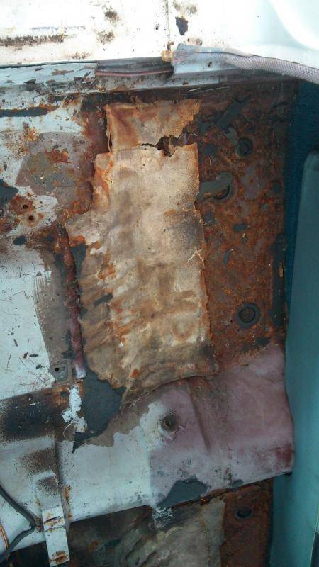

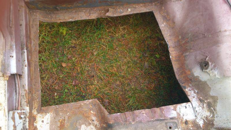

This is what i found under the carpet :eek:ops: DSC_0170.jpgDSC_0172.jpg

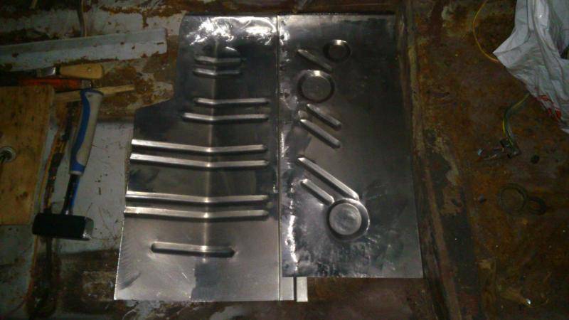

DSC_0236.jpgAnd here is a new floor pan on its way in, a friend of mine maked all four new floor pans for me :eek:s_dancing2:
Just don't forget to eliminate the cause of this rust spot, probably some water leakage. :)

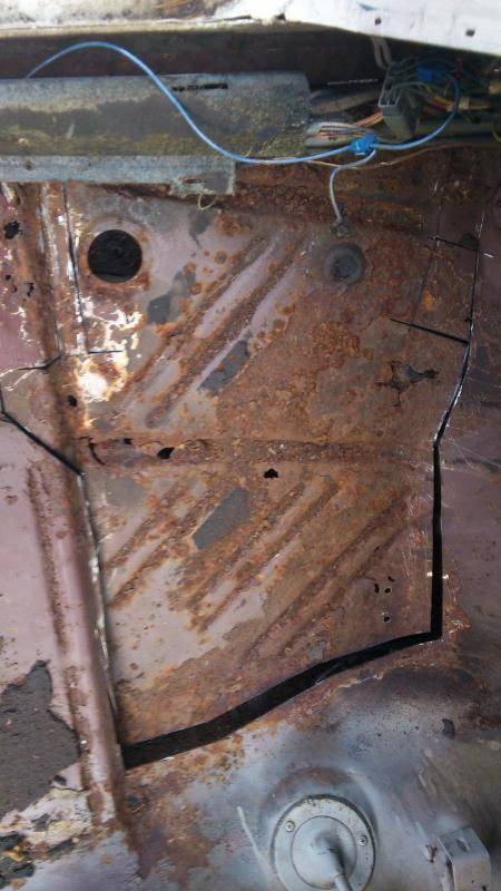

Do you mean what tool i used, its an electric hand held high speed one, its called Angel Grinder Power Tool.

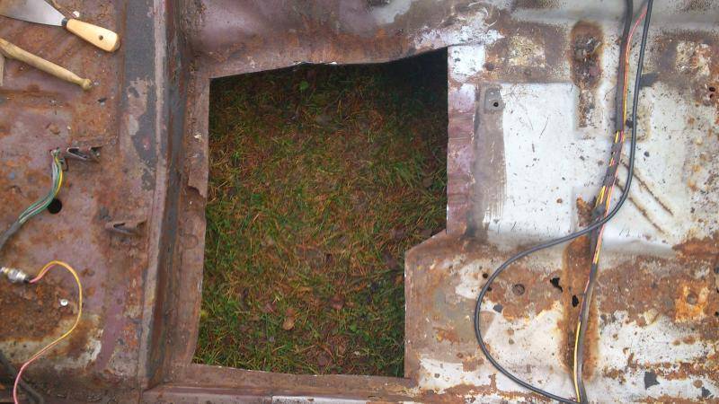

The scary part is after you cut the hole, you think SCHITT, that's gonna be a bigger patch than I thought....
Than i took the parts i cut out to my friend and he made new parts looking like the old ones, but a bit bigger format so its possibel to adjust in the holes i made. Than simply cut right tru the new metall and the old at the same time, a bit then spotweld an than cut more an spotweld and so on. When going round, than simply weld ewryting nice. After that a beer taste nice....:eek:ccasion14:
