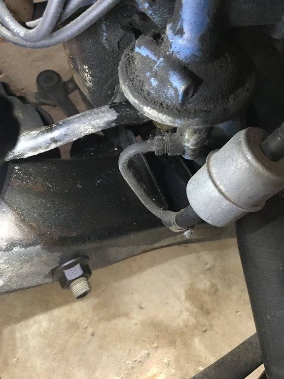

On my way to searching out the oil drips from my New Yorker I ran into this
The picture doesn't show the severity, but a major drip/leak from the worn out rubber gas line kept me busy replacing the rubber line today.
