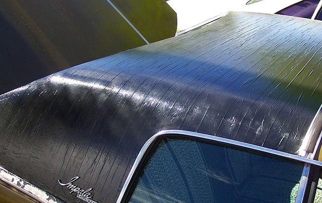

bear with me here it's my first time doing this, it will be far far far from perfection. i'm not worried about it, i'm having fun with my car

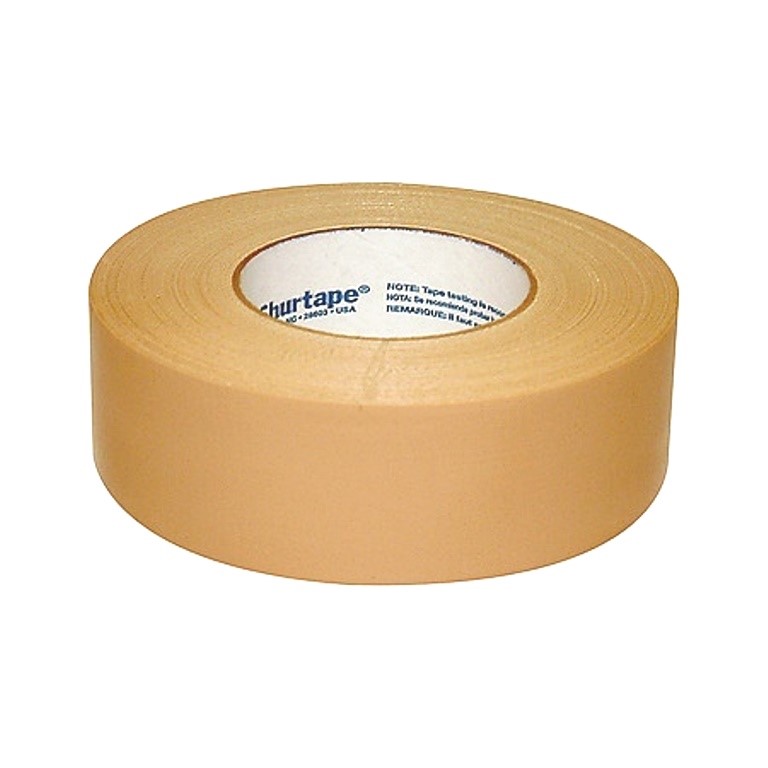

granted i didn't really need to tape it off so early in the process, but i did it anyways
metal is thin...
the rust treatment melts the plastic cup O_O lol
thanks to this video i totally didn't know about denting the rust holes #thumbsup
used short hair bondo
used jb-weld to fill in the seams
ran out of time to put a lick of paint on
just doing one spot at a time going to enjoy doing this body work thing

found the leak to my trunk around the lower rear window/trimings
i know it's not much to look at.
first goal for my body work is to stop the trunk leak and that leak also answers my question on how water got into the cabin and rusted out one of the rear channels for the back seat frame and some of the lower seat frame :-\ but that's good to know at least :thumbsup:
