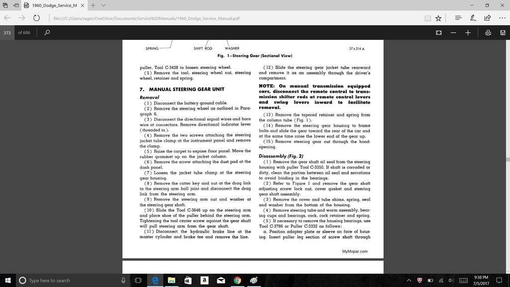

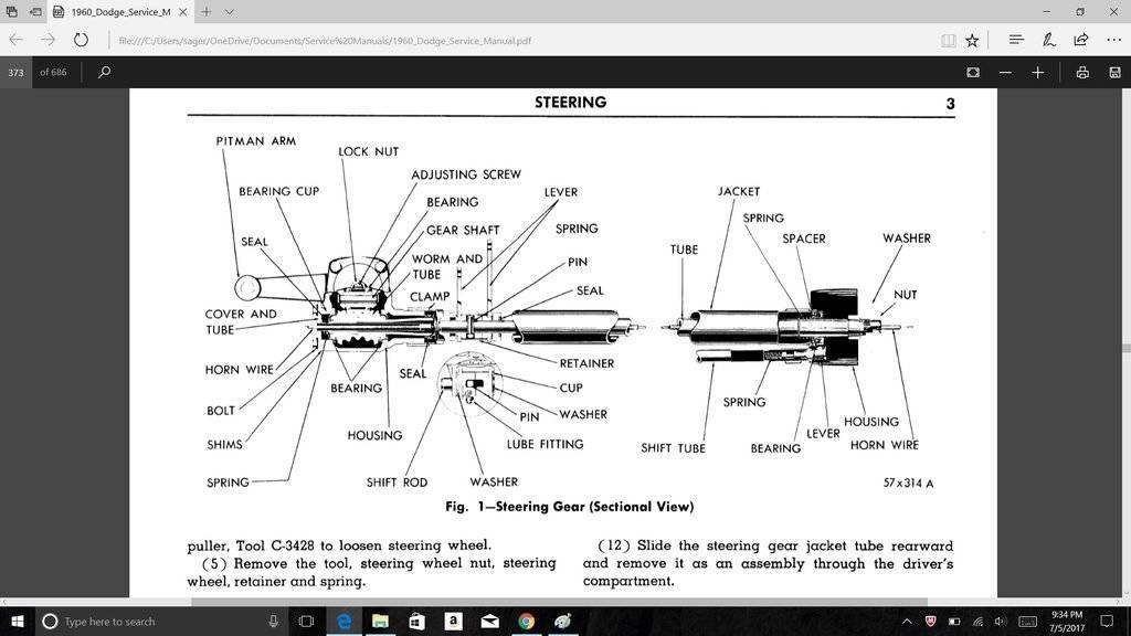

The way I'm seeing this gearbox is that the shaft is hollow (designated as "tube") and goes directly through the gearbox. I know the one in my 53 Windsor is similar, if not the same. The shaft is hollow and the horn wire travels down it and out the end.
Then I reading this as removing the gearbox and shaft (tube) as a unit, taking the column jacket off and out first.
Then I reading this as removing the gearbox and shaft (tube) as a unit, taking the column jacket off and out first. View attachment 131854
It's the same in the 60 Plymouth manual also. Getting the pitman arm off the gear box is the toughest part of the procedure. Note the manual trans paragraph.
