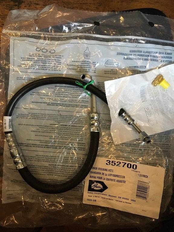

My new Gates pressure hose has just arrived and looks correct and better than I expected.. the step down in hose gauge(from the center coupler) is correct, which was cause for concern as it was not apparent in the stock photo advertised. All bends and angles look good too. Appears to be a well made product.. I will install soon and report back.
View attachment 140533 My new Gates pressure hose has just arrived and looks correct and better than I expected.. the step down in hose gauge(from the center coupler) is correct, which was cause for concern as it was not apparent in the stock photo advertised. All bends and angle look good too. Appears to be a well made product.. I will install soon and report back.

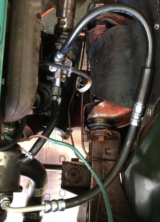

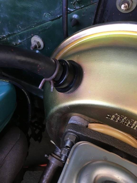

I have just replaced the pressure hose and it fits like a glove.. I've even reused the sliding foam sleeve from the factory hose.

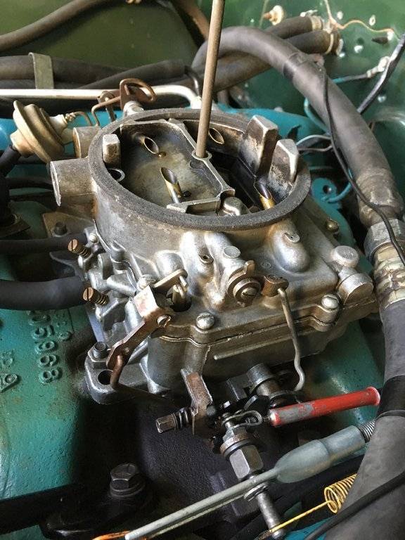

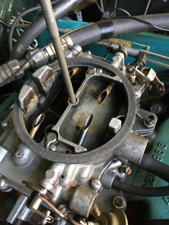

I've just set up my vacuum gauge on the manifold, and have got my timing/dwell/rpm gun all hooked up too. But, before I fire her up, while she's cold, I'd like to adjust the choke on the carburetor, and Im hoping someone reading this could assist me in doing that. Right now, the choke valve/butterfly is completely closed by spring tension.. I can push it open by hand against that spring tension, but would like to know how to set it properly where it will open when fully warm, and click shut as I depress pedal to prime when cold again. This is an auto with a divorced choke (thermostat coil in the manifold).. Ive been looking in my FSM, youtube, forums, and still do not understand how to adjust this.. any help would be greatly appreciated!
View attachment 140670 View attachment 140669 View attachment 140668 View attachment 140667

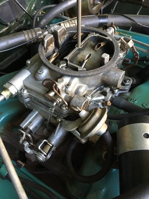

On Wednesday I installed the new pressure hose, and when I went to fire her up, she cranked but would not fire. Flooded.
I examined the carb and found fuel dripping from the mixture screw and primary throttle shaft, but ONLY on the drivers side of the carb.. it was filling up with fuel on that side, but why? What happened since I drove her last?
So I removed the carb again and took her home to go through again.

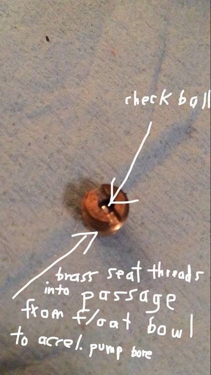

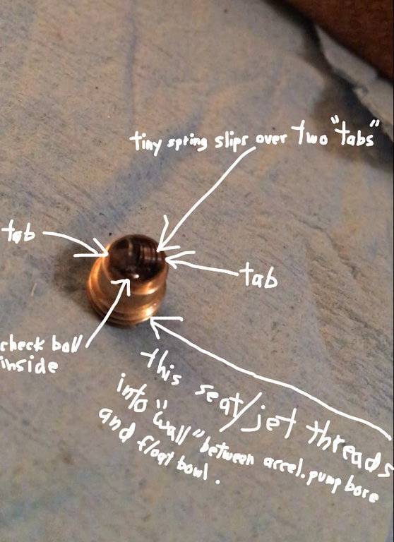

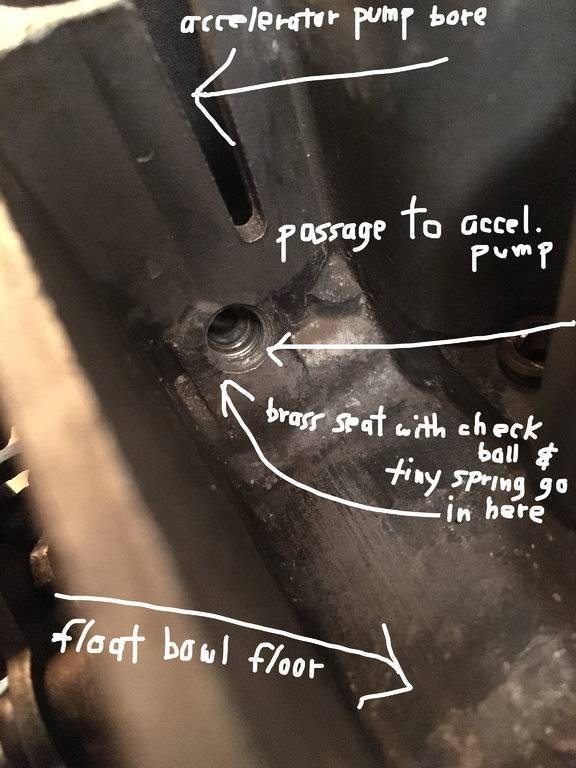

I then decide to pull the brass seat/jet that screws into wall between the float bowl and the accelerator pump bore(pictured). I found This "seat" has a little check ball inside, and there was also a tiny spring attached to two little tabs across the diameter of the seat(on the float bowl side)..
I can't help but wonder if when blowing air through the passage during my rebuild, that maybe this spring spun around to its current position, causing the ball to block fuel from circulating into the system and flooding out that side of the carb... ?
Question is, do any of our great C-Minds know if the spring pictured is in correctly? Should it be straight in the seat(run the length of the seat), under the check ball on the other side??
It is a riddle google has been unable to answer.. and I thought you all might shed a light.
What is the correct position of the tiny spring and check ball pictured inside the brass seat..
The carb is put back together and I am back at the garage today(just now) and would like to correct it if necessary before reinstalling and potentially flooding out again.. otherwise, I can't imagine what is causing the flood out.
ps. hope you enjoy the handy diagrams.
