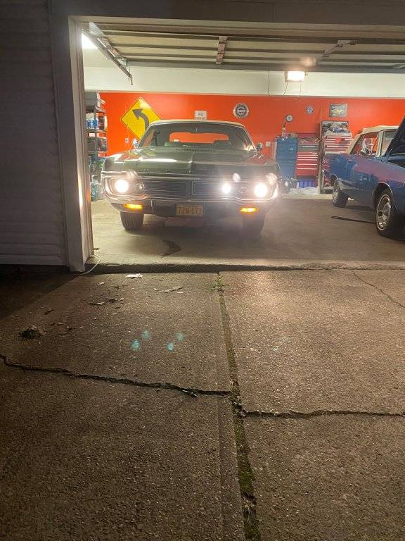

Here is a picture with it on in the garage:
As mentioned above the lights are not aimed. Ill take another photo when I get them aimed. I am also in the process of getting a headlight relay kit made to include the superlite to be run directly off the alternator or battery. The bulb is the new custom one that @slantsixdan had made here

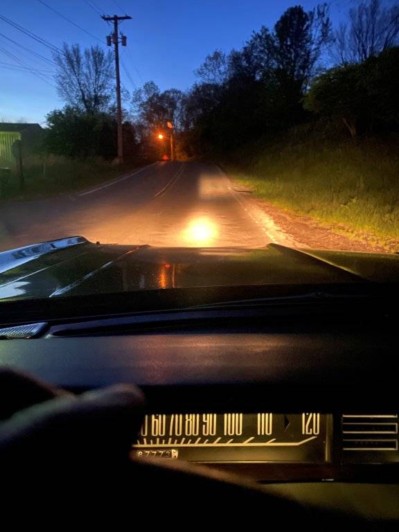

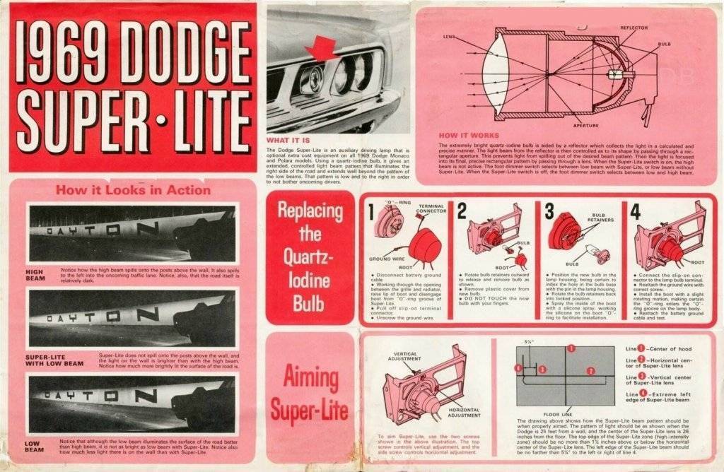

So I was finally able to finish up the lighting upgrade on the polara. It involved getting a custom headlight harness made by Rob Yule that included a third relay to run the superlite directly off of the alternator. I used headlights spec'd out by @slantsixdan at Daniel Stern Lighting. I also followed his tech tip on how to aim headlights here, and used this article on how to aim the superlite:

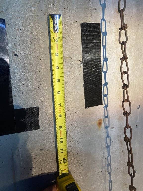

It worked out really well!! I have done some night driving and the light is pretty useful. I have not done much highway stuff with it but will in the next couple weeks. here are some pictures with the superlite on and off at the end of my street:
On
off:
again this is with the bulb that @slantsixdan had made. I provided a link in post 84. But if that link gets broken I believe you just take a good H3 bulb, remove it from its base and place into the superlite bulb's base. you move that bulb further out and in the base to get the proper focal length. For future reference if anyone actually tries this the beam should be able 8 inches high when the car is 25 ft from a wall.
