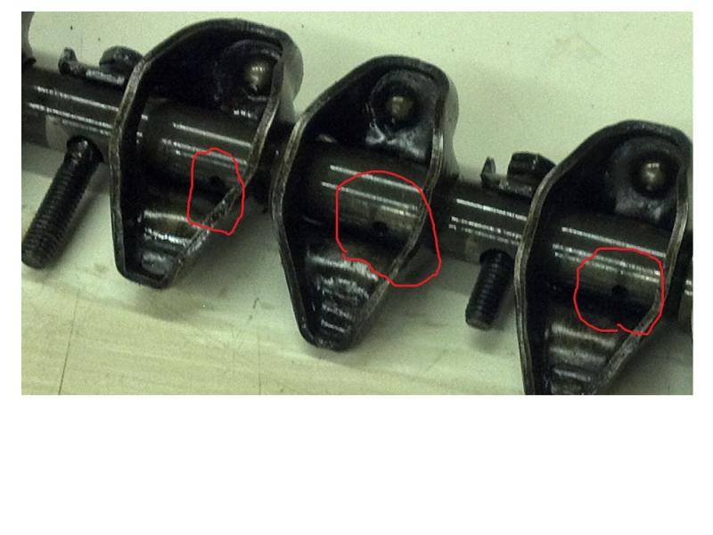

I believe I installed the rocker arm shaft correctly. Here is a detail shot right before I reinstalled it in the car. Rocker arm shaft detail..jpg

I would almost certainly say the top end isn't getting lubed. Pull a valve cover while it is idling to check. If it isn't, pull the distributor and prime the pump while turning the engine over slowly by hand. The top end is fed through the #4 cam bearing by way of two small holes. It is very possible the top end isn't getting oil because the car sat for so long. Congrats on bringing her back to life!
When installed, the oiling holes should be on the underside of the rocker arm on the valve side.

Scott: he said he didn't pull the cam so it should still be pushing oil up there. So I'm thinking something was not right when the rocker arm shaft was reassembled and put back on.

Could be, but if the engine was completely dry, wouldn't it have to be primed to get oil to the top? Maybe not. Either way, the top end sounded pretty noisy to me. You could be right about the rocker shafts being installed incorrectly. He should be able to pull a valve cover after running it to see if oil is getting to the top. If it is, my money is on your assessment.
You may have something with the rocker shaft I was very meticulous not get the rocker arms out of place. I'm not certain about the shaft it could be upside down. The push rods and everything else I feel confidant about the installation.

I'm a little confused so the holes should be pointing up toward the rocker arms or down to the valves?

Thanks for the tip, both sides are noisy. Funny stuff I'll keep the shiny end down.

Stan has it right. I over reacted.
The valves sounds really loud on the video and they were that first time I started it up. I went over and removed the valve covers and everything was installed correctly then started it up. I was surprised how quiet it sounded. I shot some video and when I played it back it sounded much louder. I blame the camcorder and short term memory loss.
