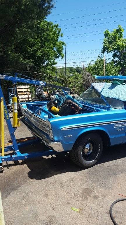

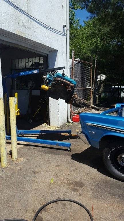

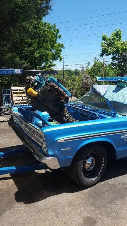

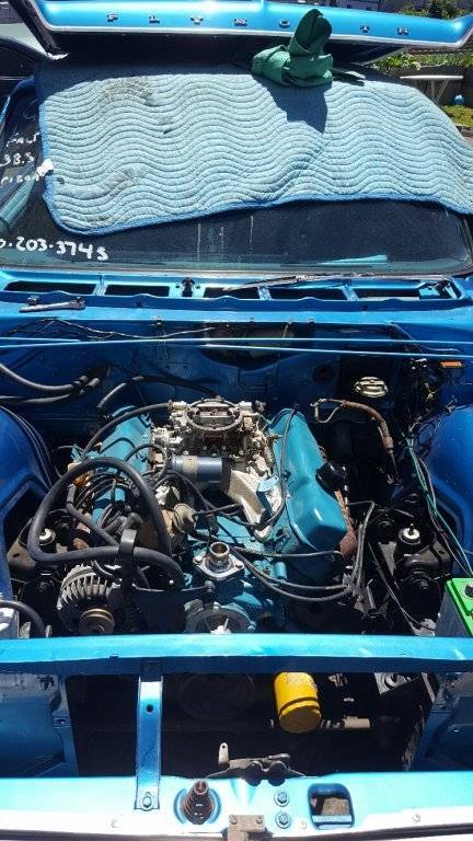

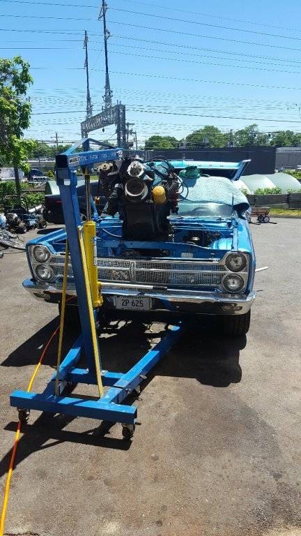

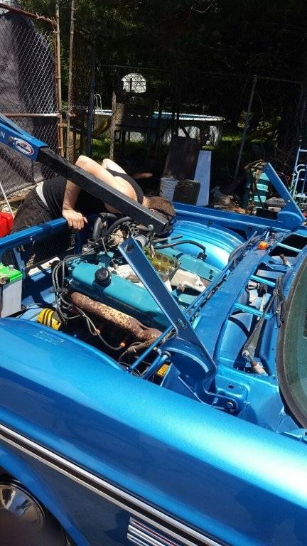

You all have helped me out with the engine choice for my '65 Fury (replacing the 383 with an already done 440), and I was told that pics would be nice...so here are some. I pulled the engine this past Fri, and here's the evidence. It went smoothly, thankfully. I should have the engine by the end of this week, and I'll post some pics of the prep and install when I get to it (shouldn't be too long).

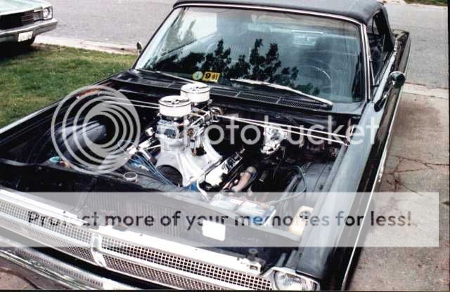

Years ago, I had a '71 GTX with the 375 hp 440. A wonderful car I never should have let go. The power of that 440 had was amazing. You wanna pass 12 cars in a row? No problem. Just punch it, and you were there. Prior to that car, I had a '66 Belvedere II with a 4-speed and a 426 street-hemi. The GTX was faster. . .
Believe it or not, the tunnel ram really was pretty awesome on the street. Now the car had a mild cam, manual valve body trans (no kick down linkage to sweat over), 3000 stall converter and 3.91 gears. I mounted two 600 Holley (vacuum-secondary) carbs in-line to simplify throttle linkage (used a long throttle cable from a 72 Dodge truck slant six). Once it was mechanically together, it was just a matter of getting the accelerator pump shots/timing straight and awa-a-a-y-y we go!
The hardest thing to do (emotionally and physically) was cutting a hole in my hood to clear the carbs.
I 'temporarily' installed it around 1990, just for laughs after I took a ride in a friends Pro-Street Chevy II with a small block & tunnel ram. I figured, it he could do it.....

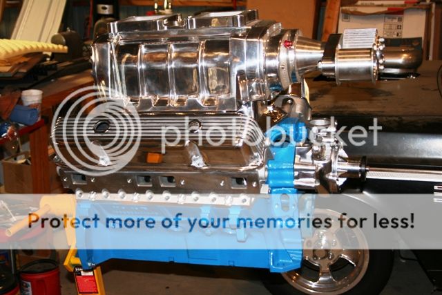

I have had so much fun with it, I am only now getting around to taking it off (being replaced with an 8-71 supercharger).

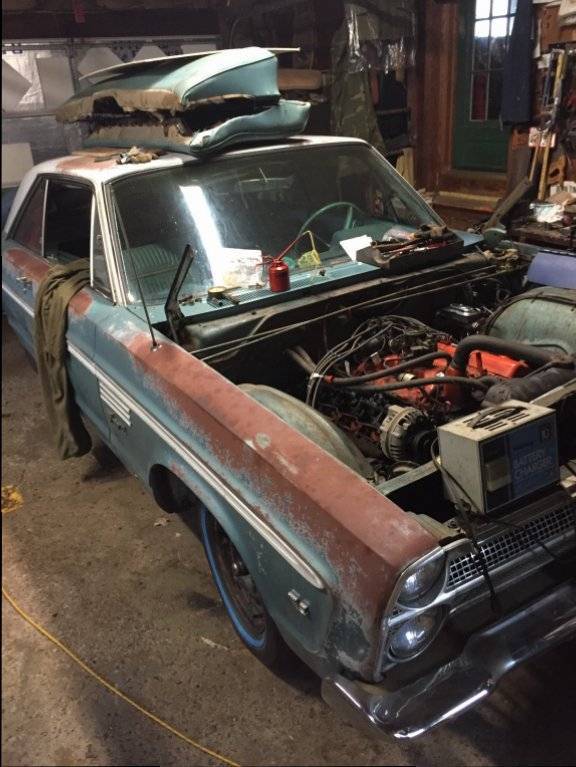

I also am planning on putting a 440 into my 65 Fury lll. I had the engine long before I found anything to put it in. My engine also came with a dual Quad tunnel ram. I think this would look awesome on the street, though I am told they have their issues on the street. But I am still going to try the tunnel ram and leave the hood off for now. Your post gave me motivation to continue with my project. I am 58 years old and have started my semi retirement project. Thank you again. I will follow your project. Included is one photo as we sit in my garage in western New York.
Flippin through the pics and bam, there it is. 4 speed! Cool car, looks very nice:thumbsup: Where's the burnout emoji??
Travis..
Nice looking car! Good luck with the install and congrats!
