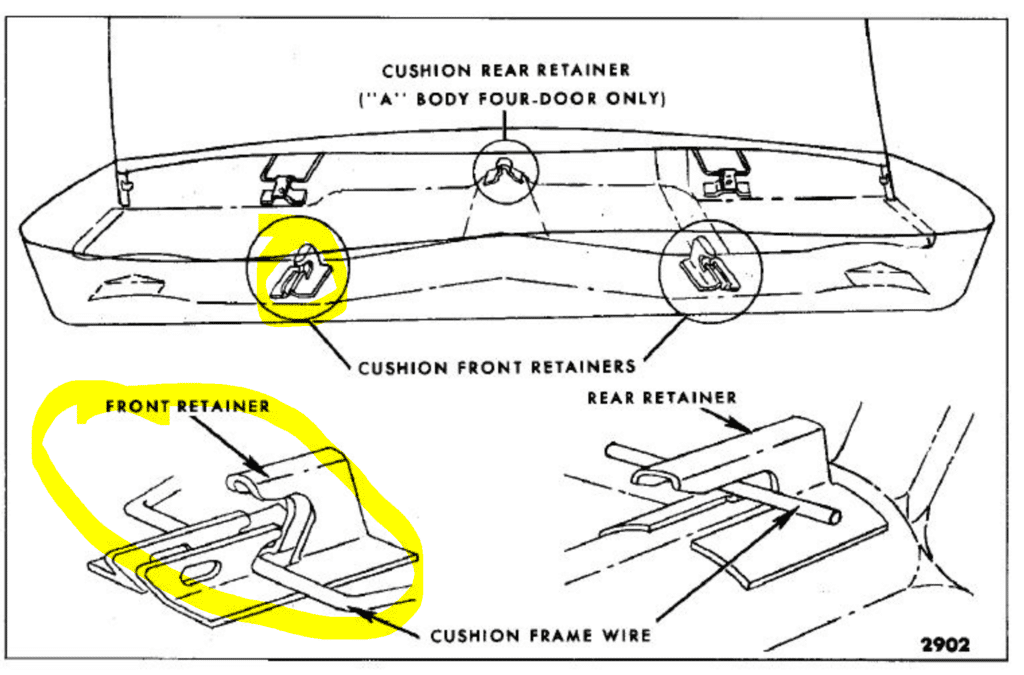

    The rear seat comes out from inside the car. Lower section needs to come out first. Push it back as far as you can and then lift up and pull forward, that should disengage the catch on each corner. The upper seat section is held in place by a bolt on bottom corner on each side. With bolts removed, the seat will lift out. With the seat out take a flash light and locate the trunk latch. It is held in place by two 1/2" bolts. You will need a couple of 24" extensions to reach the bolts.

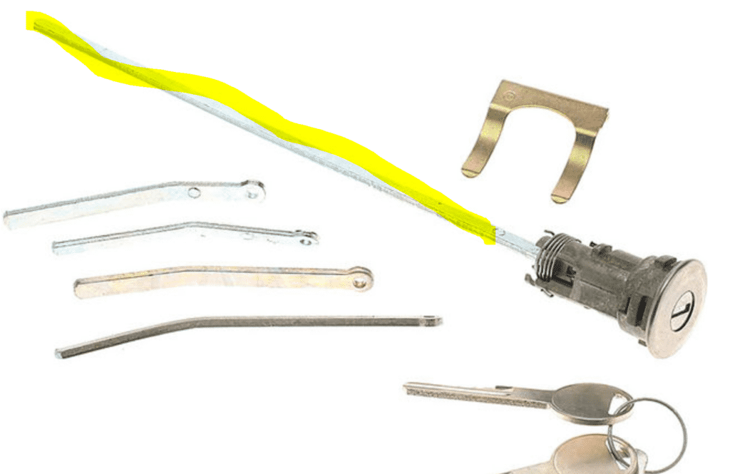

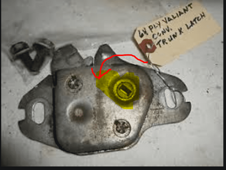

    When you push the seat bottom back, there will be tension pushing the seat forward. You'll need to hold the seat back as you lift up on the front of the seat cushion, similar to this.
    If the problem is that this bar has come out of the lock set that slides through the latch.
    You won't need to remove the latch, you only need a flat blade screw driver and you can simply stick it in the latch and turn it counter clockwise when you're looking at it from the back seat.
    Good Luck

    How do you turn the latch when the lock cylinder is connected and it does not turn?
  6. has2bmopar
    has2bmopar Senior Member
    Messages:
    1,466
    Likes Received:
    555
    Joined:
    Feb 7, 2012
    Location:
    midwest
    Pull/slide the lock retainer out and pull the lock assembly out. Then you can use a screwdriver to turn the latch.

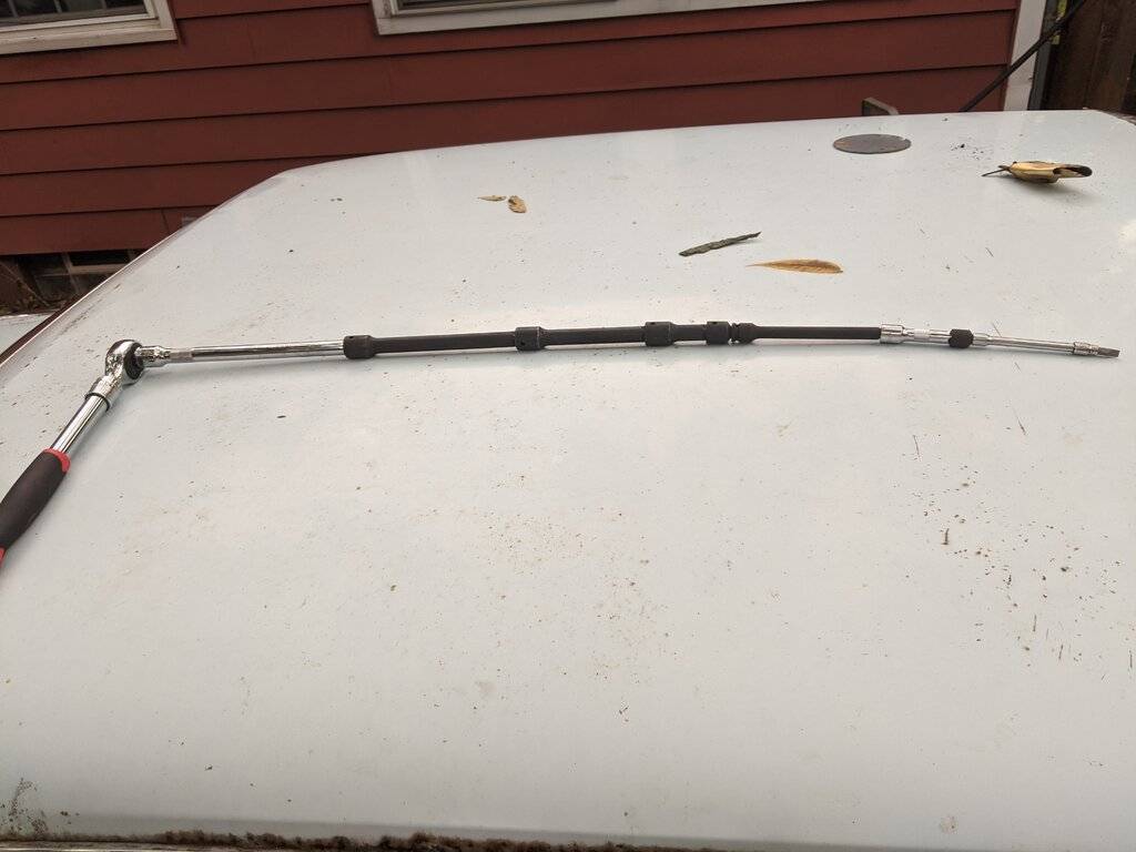

    Thanks guys, I had just enough extensions plus my arm length to open the trunk!
