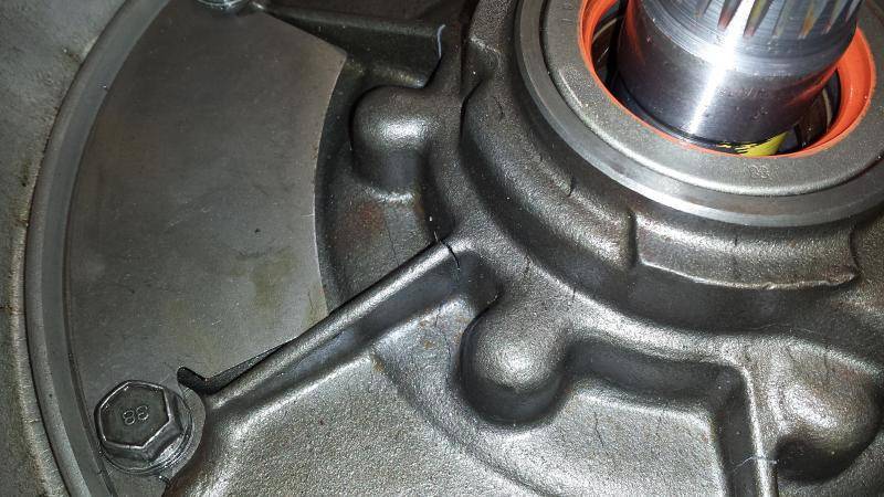

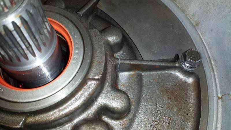

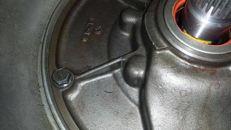

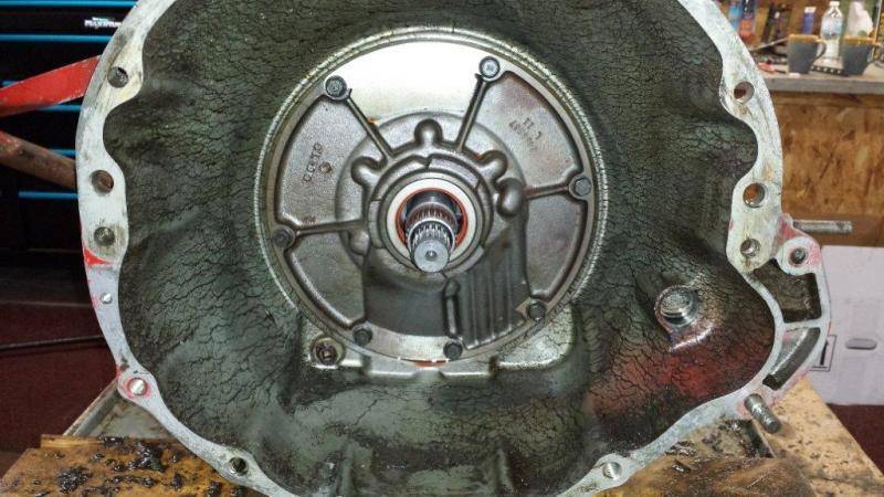

Sorry that the pump is cracked, but glad you got it sorted out. Post some pictures if you can of the cracked pump. Like to see it.
here is what the broken pump looks like.
It was my fault and somehow I didn't strip the threads in the trans housing.
I tried the fix by having the transmission laying on the bench & in the past I have tipped it on end.. Lesson learned..
The cause of this was that the front drum had popped forward by about an 1/8 of an inch then turned enough to prevent the pump from sliding all the way back into place.
The tranny mechanic suspected a weak casting as I should not been able to break that pump.
I guess I ate my wheaties that morning! :D
Lucky though I had a spare pump which is now being installed..

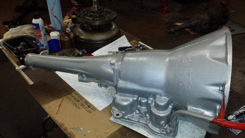

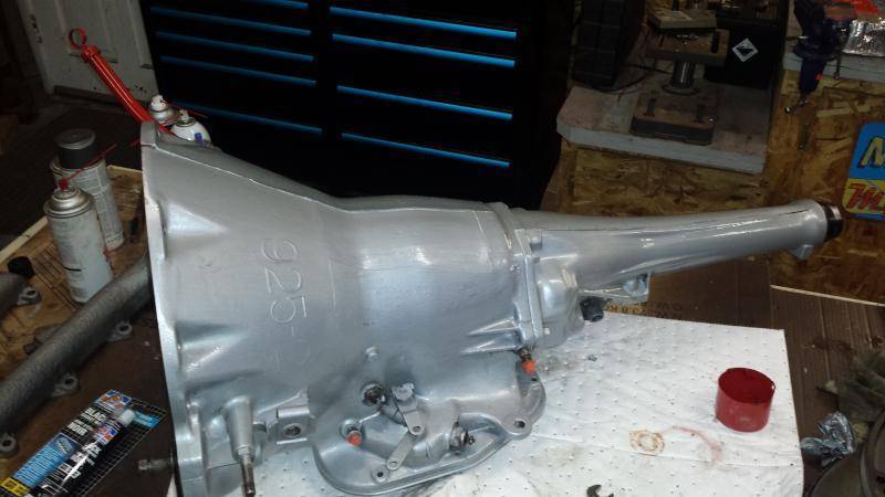

So, it wasn't seated when you cracked up the bolts. That sucks, but glad you had a spare! You plan on painting it before you put it back in? Are the trans techs going over it, replacing anything else while it's out?
I wasn't but I found some aluminum paint tonight and before I knew it...
Turned out pretty good.. I used a brush and put it on real thin..

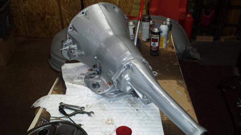

Your trans came out great ! So you say you used a brush what brand type of paint is it? I only see spray bombs in the picture. I'll be painting my trans soon and I like the look of that. Does it have a glossy finish?
It is Tremclad aluminum and I used a cheap 1 1/2" paint brush.
I used very little paint just enough to literally cover the aluminum housing.
I more or less scrubbed it into the aluminum which is naturally a bit porous.
It has a shine to it as well.
This is the first time I used it on a transmission.
Bought the paint for a tin shed roof.
It stood up to years of summer heat and different seasons so I figured that it could handle being applied to a transmission.
I expect it will eventually turn into a power over time but the shed roof took it for over 5 years so I will see what happens..
I'm sure some members will think I messed it up and state i should have used an auto based paint but the Tremclad is oil based
We'll see what happens :)

I think that from the picture you can see why. ..
