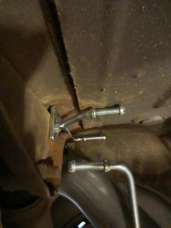

Yes, same here on the passenger side. The hanger will bolt into the original holes on the driver side OK, but the "tabs" for the insulator are flat against the bottom of the trunk floor. There is no way the insulators will go on.
I'll probably just redesign the bracket to fit.

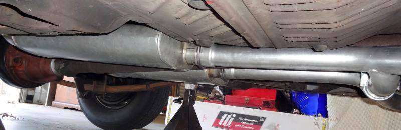

The tail pipes slide in from the rear just fine. The instructions say start from the rear but I think that is misleading. From the manifolds back worked best for me.
The reason for starting at the back is that it is much easier to get the tailpipes on the hangers. Once they are secured on all 4 hangers the mufflers hang on nicely and are held in place, then the H slides on, and then the front section just pops in, then tweak and clamp. YMMV.

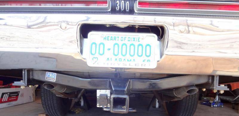

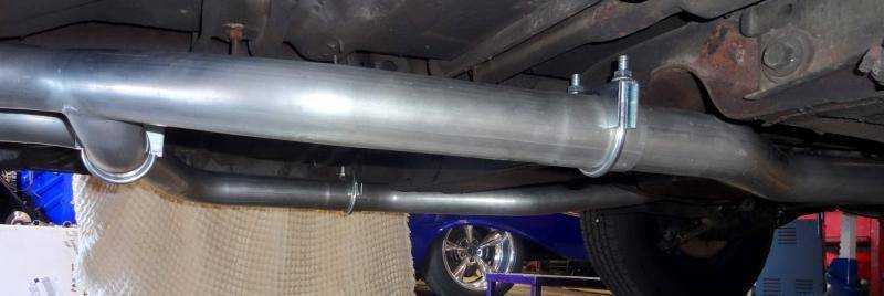

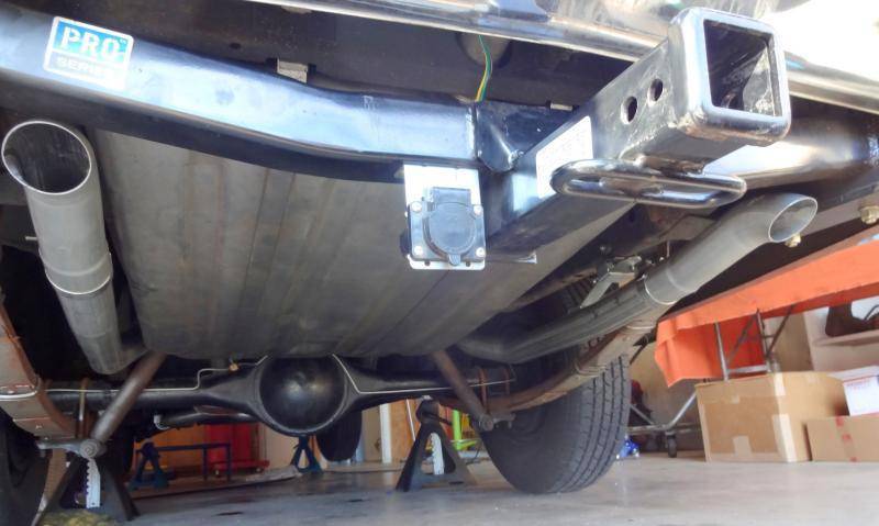

I finished the exhaust system on jazebelle today. I'm really happy with the quality of the TTI system. It was not quite the "bolt on" installation they claim but nothing a little tweaking couldn't overcome. I did need to shorten the tailpipes by 2" to work with the hitch. Now they will look good with the hitch installed or removed.

Good to know the TTIs worked out well, would you do them again knowing the few trouble areas?

Knowing what I know now there really wasen't a issue with the TTI system. It was more of a variable in the car manufacturing.
I sent pic's to Sam at TTI and he said it was suppost to go that way but the hanger bracket was against the trunk floor, not that way on the cars he had pic's of in his file, A long pry bar allowed me to make the needed adjustment.
I would definitely recommend the TTI system.

Who manufactured hitch?
I made the hitch myself using a commercial class III hitch and designing frame and end brackets to fit the car. It's designed to attach using the bumper bracket to frame bolts, I didn't drill any new holes. I can have it off in 10 minutes with no indication there was a hitch present. (well.... except for the lighting harness which unplugs and tucks up behind the bumper.
Cool thing is that it will also bolt right onto my new 69 fury custom Suburban also.

The system looks great...and you did an excellent job installing it! But I did shake my head at the use of the old hoop muffler clamps. :(
