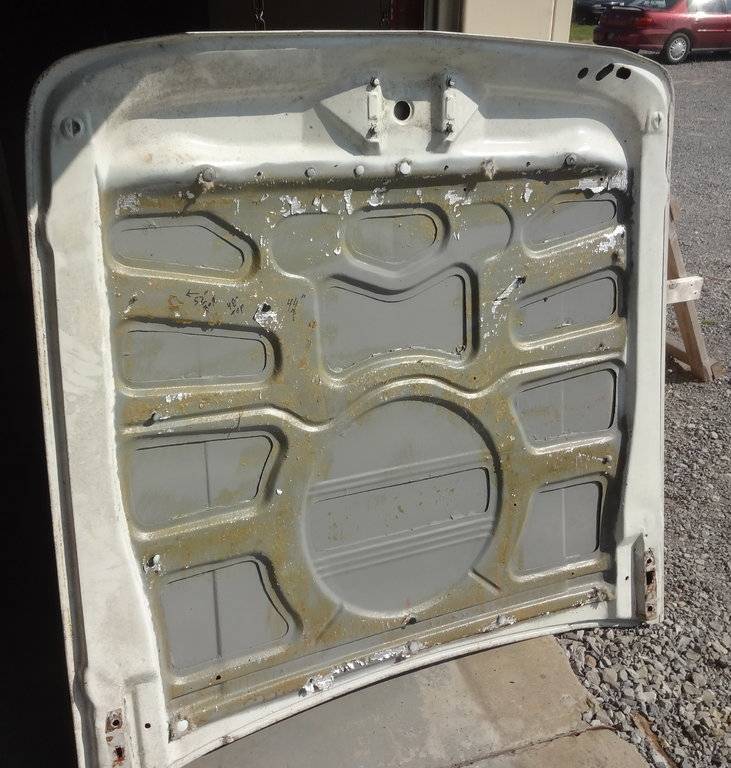

Funny thing. Mopar did not paint the under hood, interior cavity, trunk area and under trunk lid body color. It was finished with some sort of sealer with a grayish/green satin appearance no matter what the car color. I think I have enough that survived to come close to duplicating it.
Almost looks like they masked that off.
Wil: I think you oughta clean up the underside of that hood and leave it original. It really doesn't look that bad. . .
There was some sort of jute pad attached before painting. None of the white paint is original to the car.
There are several areas of the "unpainted" finish that were not effected by UV. My painter says he can scan and duplicate it. It's very close to what a epoxy sealer looks like.

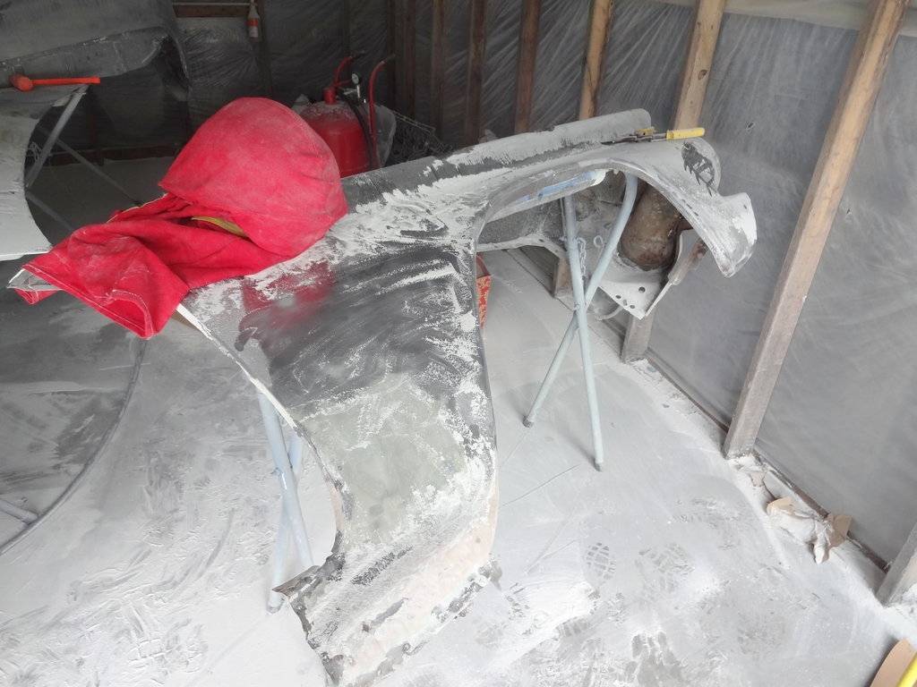

Not much more forward progress on Virgil. Just trying to strip the parts already removed and determine what needs to get done in what order.

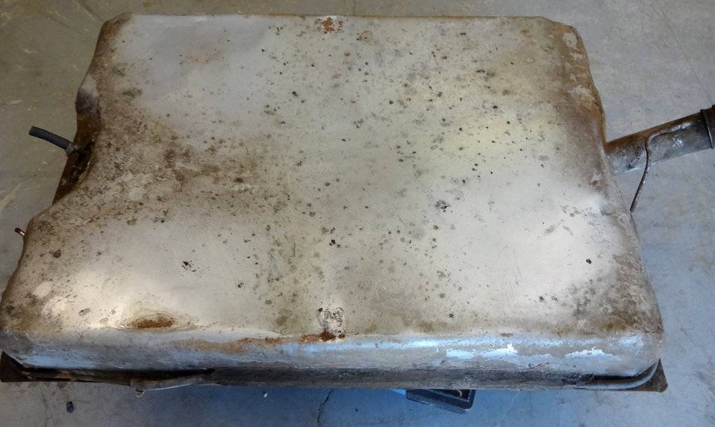

I dropped the fuel tank and the entire top of it has been replaced, add a new tank/sender to the list. I received the last three pieces of the front bumper from Tri City Plating but haven't unwrapped them yet. I have no doubt they are nice. Lots of money going out and boxes of parts coming in.

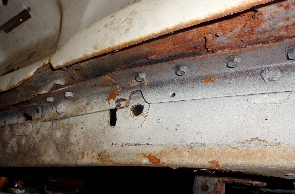

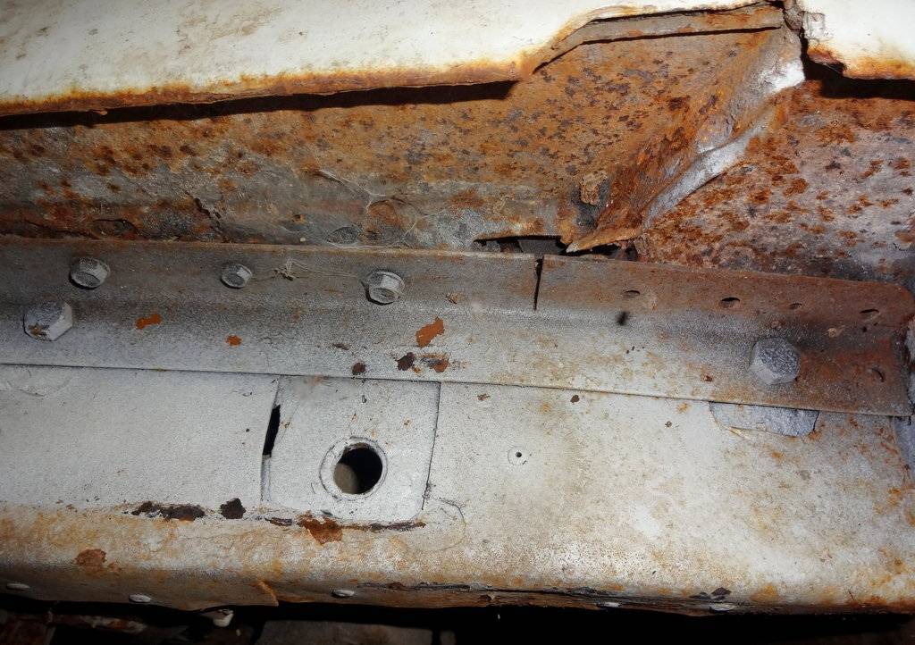

I dug a little deeper today and found some nastiness. The right rear of this car must have resided in some dampness for awile. The lower rear section of the rear light panel is a mess of metal patches riveted, bolted and bondoed together. Now its a new trunk floor AND complete rear deck opening lower panel......... Already sourced.
