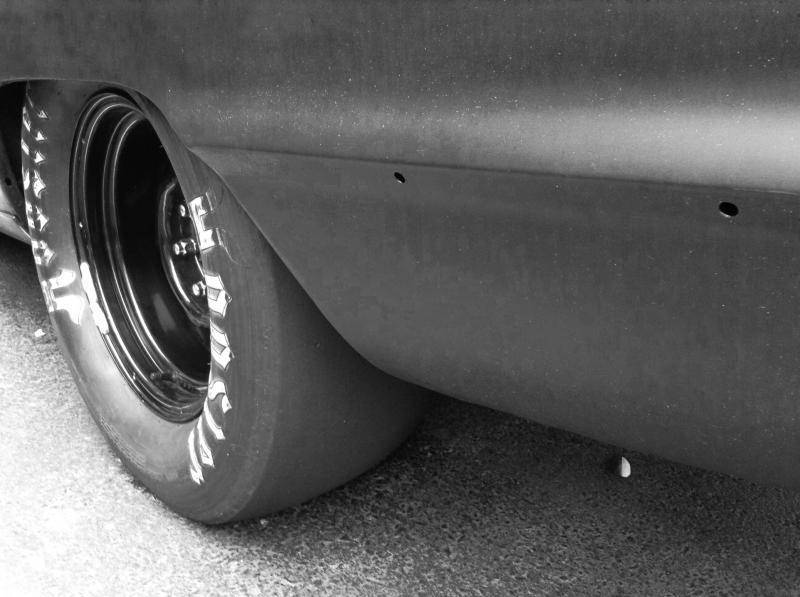

I'm using 15 x 8 w/ 4.5 back space on the rear w/ 275-60 15 coopers on my 66. If you can find 5" back space you should be able to go with 295's. Skirts won't clear my tires.

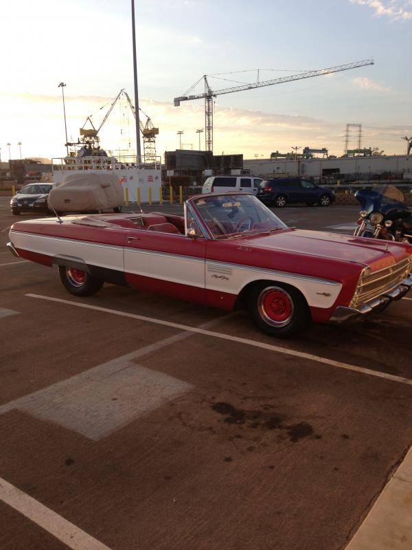

I have a set of original 15x8 76 to 78 only RamCharger wheels on the rear with 4" backspace with 28x10x15s on my 66 Sport Fury. The only mod I needed to do was trim inner fender well lip back 3/4 of an inch. I have no plans on ever putting the skirts on again, so it's what I did and IMO, the car looks badass! Gives the car that nostalgic look. I'm ordering a set of Nitto NT 555R Drag Radial 275/60R-15's. They are 9"s wide and will be perfect for what I need. So, you'll be safe at either, 4",4 1/2 or even 5" backspacing. There is a lot of room back there on our Fury's. To be honest the 4" backspace looks the best as it brings the tire out that 1/2 and the tire fills the fender well perfect!

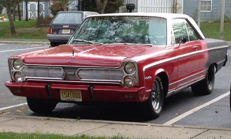

Man that DOES look awesome! I have a set of slotted Mopar police rims (15x7) on my 64 Fury vert and they fit well all around. I believe they are a 4" backspace. I love the old school look they give the car, and you can still find these pretty cheap.
Yeah these wheels are common, but are cool wheels too. The ones I have are really hard to come by.

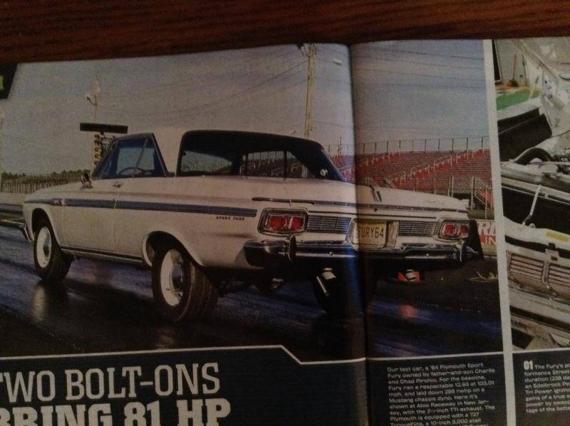

Cool car BTW. Always liked that year, plus it's a B body. You planning on painting it? Car would look great in red or white with the interior it has. Here is my buddy's 64 Sport Fury, AKA, "Balls of Fury". This car is going to Atco this month and will be in MOPAR Muscle again after the test and tune. They rented the track for the day. My buddy Dan Foley is the one who built the cars drive train. Car should be in the 11s now. The car is beautiful.
that looks bad ***...now I have a good idea of how to go with my convert to give that street muscle look...

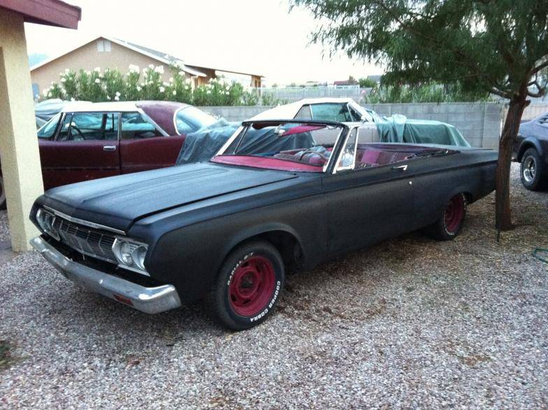

That's how she sits right now...but I'm going to hunt down some wheels and give her a little more attitude
Wow, cool car man! First thing ya gotta do is ditch the skirts. For now, spray the wheels gloss black and keep the trim rings on. Will look much better IMO. What drive train does it have? That is a Sport Fury? Looks to be with the buckets! Very cool..!
Yea I ditched the skirts...I'm running a 383/727 with 3.55's...I just put on a powerjection unit...still working out some fueling issues with the new FI but should be done this week...and yes it's a sport with the buckets...I think when I get the new tires I'm going with the white letter outside...
