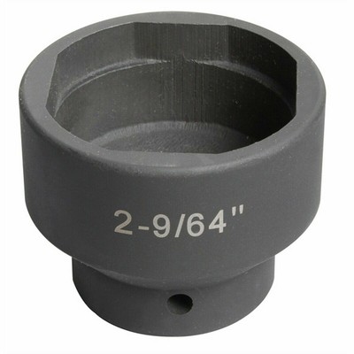

There are 3 ball joint sockets that were used in the 60/70's.
There's some caveats here, but this is close.
Pre-73 A-Body uses a 1 13/16 socket. I've also seen these sockets listed as 1.809", which is an RCH under 1 13/16" Later A bodies (I think) may use the B-body size, but I've heard it both ways.
B-Body uses a 1 7/8 or 1 59/64" socket. Both work... just some socket companies added an extra 1/64" (or .015") to the socket size. I've had people tell me they've used a B-Body socket with no problem on an early A Body, but it's sloppy and you need to be a little careful.
C-Body uses the largest 2 1/8 or 2 9/64" socket. Again, that extra 1/64" on some sockets.
I found there was a tad too much slop with the 2-1/8th socket for my comfort when dealing with that nut that required 3 men and a boy to break loose. I highly recommend going that 0.08333333333 inch.

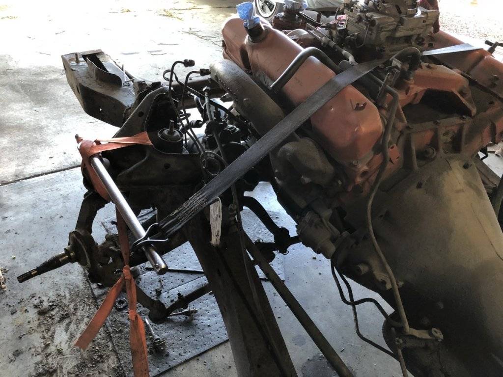

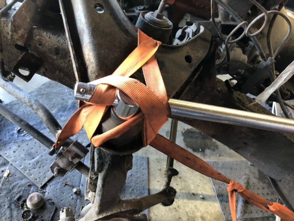

I typically work alone, same idea, one strap to hold the socket down, the other to keep the bar in place, then a couple good hits with a 10# sledge and it was loose.
I then pulled the control arms and took them to work where I could put the control arm in a vice and use their 3/4 impact, still took some effort.
Previous car my 1/2 impact was good enough.

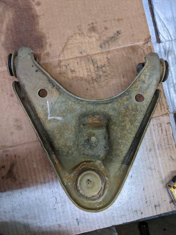

Hi John,
I bought the Sunex 2 9/64 socket. It's way too big for the upper ball joints on my 1971 Fury. Also, too big for the Moog K772 replacement ball joints that I bought. My 1971 ball joints measure a little less than 2". Do you think Mopar downsized C-Body ball joint head size to match B-Body so that 1 59/64 would work?
Thanks, Ben
1971 Fury control arm
Rock Auto has your uppers. Just checked. Get a 1 59/64" socket, and ball joints and you'll do fine. Be GLAD Rock got some Moogs too. Grab them while they have them.
I have a Wright 6888 socket That I originally purchased for a 73 Barracuda I had at the time, it fits my 69 Polara perfectly.
It measures about 1-59/64
Alan
