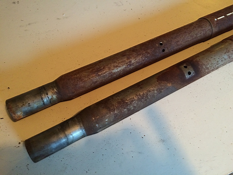

    There are no slip joints in the collapsible column, at least not that can be inspected by slipping. The sections are fused together with plastic plugs that sheer on impact, only the outer housing actually crushes.
    This is the shift tube on a 69, you can see the sheer pins in the upper right corner of the picture on the upper tube.
    [​IMG]
    Alan
