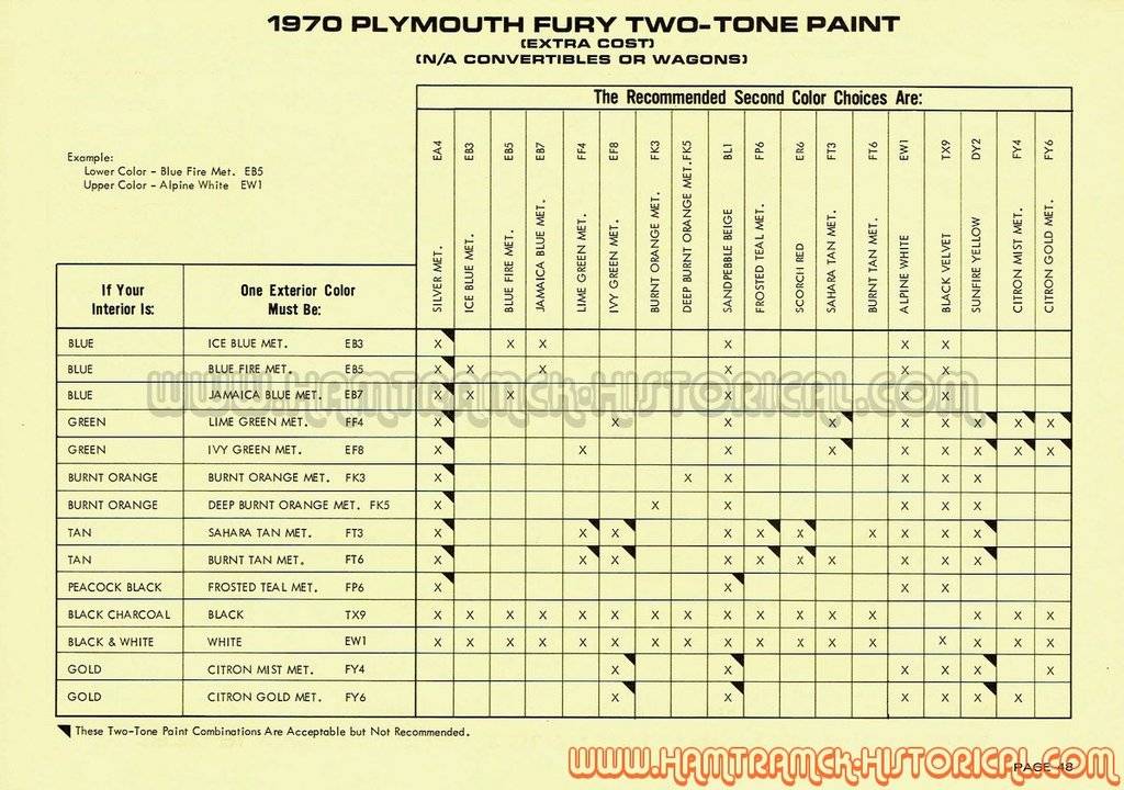

Just gonna toss this out there.... You could also get the car as "two-tone", so you could paint the top in a complimentary color and leave the molding from the vinyl top in place.
Thanks Big_John, I never knew two-tone was available on '70 Fury.
In fact, I think I never saw one.
Rarely ordered for sure as this was Long gone out of Fashion strarting with the Advent of the Vinyl tops around 1963, not counting the first Trials by Ford and Mercury in the early 50s. I'd prefer two toning over the Vinyl top anytime if you think you'd have to add some pizzaz to the car.
