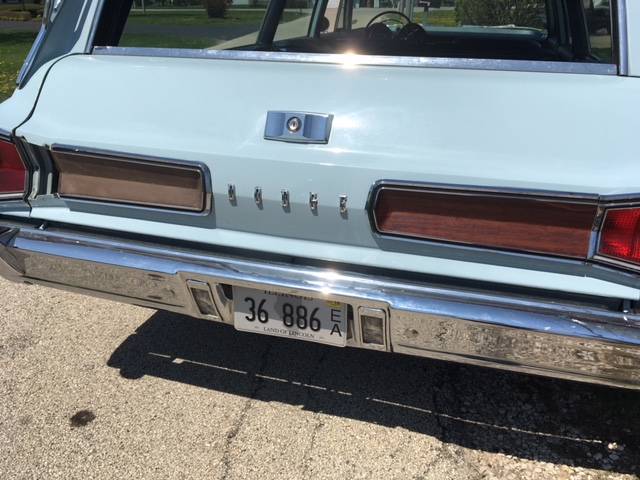

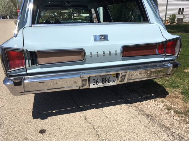

Finally started to tackle the woodgrain. I took the trim off the tailgate to do the small sections as a test for both how to remove the old woodgrain, and installation of the new woodgrain. I tried heat and adhesive remover to no avail, took to sandpaper and cutting/buffing the paint. Pics are the first attempt on the right.
ONCE you start, no turning back. Good that you started with the tailgate!

Have you made any more progress? The small panel on the tailgate looked pretty good. Did you pick the color on the right?
The summer (and chores) have taken precedent. I got both rear pieces done, but am not 100% happy. I thought I’d dwell in it for a while. I will need to sand the old decal, which will be a chore. I ordered 800/1200/1500 sanding disks but haven’t started as of yet.
Before you sand any more, I managed to revive my existing woodgrain...which looked worse than yours does! There's a thread about it...which I will attempt to find and paste :)
Refinishing Woodgrain on the 73 T&C
I appreciate the note and have watched your thread. Unfortunately, I've got severe loss of the actual woodgrain, so there are very large patches that are just brown paint. I did try restoring a patch with the clear spray this spring, but it did not bring out any of the woodgrain detail. I've had a lot of folks at the car show tell me I should just leave it, it tells a good story as to how original the car an paint is. I'm debating at this point, and probably will wait until next spring to make the decision.
