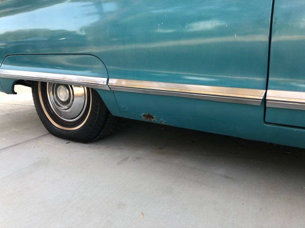

Sooooo the owner just sent me this picture, not sure how easy this is to fix?????????
I used to paint tugboats and this kind of rust was a pita, can I just get a welder to cut that out and weld on some sheet metal?
That type of rust shows through from an old repair done incorrectly. Basically, they stuffed it with Bondo and painted it. I would be concerned that the rest of the car has the same type of body rust and repair going on under the crappy paint job. It could be a nightmare.
Personally, I'd stay away from this one.
Hate to say it but yea, once it's clear that it's been "fixed up" at some point, if you are going to look at it, look CLOSELY. While I'm not one who'd say 3500 would bring you a car if this vintage with no problems whatsoever, a better starting point might only be a couple grand north of 3500.
Being that you were initially considering laying out 20,000 on tha 66, I think Somehwere in the middle would get you a more solid if not more honest example.

Yeah , but at this point how perfect of a car are we taking about ... this is already a rare car to begin with, I'm not on the east coast like most of you so at this point I need to get the best I can get.
I think if the car was repaired badly there would be other areas showing the same symptoms...
I think I'll be able to spot any bondoed areas , I have a good eye for that, no auto body Would fill up a bubble rust hole , so most likely someone amauetuer did it therefore an amateur Bondo job would be easily spotted.
I think my plan now is to offer a lower price somewhere in the 2k ball park, talk to the owner, check the car for mor sh1t jobs , Then get the rust fixed if its not too bad

I get what you're saying, around 5-6k for a solid car?
Lets say If i bought this car for 3k , then spent 2k to get the rust fixed ( not like it would actually be that expensive to do a few spots ) then you basically have a solid car for the same price, as long as the floor boards or frame isn't some how rotted through.

I get the feeling that this car has seen more than one shoddy repair and they do add up quickly. If you spend a little more time and money from the outset, you're likely to find something that either needs less work or is more clear about what it does need...
That car just looks like it's had too
many bandaid fixes for my taste.

Since I'm in the northeast, actually the snowiest major city in the country, I've seen many rusty cars... and I've seen many, many pros Bondo up cars. It usually comes down to cost and the price is driven by the customer wanting a cheap fix that looks good for a while. This was especially true in the 70's and 80's, but it holds true today.

Again, referencing where I live, a rusty car is a rusty car. If there's one spot, there's more. Fixing them correctly is not cheap. There are no patch panels worth using and everything must either be sourced used or fabricated. $2k won't buy you much repair.
As a very wise friend once told me, "Buy the best car you can afford" if you are doing a restoration. If you have your heart set on this car, go for it.. It will not be cheap to fix though.

What GJS said! Cheap cars can be very expensive!
That little faux pas can easily & quickly add up to 20K, more if parts have to get involved. Good Luck

True dat, but like I said above that it can add up quick. Now it becomes a crapshoot.
Once you start digging you start discovering, just watch any of the resto shows on TV, you'll see what happens when you strip the paint off. It's like where do you stop.

You're delusional if you thing 2 grand will cover it and you're good to go.
I applaud your enthusiasm but with each post where you're trying to convince us on the merits of your thinking, I hope that after pulling the trigger on something, the real world doesnt kick your *** and you give up.

Myself, I stop looking at a car when I see that kind of body repair needed on your last pic.
That can be a rabbit hole of work.
I wait it out and pay more for something better.
Unless it's a parts car.

I mean what kind of repair are we talking about. How bad of a rust are we talking about? I can see large panels needing to be replaced costing 2 grand but not a few small areas. (which is what I was initially referred to), seems like other people are putting words in my mouth.

Okay, that one little spot you showed on the blue car in front of the rear wheel...... If it turns out like I'm thinking it will, there will be at least three separate layers of sheet metal to replace behind the spot you see. If you're lucky it just might not include the rocker panel which is another several layers. All of these layers are independent and placement of them is critical for strength and window bracket mounting points and the like. Best case and it's only the first 3 layers - you have to open the entire outer shell to access the inner parts as well as coming from the inside out. Go look at some of the thread about "his name is Dennis" or something like that to get an idea what a can of worms you can get into.. Being you're in California you may have a lot better luck than what many of us are used to, but there's no guarantees of that either. Good luck whichever way you jump.
