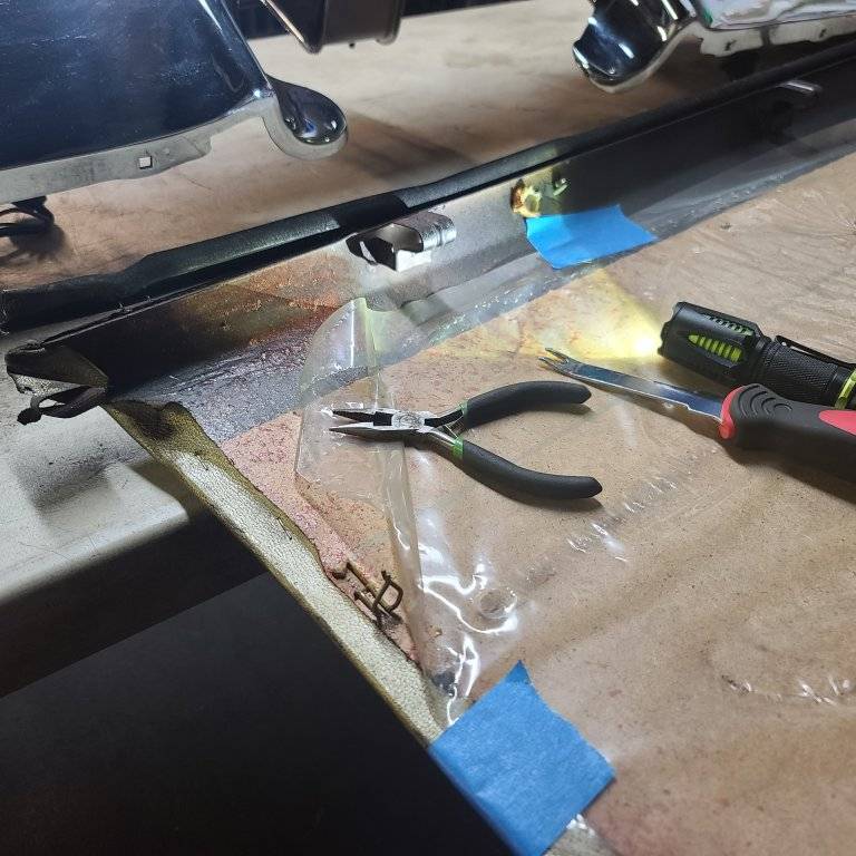

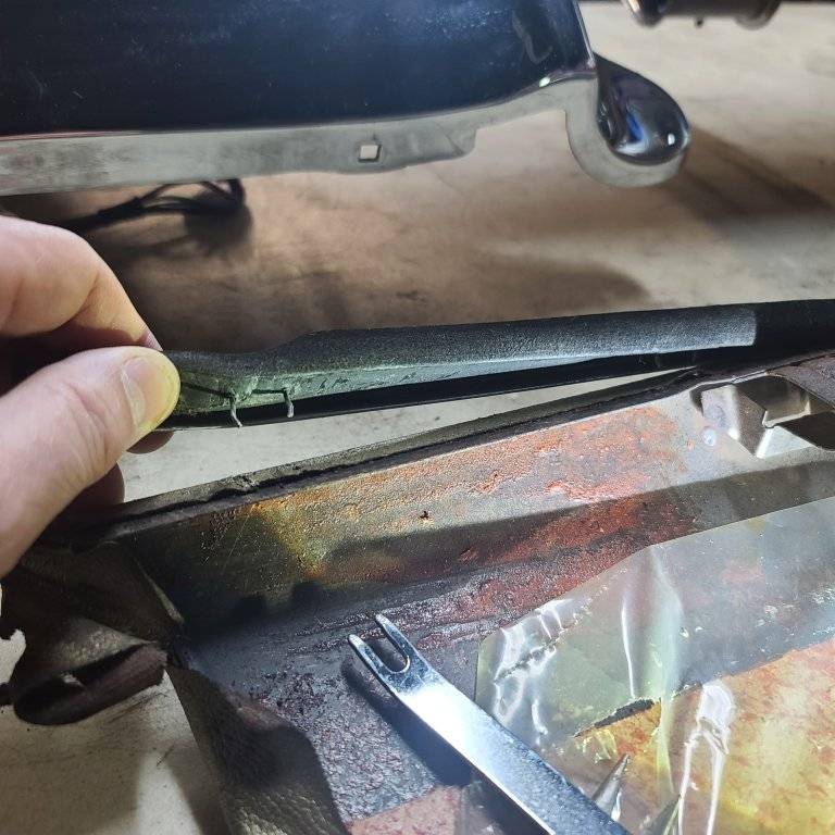

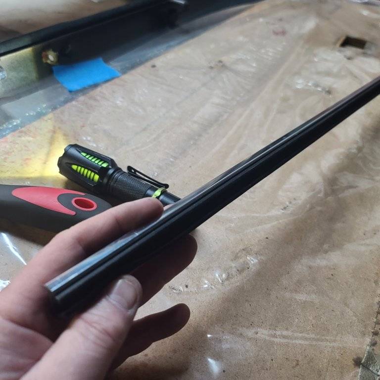

Last year I purchased new cat whiskers for the NYer through Van’s Auto and started to remove the factory OEM piece that is attached to the door panel today.
Thought I'd share what I ran into when beginning the replacement on these parts.

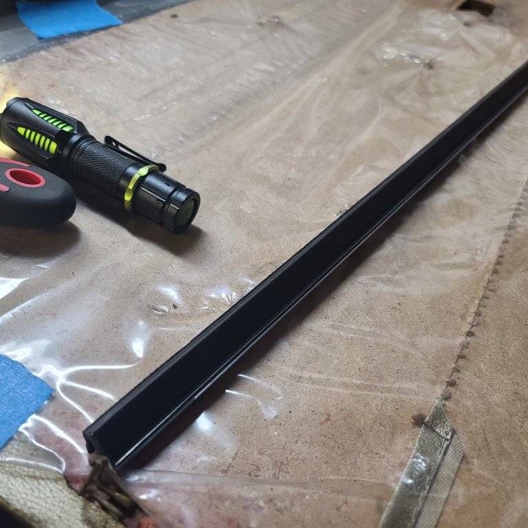

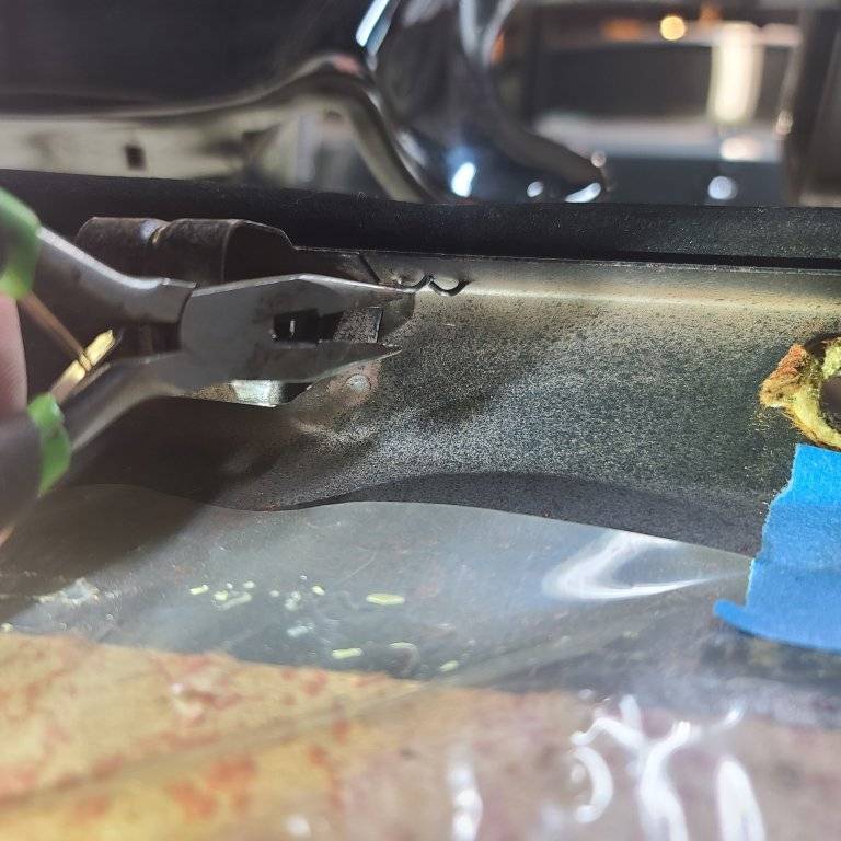

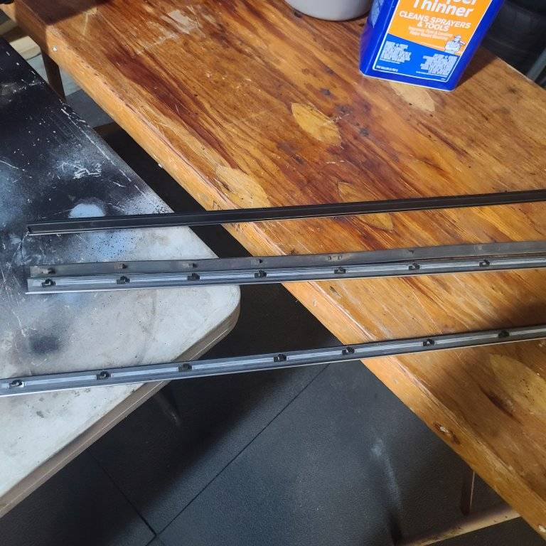

When beginning to remove the old one I noticed there is a slight difference between the old parts & new whiskers produced by Top Catwhiskers. The original OEM part is affixed to the door panel with metal tabs, whereas the re-pop part does not have the tabs to secure the part to the door panel.

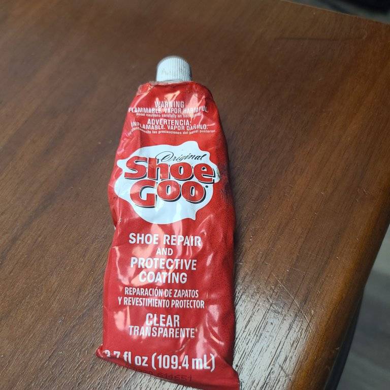

I’ve had luck using the product Shoe Goo in the past because of its adhesiveness and durability and will most likely go this route to secure the new cat whiskers to both door panels.
BTW, the cat whiskers that get attached directly to the door, as seen in the pic, are secured with built in tabs that match the same locations as the OEM part. Should also mention, when putting the new whiskers with the clips onto the doors, be sure to use correct whisker as there is one used for the Left side and the other for the Right side.

There aren't any makings on the re-pop whiskers, but as seen from this picture, they are different.
(these two are the ones that go on the door panel)
FYI - For cat whiskers window trim I used pop rivets at the same locations as the metal staples.

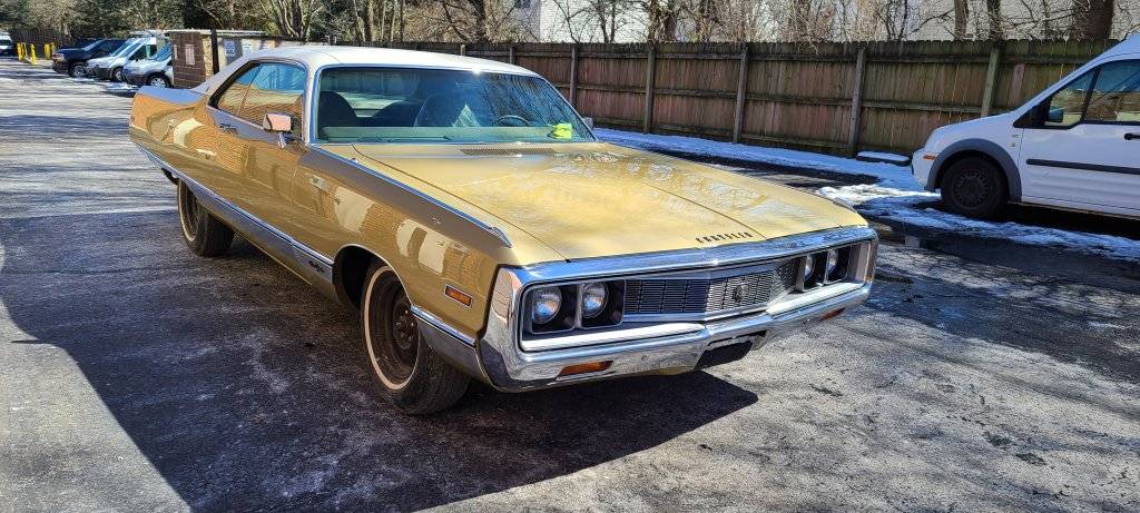

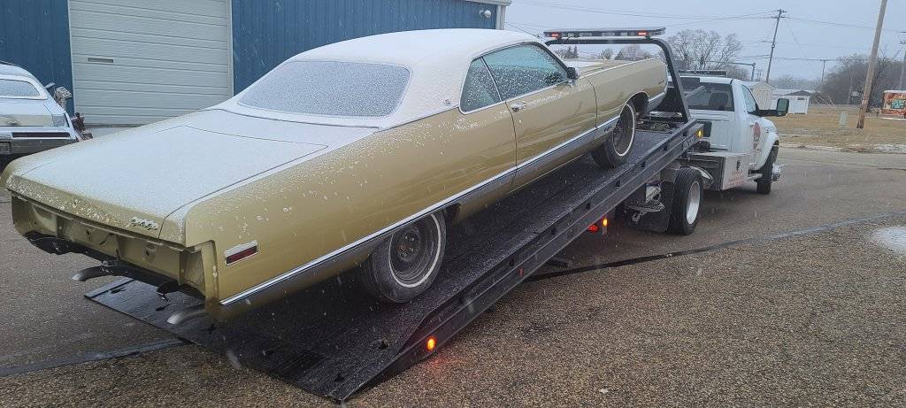

After almost 13 months being away to have the 71 NYer's bodywork and paint done, the car has finally made it back to the stable where it'll get put back together.

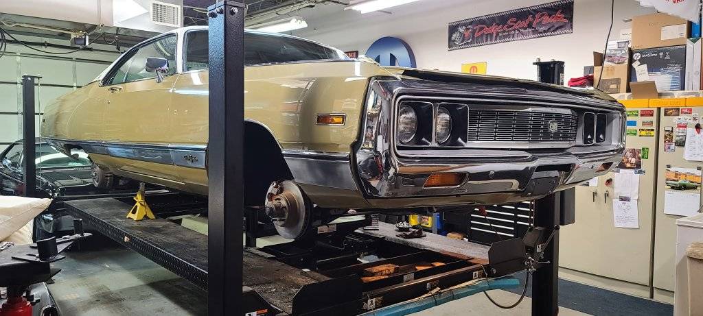

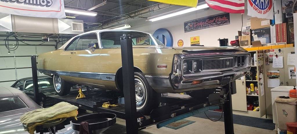

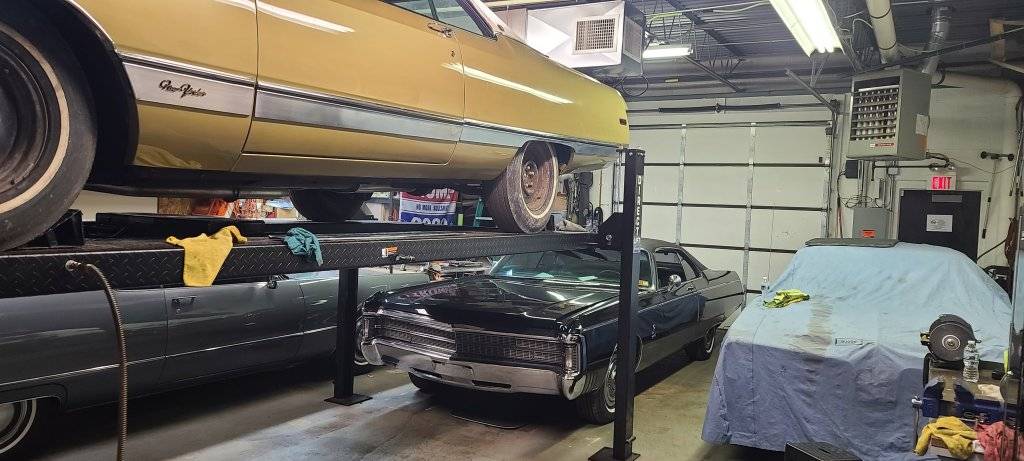

Today I'll be checking the brakes to try to pinpoint why my brake light on the dash is staying on. Maybe form sitting for so long, who knows?
So, it's up on the hoist until it's figured out.
These results were worth the waiting for. Premo quality body and paint work. The trim looks like new. Congrats Tim, can't wait to see it in person.
Tim, are you overall happy with the result? When the trim was off the car, did the shop remove the tiny posts that hold the trim clips on so they could use a long board to get the body sides straight or was the sheet metal so nice in the first place that a minimum of longboard use was even necessary?
Who did you end up using for the proper paint color/fine metallic match of the original crystal dawn metallic and was it actually right on or ??? I think I recall you said this was a basecoat, clearcoat car and who was the paint supplier (brand)?

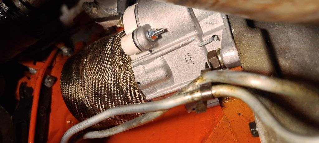

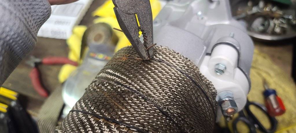

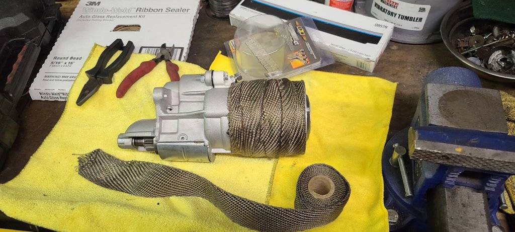

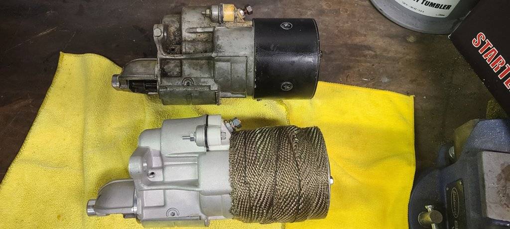

The last couple times I went to start the NYer, the 50-year-old original starter was starting to crap out, so I decided to get a new one from Summit.
Before installation and knowing the proximity where it will be to the exhaust pipe and using the OEM style compared to a mini starter, I thought it'd be a good idea to wrap the starter to prevent any heat-soak that may occur. I thought of doing this because I did the same thing on my R/T, and it has never given me a problem or any issue with restarting the car after it has been driven for a while, reaching full temperature.
To keep the wrap in place, it's best to use 18-gauge metal wire. There are metal straps that can be purchased to secure it in place too.

Now comes the fun part....
I'm scratching my head why the new starter is bigger than the old one.
In either case, it fits and easily turns over the engine.

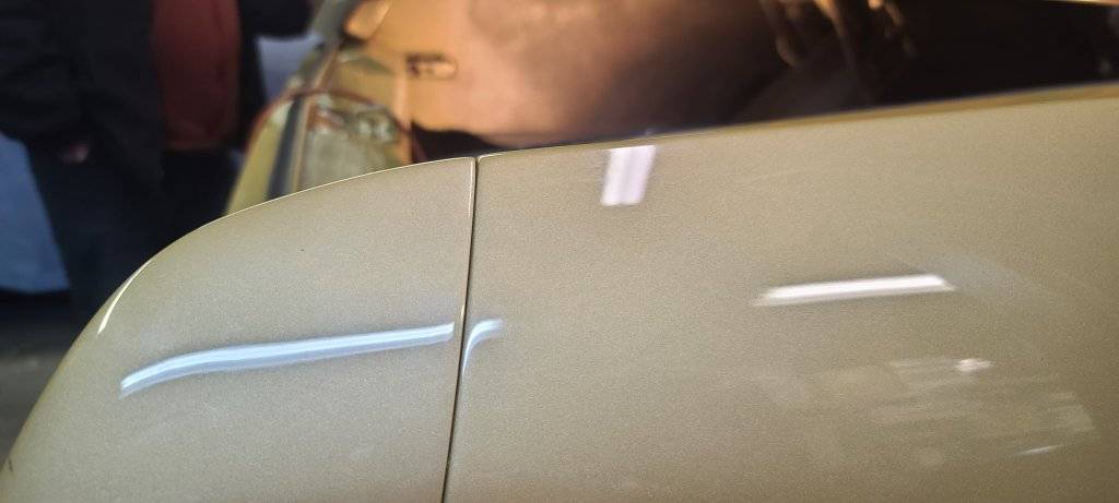

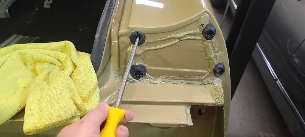

The pinstripes still need to go back onto the car, and I've got a guy lined up for that.

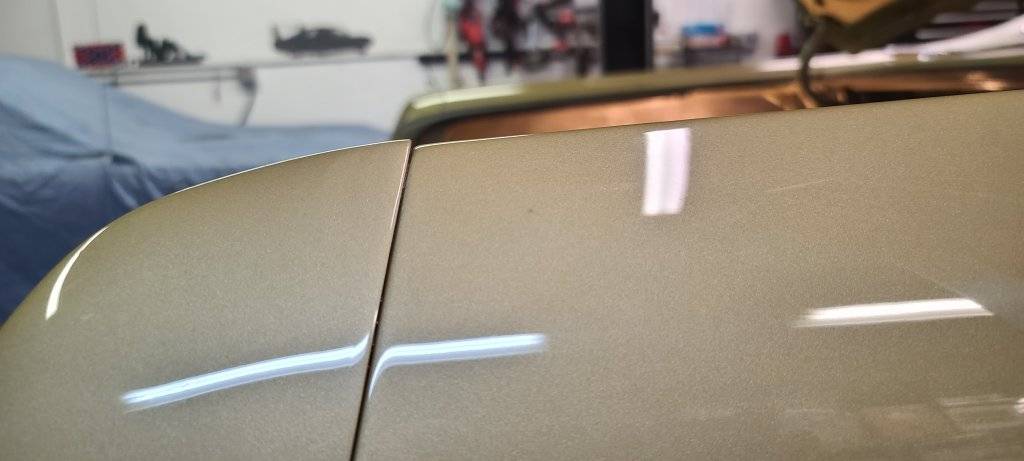

But before the car gets the pinstripes, the endcaps needed to be lined up properly.

There is a heavy duty starter available that was used the Hemi, med. duty trucks and BB cars. My guess is the starter had been replaced w/ the smaller starter at some point. The small starters didn't last long in BB Block applications. I had heavy duty starters in my 69 Charger 500 and Sports Fury GT, I had no starter problems w/ them.
