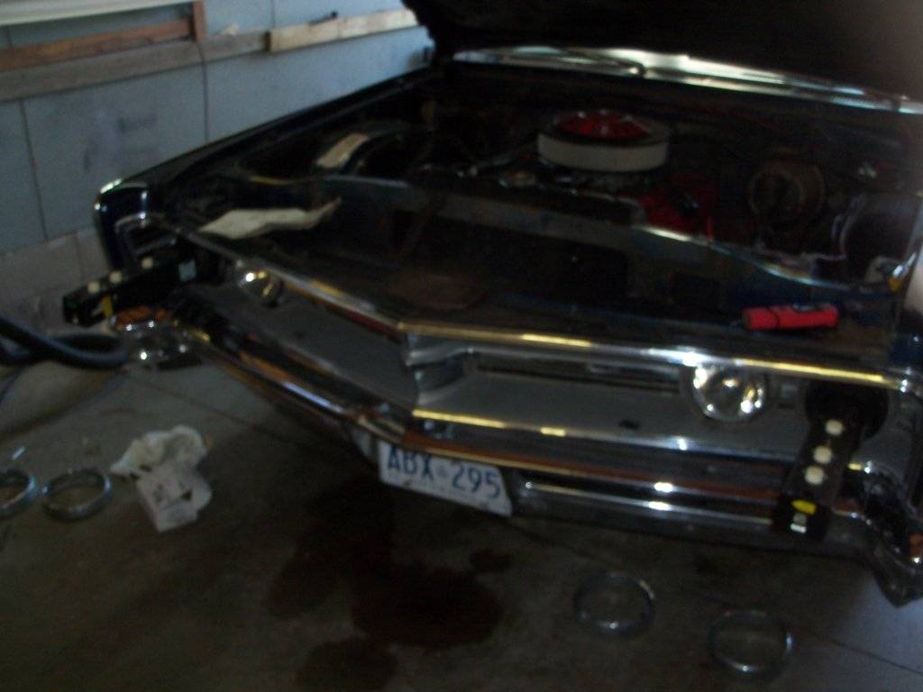

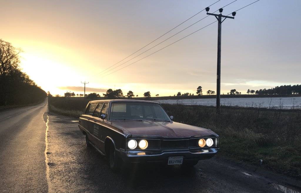

Success! Many thanks to everyone for their advice which has lead to me solving my ongoing lighting problems and a special thank you to cbarge who answered all my PMs and even sent me the hard to find headlight toggle switch all the way over to here in Scotland.
I cleaned earths, & took time to clean all the bulkhead connectors, fitted a very cheap H4 relay kit from eBay and at last night driving is possible, even the instruments are now brighter and a bit more accurate.
I’m now able to drive at night now without being plunged into total darkness when switching to high beam on our twisty, narrow Scottish Borders roads.
What a great community this is & I hope I may be of as much help in the future as you guys have been to me.
