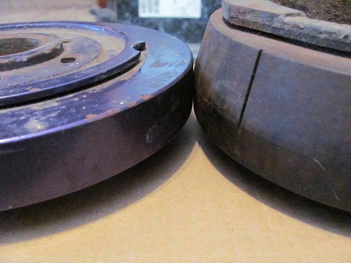

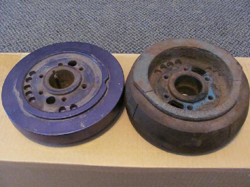

The purple harmonic balancer / dampner is the older internal balanced forged steel version.
The thick balancer is the later externally balanced cast crank version and the engine attached to it absolutely needs the proper weighted converter or drilled flywheel.

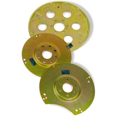

Anyway, I found this as another option so you can use your original converter, if you put an externally balanced engine in your Chrysler.
B&M #10237 - Externally balanced B & RB - About $80
I still think once you've determined what engine you have, that you should contact Precision, as a new converter may not be as expensive as you may think.
