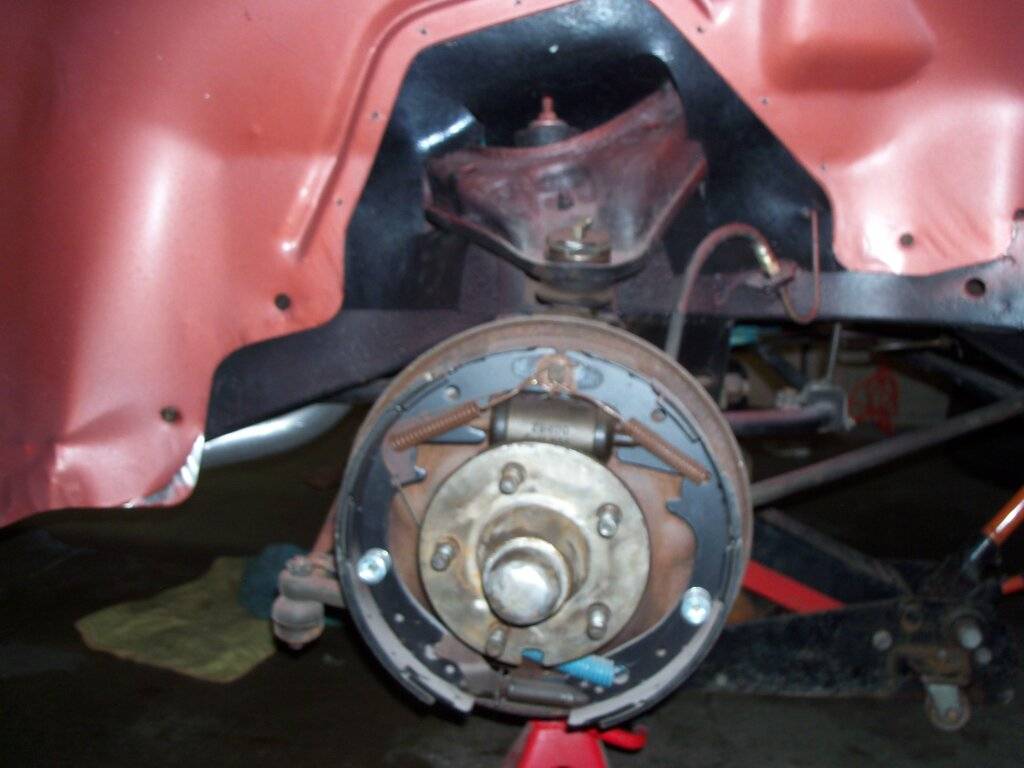

    If you have drums on the front, the "by the book" way of replacing the front studs is to have it done by a machine shop. They are swaged to the drums and there is a special cutter that removes the swage and then they are supposed to be reswaged when done.
    If you want to try, you may be able to remove the studs yourself, being careful to support the hub real well while pressing out the studs. Without reswaging, you would be able to remove the drum without removing the hub. GM vehicles were mostly this way from the factory, so not sure if it's really necessary to reswage the drums.

    On my car, I grinded out the swage.
    Then knocked the hub away from the drum and knocked out the studs.
    I did not have a press so I used a mallet and punch to set the stud and extra cheap chrome lug nuts with an impact gun to pull the studs back into the hub.
    I did not swage the new studs which as mentioned makes brake adjustments easy with sliding the drum on/off.
    Order Raybestos studs. The Dorman ones are not so good.

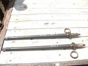

    Un;ess somebody here has done otherwise,correct me if I am wrong;
    To really get rid of the keyed rear drums/axles you have to swap out to a 1965-newer complete rear and matching drums.

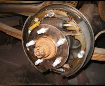

    I probably should elaborate.
    Knock the studs in (probably can't anyway) and you won't be able to pull the drum off.
    The studs are pressed into the hub that is part of the drum. You need the studs to attach the puller to for one thing.
    This is what the axle shaft looks like in your car. Note that there is no flange for the wheel studs.
    Compared to a later axle shaft with a flange and wheel studs pressed in.
    This is what your brake drum looks like. Similar to the front where the hub is part of the drum
    A newer style brake drum.

    Well, the answer is still no.
    You can do that once you get it all apart. The hub is still in the drum, held in by the swedged studs and the light press fit into the center. I've done the same thing on front drums, basically making them slip over the hub so they can be removed without taking the front bearing apart. I made a cutter to trim the swedged studs away from the old drum and then knocked the whole thing apart. IIRC, I opened up the lug holes a tad on a new drum so it slipped over the existing studs and the center hole was perfect size. Just had to clean up the hub a bit to make it slide together.
    It's all good... But you gotta get it off the car first.
    I don't see why you want to not pull it apart first. Yea, it takes a puller and sometimes it's a little stubborn, but they come apart.
