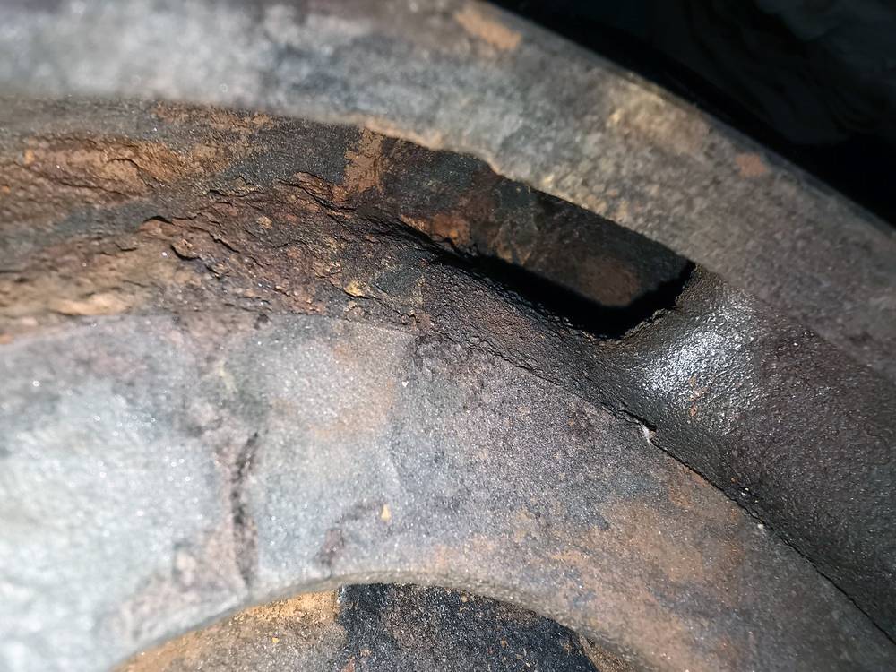

I don't care about the weight, no. My original housing (which I would prefer) is heavily corroded, especially around the in- and outlet. That's why I bought another one. The aluminum one I have now is simply one I found here in Germany for a good price.

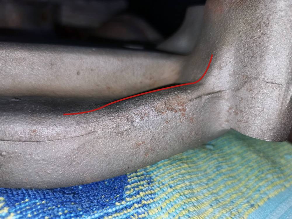

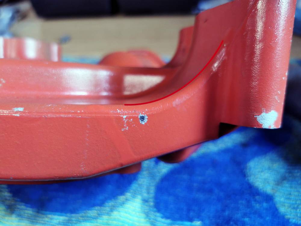

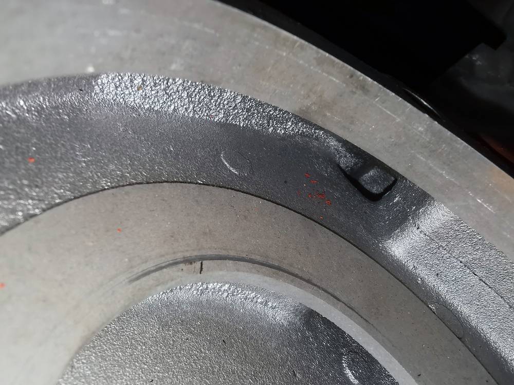

I've put the original and the aluminum pump housing next to each other.
They are mostly identical except one outlet.
The big question is now if the extra space is needed there?!
