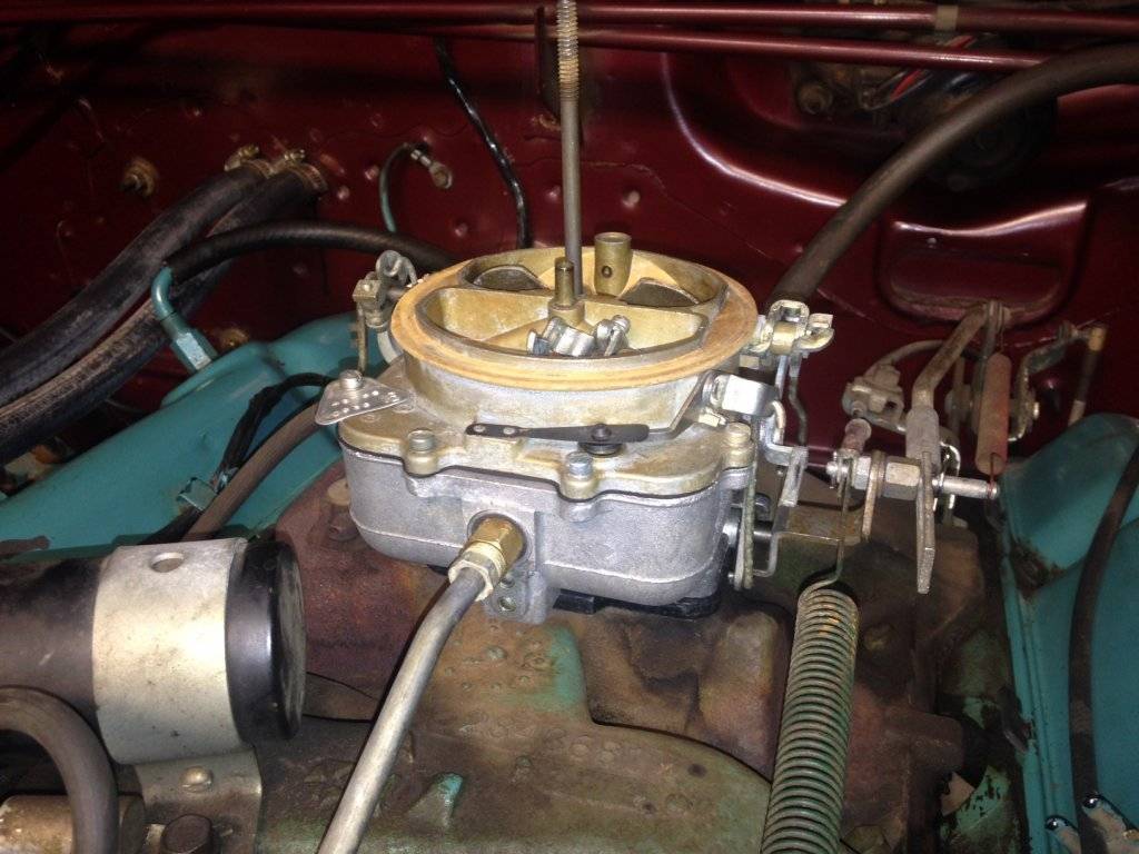

Update: I've dropped the oil that had the Seafoam in it. Put over 100 miles on the car with that in the oil. I'm rebuilding carb. right now...bought plugs, points and condenser too as I had similar hesitation/stumbling on my DeSoto from a bad condenser. I have all plugs out now...so I've repeated compression readings on the three low cylinders. 2 of the three low readings came up ten. However, on the lowest reading...(cylinder one) it dropped further from 85 to 60. I decided to add oil to that cylinder and repeat the wet test...This time it jumped way up to 100. I'm not sure why it didn't jump up that high the first time I did it. Shows that it's always important to repeat tests. So now, I'm thinking way different. Perhaps it's a carboned up ring(s) from sitting too long? And the other symptoms: rough idle/hesitation may not be related at all?...unless there are valve problems as well. While oil is out, I've also sprayed a super penetrating oil (an old mechanic friend gave it to me and recommended I do so - I forget what brand right now) in spark plug hole of cylinder # 1 and left it to soak. Plan: let it sit while I rebuild carb. put it all back together with new plugs, points, condenser. Add 4 quarts of 10w-40 and 1 quart of Lucas Heavy Duty Oil Stabilizer and see what happens. I hope to have a smooth idle, no hesitation and a carb. in which I can adjust the fuel/air screw properly. And eventually...a compression reading in cylinder # 1 that slowly rises into spec. :wideyed:
Bob
Well...I have a much smoother idle and no hesitation now. :thumbsup: I am relieved with some caution but now it's time to drive it. Although the carb. is rebuilt now, the single air/fuel mixture screw in back still does not make any sense. Screwing it all the way in does not choke off engine idle. Engine runs the best when it's screwed all the way in. I noticed in the rebuild directions there is a procedure to drill out the two plugs down in front, although there are no springs and screws in the kit. This is where I'm use to adjusting fuel/air mixtures. Initially, I was surprised to see those holes plugged with no adjustment screws in there. Anyone have any insight on this?
Bob
These cars can suffer from lack of use.
from what ive seen , those adjusto holes are there, and filled in with lead. i had the single screw carb (likely original) and ditched it for a reman uremco 5-599 from summit before i/us/we/this site got to mess with it. i dont think i even have any pics of it, it was one of the first things to go :/
on the carb i was messing with, the butterfly valve would not lower down far enough to cover up the idle holes and was always in the 'main' and never in the 'idle' circuit.
the car is in too good of condition i wouldnt worry about the motor overall id drive the hell out of it. i still maintain my earlier post its the carb :)
order a carb from summit today, bolt it on tomorrow, and shelf the one you have now.

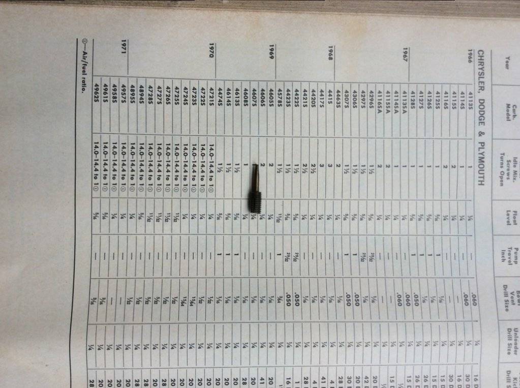

Not knowing your carburetor # your engine has you may have one from a newer year model. The type of carburetor you are discribing sounds like one from 69-70 ish. If you look through a service manual up until 69 or so the idle screw mixture is in turns of the screw then after that the idle mixture is in air to fuel ratio 14 to 1. Later Carter AVS carburetor so did the same thing. When you have time, remove your carburetor turn it over and look to see if you can see the tip of an adjustment needle in line with the plugs you instructions said to remove. What I think you will find is a needle screw like in the picture. The single large screw is an air adjustment screw so when you screw it out you are leaning out your idle mixture. If see the tip of a mixture screw remove the plugs use a small screwdrive set your mixture as normal, do this with the air mixture screw out about 1 turn or so.
Hope this helps.
Thanks Saylor...interesting info. on the carb. So Summit has a replacement huh? I'll look into it. I prefer to keep this survivor car original, but main priority is that it runs well. Can I use the same air cleaner? I know Auto Zone has a direct replacement Carter rebuild too. Now, I'm wondering if they have the plugs drilled out and adjustment screws in place.
I have another thought too...If I was going to put a few hundred dollars towards it, it might be nice to find a 4 barrel intake and upgrade to a 4 barrel carb. instead. Does anyone know if a factory air cleaner can be used with a modern off the shelf 4 barrel? I will not put a round chrome air cleaner on this car.
66Newyorker...I do not believe there are screws under those plugs but I'll look. I think Saylor is right...there's lead plugs in there and no screws. Should have looked closer when I had it out to rebuild.
Thanks to everyone...Bob
View attachment 78947 View attachment 78948
Without specific familiarity with that carb, I would think there had to be screws under the plugs... but you're right, the rebuild would have been the time to figure it out. I vote you enjoy her a while before getting too crazy. The only real benefit I see to a 4bbl is if you want to get a nice easy to live with Eddy carb and intake... IMO the "upgrade" would be about a new carb with easy adjustability, not so much a performance gain... properly sized, you may pick up a MPG or 2.
I wouldn't modify a car as original as that at all.
the uremco 5-599 from summit is a bolt on replacement for sure, I did it myself on a stock 1968 383/2, so for sure. the single snorkel air cleaner will fit right on no problem. all the linkage and kickdown and whatnot are all in the correct positions, etc. I did a manual choke and rigged up a pull cable into the cabin.
I got to go with horvaths on this, I wouldn't modify a car this close to original. but the 5-599 is the current 'oem' replacement im pretty sure. id eat the core charge and shelf your original, and bolt on the reman. maybe if you found the proper iron 4bbl intake or the mopar performance / edelbrock copy and like that, at least its still true to what you could have got from mopar... but I would for sure get the reman 5-599 at minimum so you can drive this beast.
