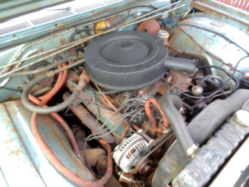

Aside from displacement, what are the differences between the two? Any downsides to the 413, if that's what it ends up being? Is there a way to tell by looking at a photo to tell which engine it is and if not, can someone please tell me where to find the number on the engine? Haven't come across that info in the manual yet, or I missed it.
Photo attached.

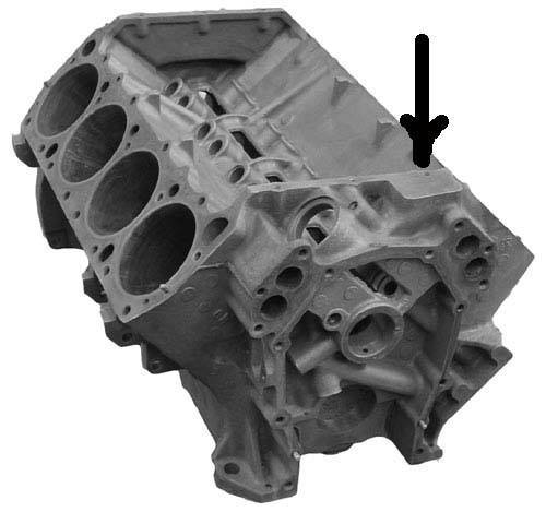

I stand to be corrected but in front of the intake on the drivers side if there is a rounded rectangular cast tab that is machined on top you will have a 413 (or 440). Other way is just look up the casting # which should be just above the oil pan on the block.
Sorry, what year of car are you referring to? 66-69 G is 383 2bbl .413 was gone by 66. Do you mean 361? which is an F code that year. The single master cylinder appears to be 66 or older, though.

This is the ID pad that is to the right of the distributor on an RB (413/440). B block (383) does not have this.

Sorry about that, it's a 1966 300. And I had thought the options were 383 or 440 as well, which is why the manual threw me. If you have the 1966 Chrysler/Imperial service manual, right at the beginning on page 4 is the information for 1966 models. It lists F as 383 and G as 413, which got my attention. I've had some exposure to the 383 - never seen a 413.

Look for the pad as shown in 300rag's post. They are hard to see. Quick check for 383 B block (or 361, or 400) is that the pad is on the passenger side under the alternator. RB block pad 413, 426, & 440s have the pad under the A/C compressor on the driver side. It was my understanding too that for Chrysler dropped 413's after 65 and in 66 it was 383's and 440's. Then again a 66 I'm working on has fender tag color code MM for Turbine Bronze supposedly a 67 and up only color. Turned out it was a spring 66 only special offering as well.

Here's a couple pics to helps locate the identification pads as mentioned above
383-
413/440-
