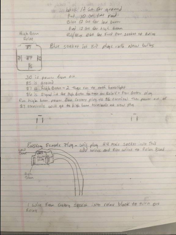

I have attached a wiring diagram of my own that I made when I installed my kit.

Your option has been here for awhile - the aftermarket relay harness kit, $20-30 at Summitracing and other places. You don't have to modify your factory wiring at all. You install the harness as a stand-alone, and run its 2 trigger wires into a high-low headlight connector, and shrink-wrap that connection as you see fit. I used to make these things myself years ago, spent 2-3 hours routing, cutting, terminating, looming, but no more. I've used several kits from different vendors and all worked A1 for me.
Also - adding relays, if done properly, reduces the load thru your headlight switch. It cuts the load on your headlight switch circuit down to ~1/2 amp to trigger the relay, and whatever amps your lights formerly pulled thru the bulkhead and ammeter are eliminated too, of course.

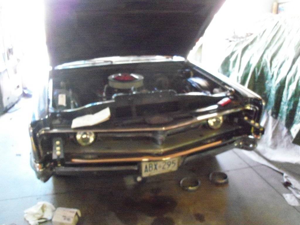

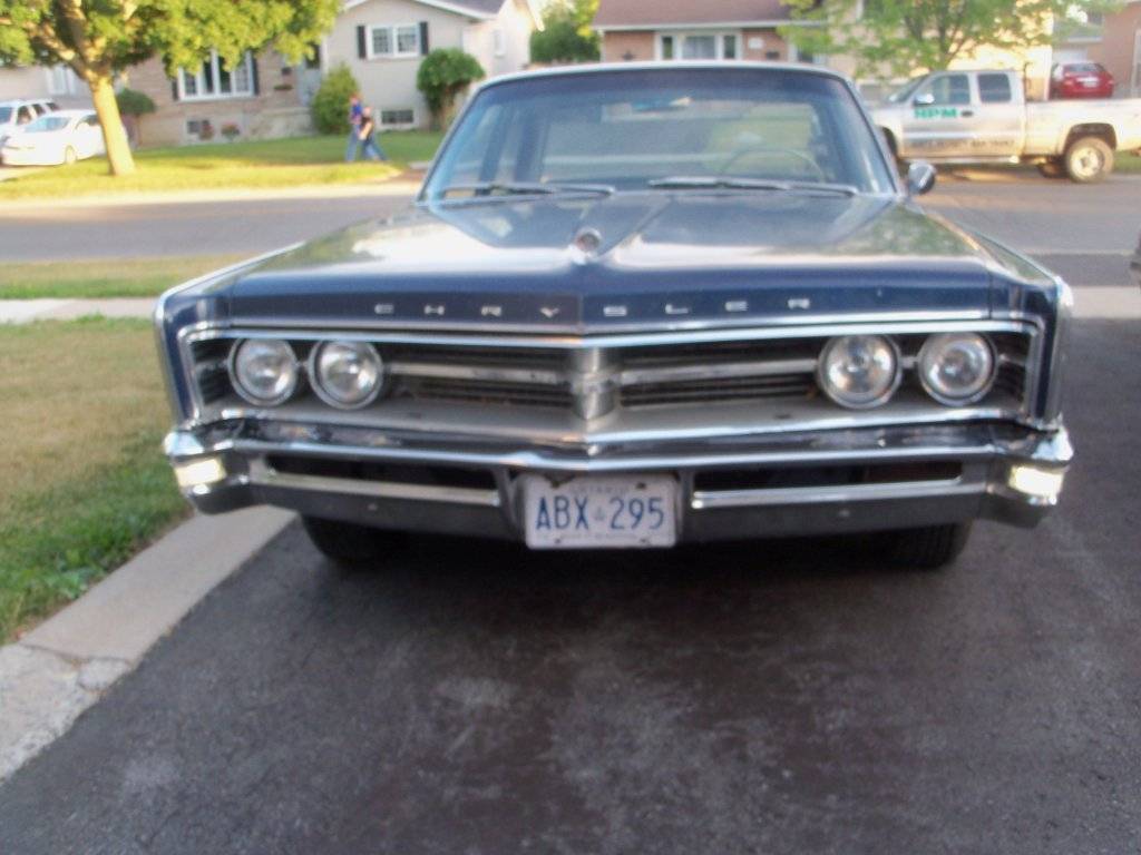

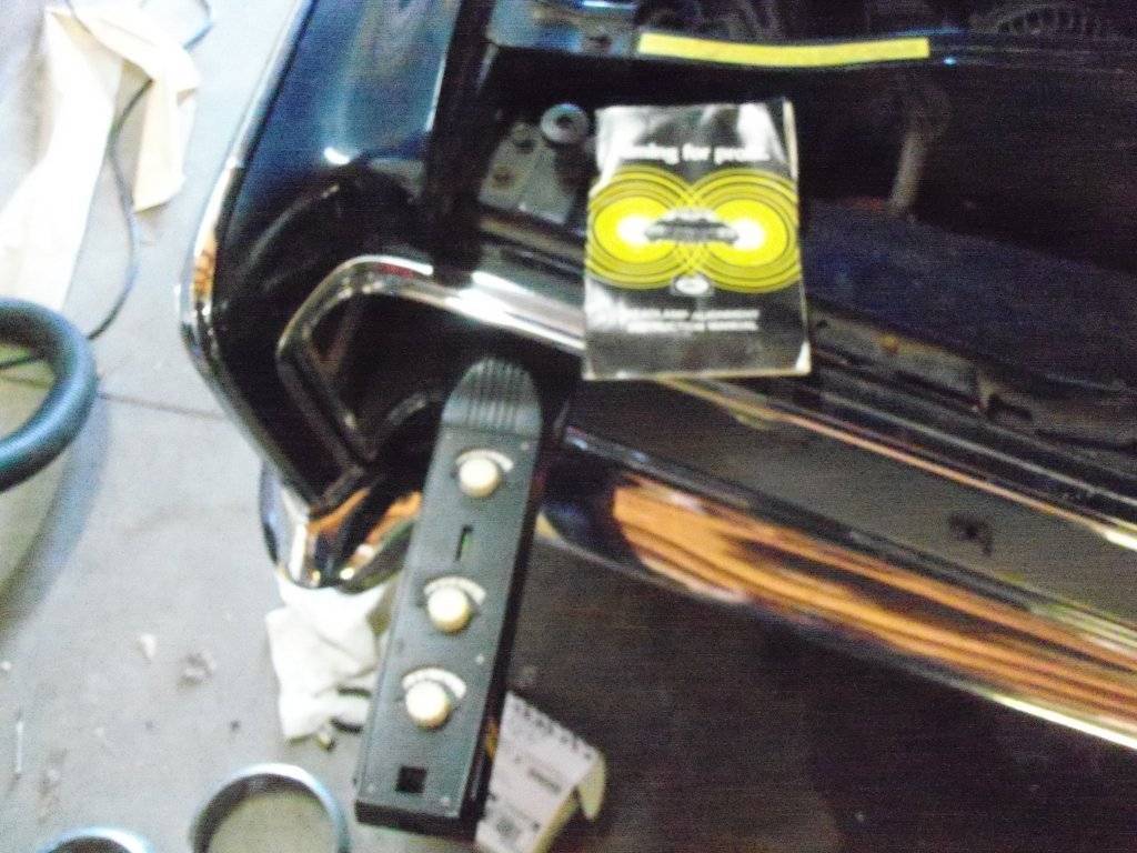

No matter "watt" lighting system you choose---HID,LED or Halogen bulbs,they are NFG without aiming the lights after any conversion.
On the 300,I use a Putco wire harness with Hella H4 housings with PIAA halogen bulbs.
After Aiming the lights,they throw the light much better.
The wagon has HID's and are my favourite.
