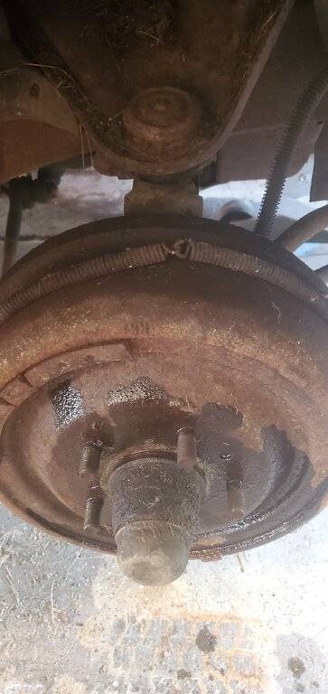

That is original and its purpose is to eliminate any noise when braking.What in the world?? Never seen a spring wrapped around the drum...ha!!! 1st for me...
Yes, vibration dampning I believeThat is original and its purpose is to eliminate any noise when braking.

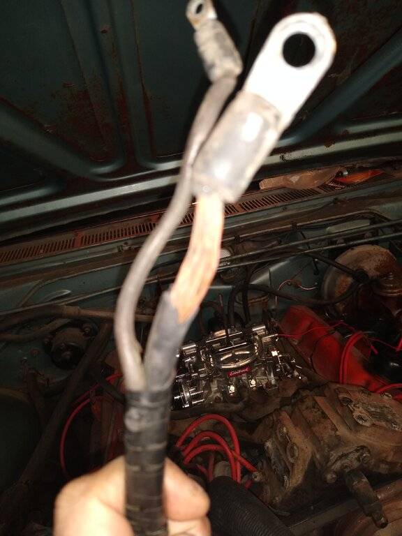

Another thing to check, inspect battery cable by starter. I saw a crack in the insulation, turned out it was all corroded and insulation fell off on my 65
I scored years ago NOS drums but had to search for the spring dampeners.What in the world?? Never seen a spring wrapped around the drum...ha!!! 1st for me...
65 Battery cable is one year only in black. 66 and newer went red.Another thing to check, inspect battery cable by starter. I saw a crack in the insulation, turned out it was all corroded and insulation fell off on my 65
