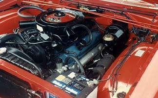

What color should it be? I think it was light blue or something like that. Definitely not red like in the brochure.

All the big block B and RB engines were turquoise until '69 when the HP 383s and HP 440s went to Hemi orange.

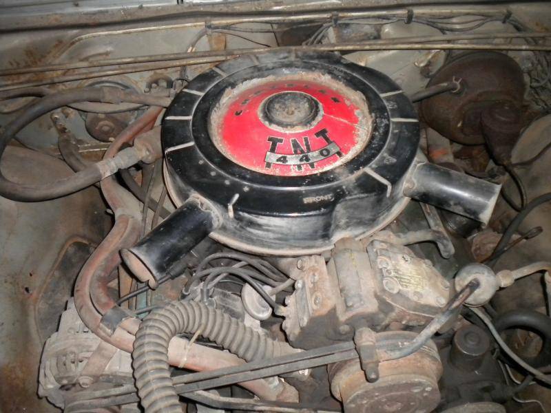

I think there may have been a TNT package for '66,it consisted of a dual snorkel air cleaner & dual exhaust,360 horsepower.

Yes the TNT existed in 66 and that's what the pie tin decal looked like. Internals/ exhaust manifolds were the same. In the Imperial it was claimed to put out 360 hp vice 350hp in a single snorkel, single exhaust set up. I'm not positive on Chrysler claims for it.

I've done some homework now and found out that there was indeed a 1966 TNT package. It included factory dual exhaust (not standard from the factory on the 'normal' 440) and a dual snorkel air cleaner just like the picture shown.
Chrysler started in '67 with a different cam for the TNT package, so my '66 engine is just a 'normal' 440. It's a pity that I don't have the original air cleaner anymore, one of the previous owners has taken it off. This is a very special '66 only air cleaner with round snorkels like you can see in the pic.
I have also started the same thread on the drydock forum, and they are still not sure which color it should be. I've collected some pictures of 1966 440 TNTs (found out that they are rare), and all the engines are painted turquoise.
