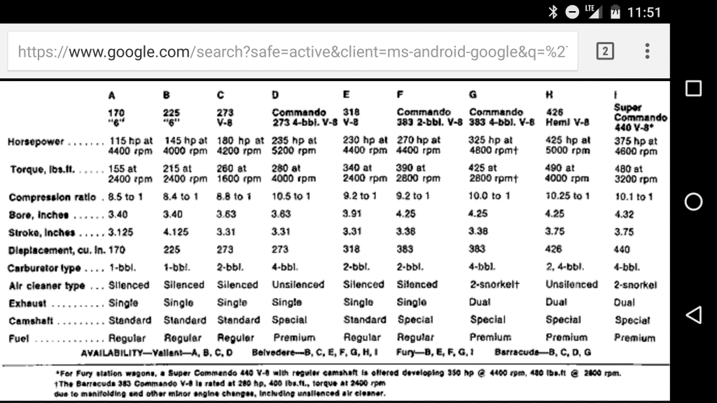

This is the '66 Plymouth engine chart. A standard 440 is available for Fury Wagon, with less compression and different cam, similar to the 383 2vs4 barrel. So yes, it was possible to get a 440 non-HP in '66.

Remember, in '66 there was no additional 440 "HP" 375 horse variant. That didn't come on the scene until '67. The '66 365 horse TNT was the 'high performance' engine. http://www.hamtramck-historical.com.../1966/66_Chrysler_Features_Equipment_0019.jpg
This would be the optional engine for the '66 300.
A 22" radiator would be standard without High Altitude or A/C.
I can't speak to the exhaust.
Terms changed year to year.
Thanks a lot for finding that chart. Looks like a 300 with the same 440 engine that was available in a New Yorker was also available in the 300. I would bet the cam and maybe the valve springs are different in that motor, but the compression ratio was probably the same as the TNT and the 383 four barrel engines.
The chart is not correct for '66. The 375 horse 440 did not appear until '67
Hmmm. You're right. I thought that was the right one for '66 too. I think I have it in the flesh somewhere. I'll see if I can find it.
