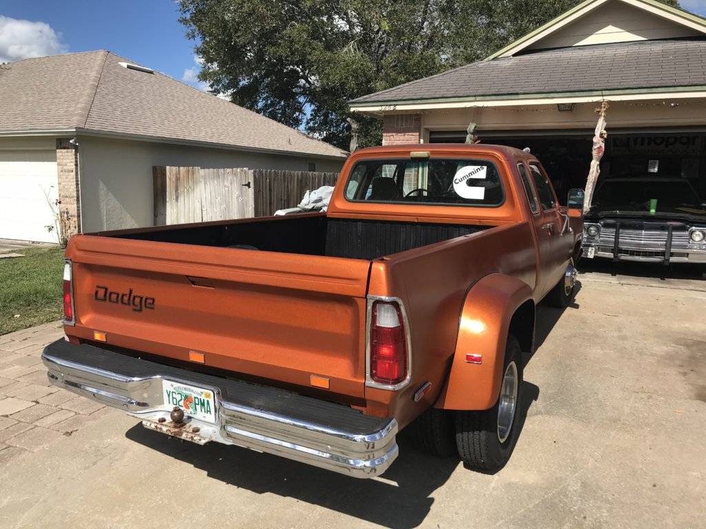

I introduce to you all, Mayble the ‘78 D300 with a 12 valve lol.
Please excuse the roofers compressor next door. I also forgot to tilt the phone. My bad! But she’s alive!

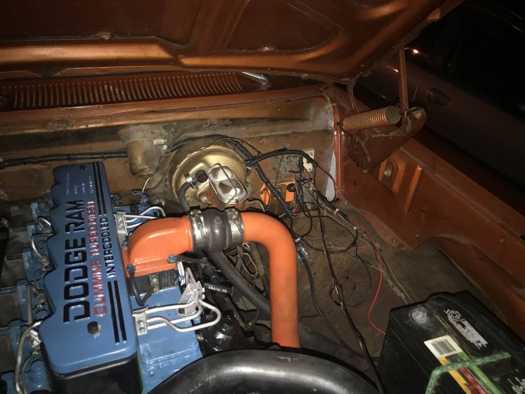

Obviously still have some stuff to finish up. I had the coil wire for the 12volts to the pump, but mysteriously the wire is not getting any power now. Just have a jumper wire to the battery for now.
I goofed up, and toasted the starter relay. The starter wire got bent, and grounded itself out on the starter body. Got a new relay installed, and fixed the wire.

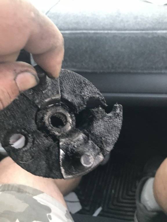

Oil got the best of that rag joint, awesome that it's moving under it's own power.

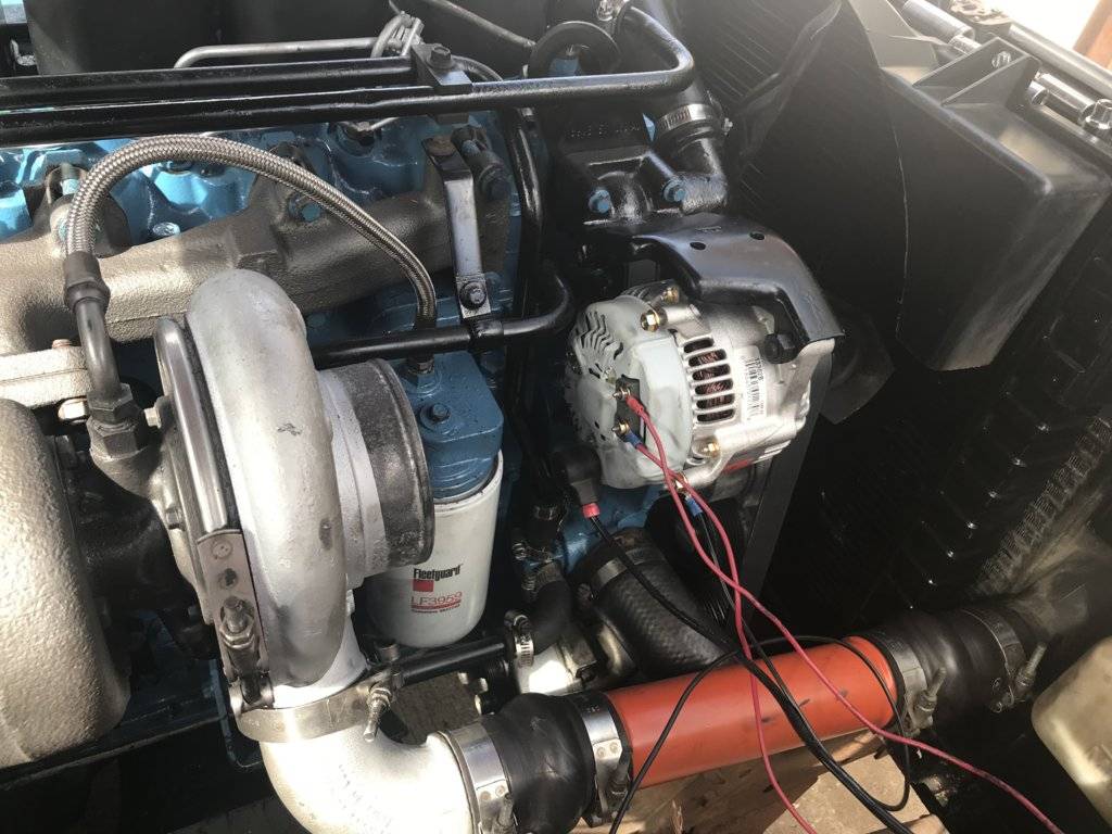

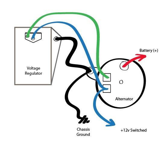

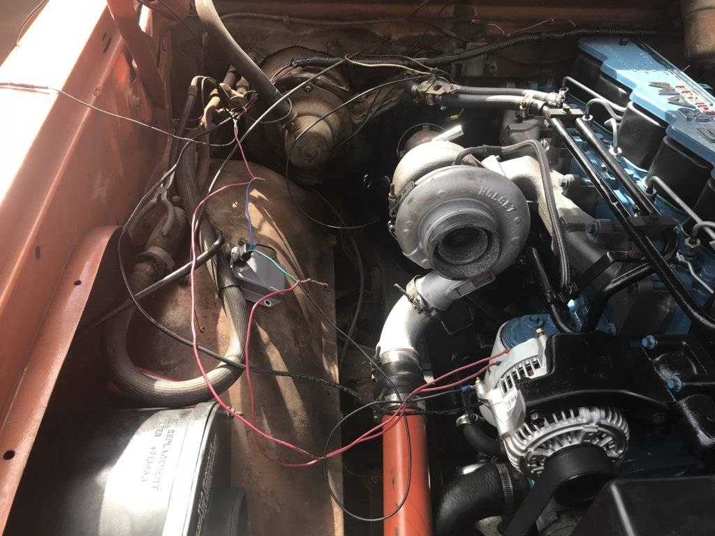

doing good kid !Been fighting the angry ***** all weekend lol. Spent a whole day and a half just trying to get her to charge. 3 alternators, and 3 regulators later she is finally charging!
Did get the wiring cleaned up, and looking better. No glamor shots yet though.

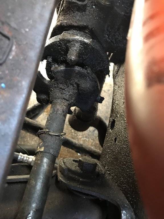

Also got the overdrive wired up with a switch. Huge difference this made! Played with the tv cable some more. My cummins buddy, and I installed a bolt, and nut on the tv cable end, to move it a little more forward, and act as a bump stop. The adjustment for the cable was already maxed out. Seems to be a common problem when you install the governor spring I’ve got in it, from what I’ve read.
