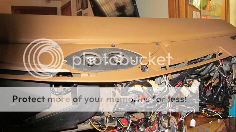

Take pics of the wiring routing and plug locations. It will help with reassembly. I like to tag the harnesses too.

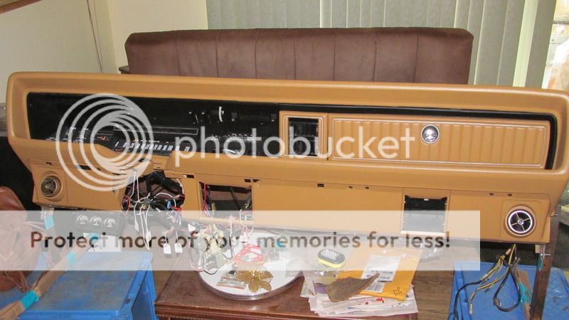

Having a helper is great, but I took mine out by myself. You will need a helper to put the dash back in.

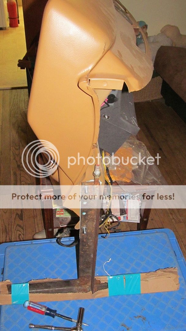

I also suggest you make some sort of stand for the dash. It makes things much easier. I made a set from old bed frame.
This was a winter project, so it had a lot of detail done in the house.
Note the tags for wiring.
Stands in use on 53 Windsor dash.

So much easier with the harness on the dash.
